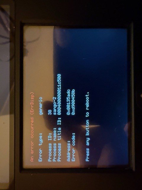

Hi skawo or anyone else who knows about this..
I used the most recent version (1.4) to try and restore my copy of Pokemon Alpha Sapphire.
Before using the tool I after opening the game I got the 3DS loading screen and then the 'An error occurred' message.
I ran the tool 4 times and verified after each run and got the message verification failed.
If I run the Restore tool now I immediately get an error which says that restoring failed.
However, if I boot the game now I'm able to get past the loading screen and I can start the game and walk around for maybe 15 seconds before I get an error.
The error I get now is attached to this post.
Does this mean the cartridge is unsavable or are there still any options I might not know about?
Thanks a lot for creating the tool and providing any insight..

Huh, so the restore function itself immediately errors out (not verify)?
That's odd... that indicates some kind of connection issue, I think? Try cleaning the cartridge first and trying again?
Yes that's correct.
I'll try again tonight and record the process / provide pictures of the errors it gives.
I'll also run the 100 Times versions as well and update you.
Thanks a lot for the response (and tool in general of course!).

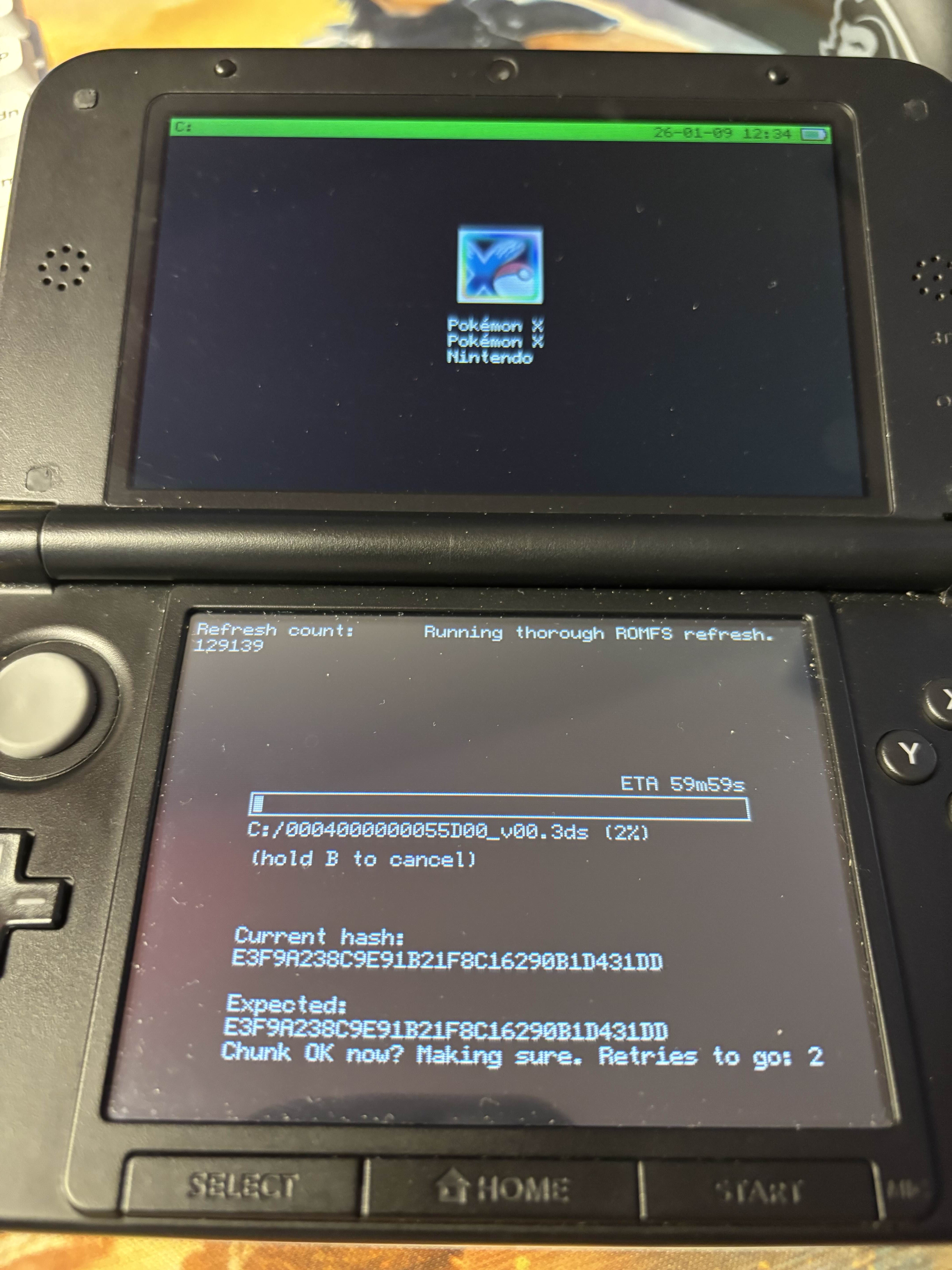

@skawo Thanks a million for sharing.
As the tool might seemingly be running for a very long time on some cartridges, it’d be nice to have the option to auto-turn off the displays after a while in order to prevent burn in.
I am trying to fix a cartridge and the tool has been running for 12 hours with only 2% of the progress bar full. “Current” and “Expected” hashes keep changing so, as per the readme, I assume it is still doing its thing.

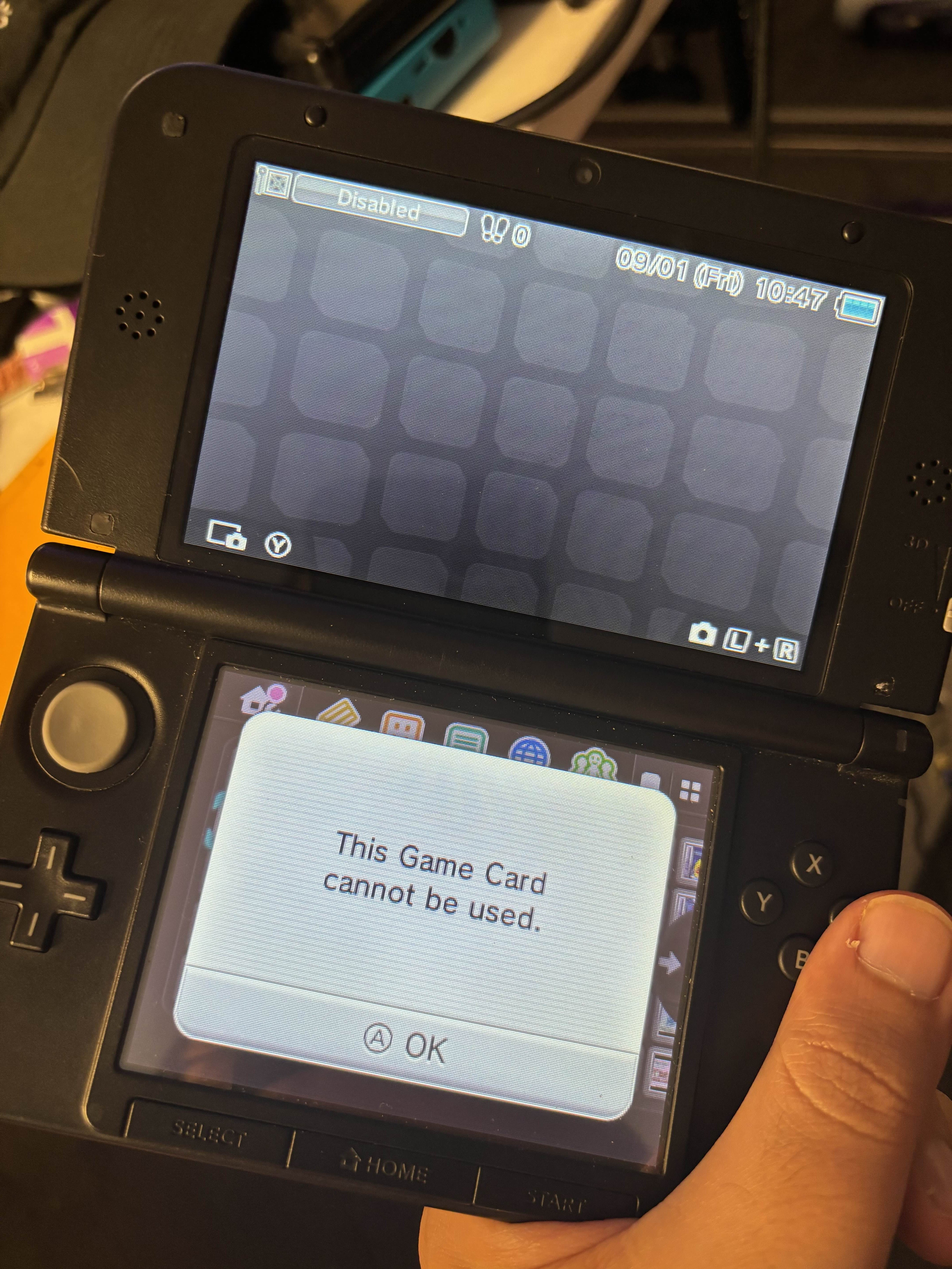

Hi there I just got for the first time a used 3DS game that was giving me this error even tho I have custom firmware It would give me this error on 2 different devices ( never had a problem with games before). This tool seems helpful but i have reached like crazy number of refreshes. Should I have any expectations this in the end will work ? its been 2 hours and its still 20% some get really stuck on the refreshes.
Good thing it's ebay I can just return it

Seems normal. It can take a very long time depending on the amount of corruption. If it has progressed to the ROMFS it should at least launch now, I think.

Thank you so much for first creating this tool, without this I would just return the game back. I don't mind waiting at all, would rather just deal with it once. SInce i have another new 2DS XL that I can use while this 3ds is doing this. If this is now completely and fixed and passes the verify. What should I do to maintain this cartridge (and all my rest of 3ds games) to not happen again ?
Just running verify once in a while (couple years) should do it.
I will say though, you may have to run the tool again after the first pass finishes. It shouldn't take as long to get though it the second time, but, yeah, it almost always requires multiple passes.
Thank you so much for clarifying mate, I will put reminder every 3-4 months to do this with all the 3ds games. Does this do anything for DS games ? Althought never had an issue with them
