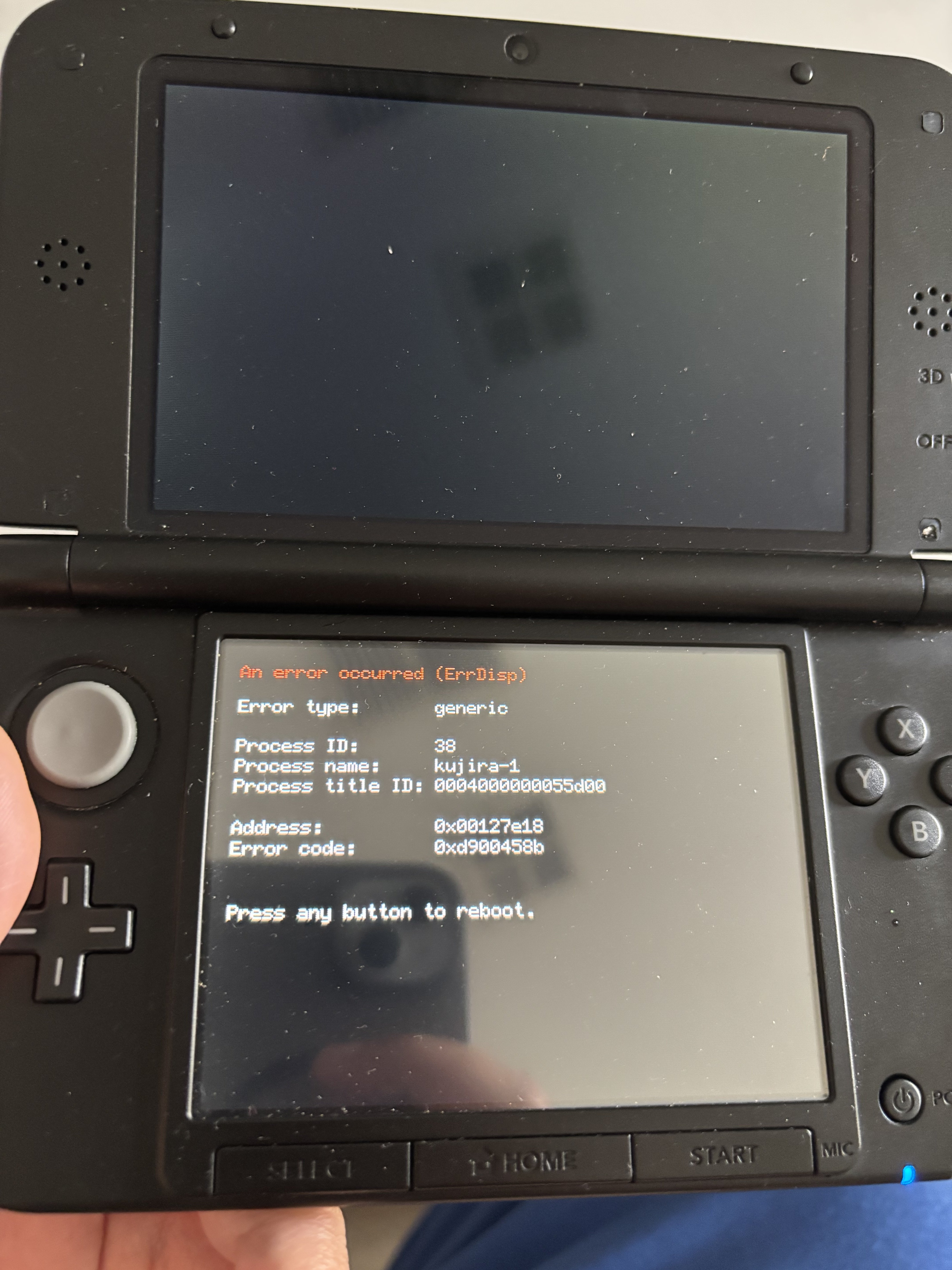

So I did try to fix corruption like 2-3 times now took like 24 hours and had to skip sometimes cuz it would get stuck. The game now boots but I get this error after loading save. I don’t care about previous owner save. If I have to do new game I can.(edit, I did and nothing changes I still get the error. When I try to verify I always get error)

Well, you can't just skip blocks if you want the game to work, sadly. As long as the hash is changing, it's doing something, and you may as well just let it run for a bit. If the thing truly gets stuck, then it'll skip it on its own.

I had one stuck (but the has was changing really slow like 3 per second and was there for like 5 hours) Okay now I will leave it as long as it takes then. The idea is to leave it be and maybe even have to do it multiple times on fix until verify runs with no problems ?
