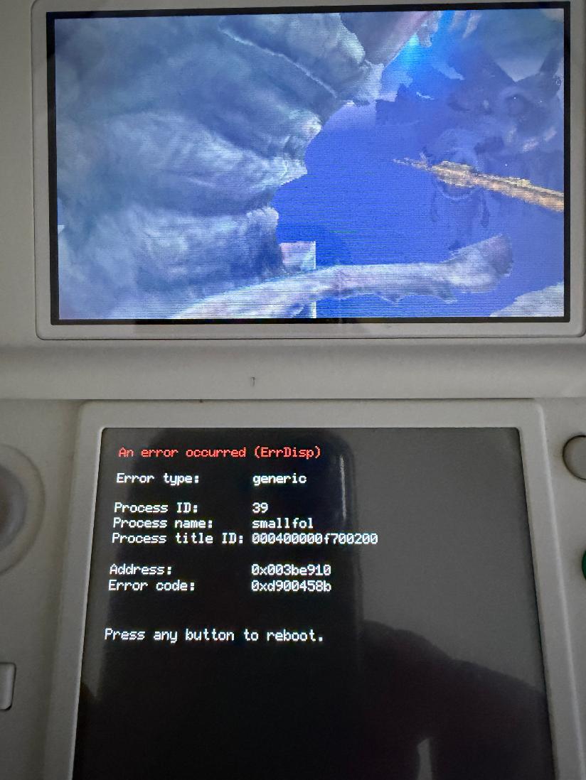

I have the same problem with Xenoblade Chronicles 3D (Australia). I tried many time to run the Cartridge Fixer (Latest 1.91). When I open the game always stuck. (In the picture)
The verification does not work for N3DSXL carts (some upstream Godmode9 issue).
Just use the fixer directly, not the lua script/verify option.
