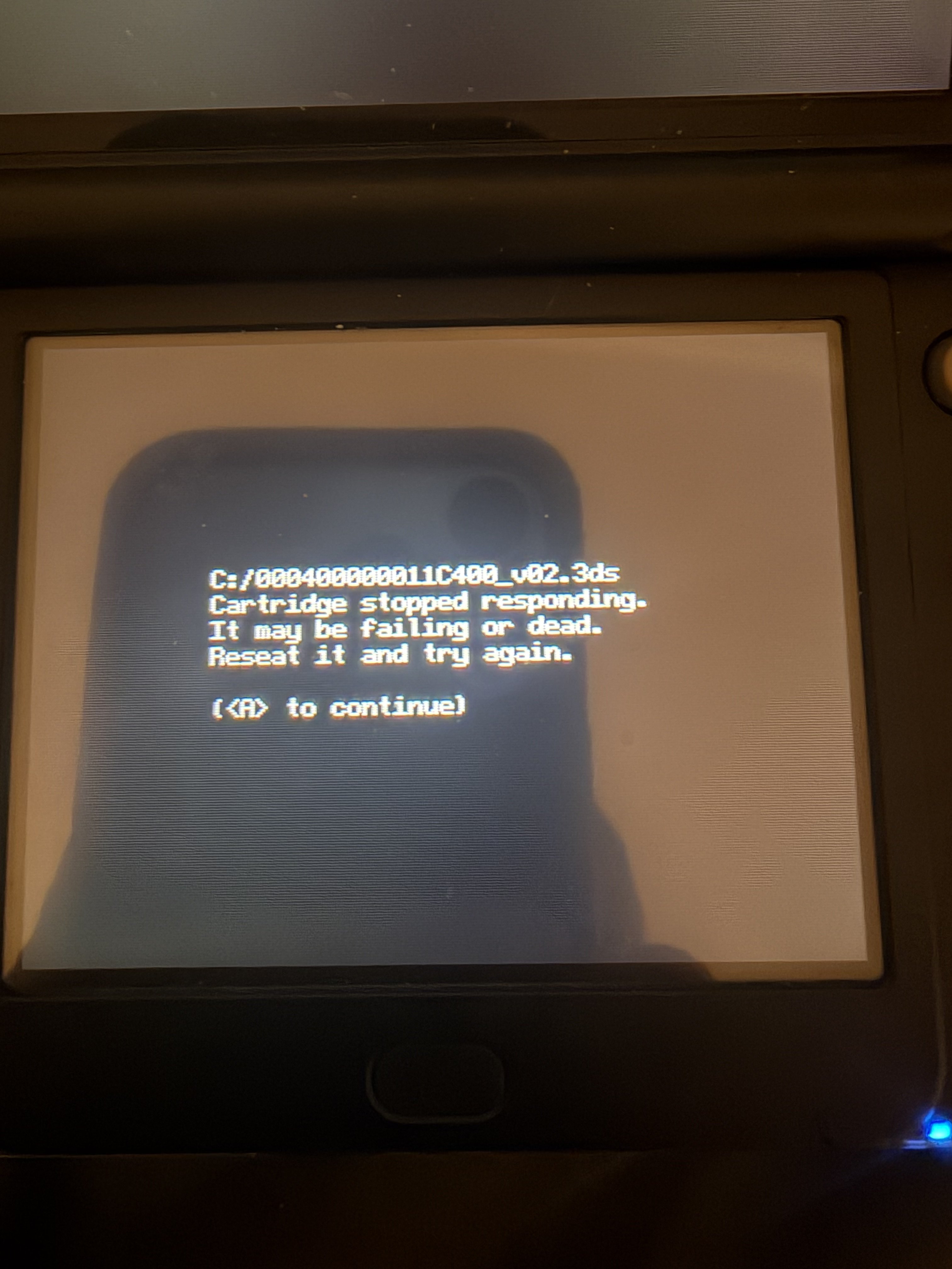

@Peffse, kind of sounds like the Omega Ruby cart might have some sort of physical defect. Could be one of those carts that actually need reflowing?
Yeah, I feel like the particular chunk is dead dead. That would explain how it got up to 82m refreshes, and then the ever-decreasing amount of refreshes until freeze when I retried the tool. I bet if I continue dumping the cart to cia repeatedly it will eventually fail because each read lowers the limit.
I was able to use checkpoint to dump the save file by hot-swapping the cartridge, so I'm content with calling this one gone.

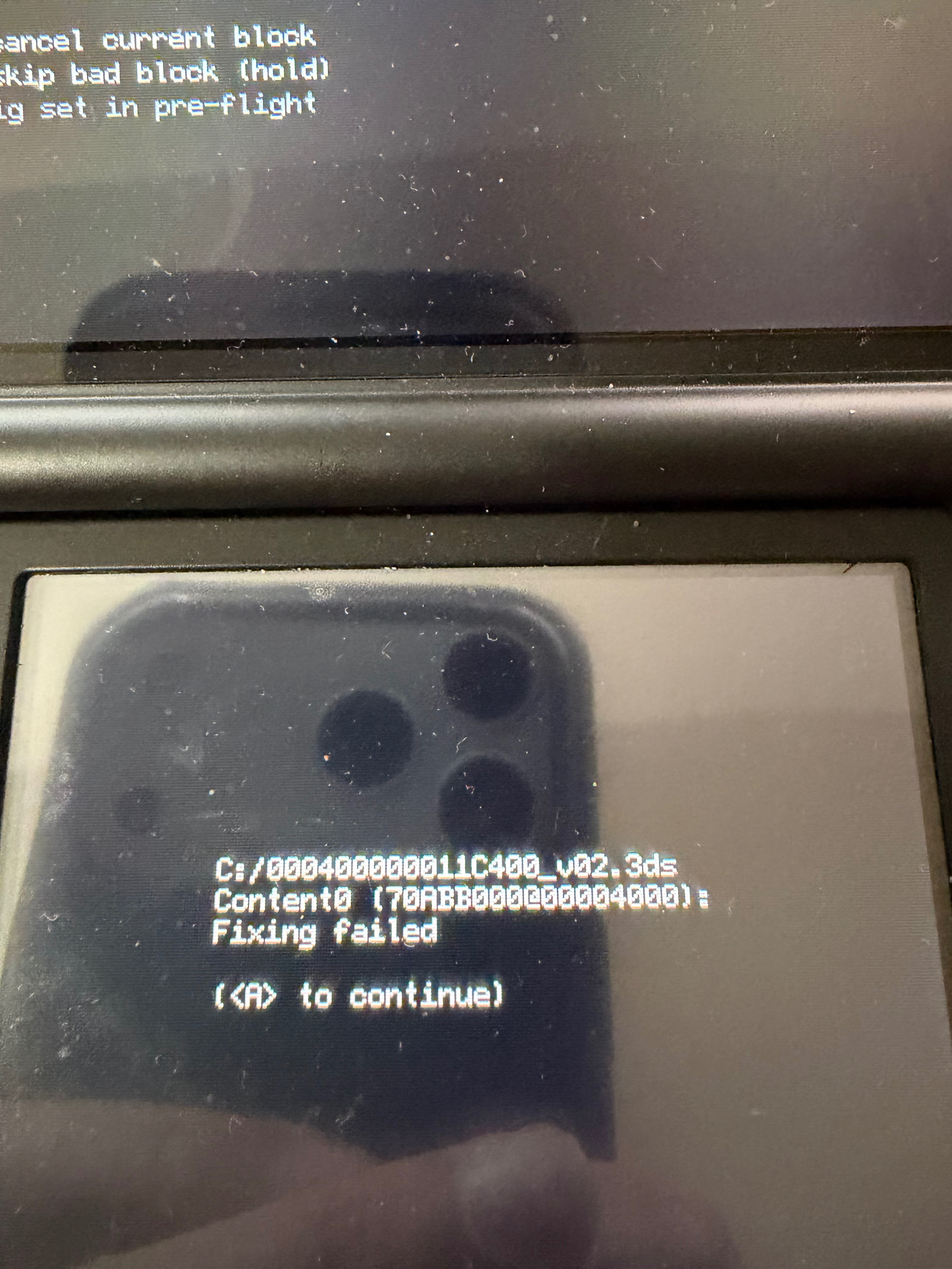

The old fixer finally crashed overnight. Attempting to use the new one and getting and immediate failure.
I’m pretty sure whatever the old program did finished it off. Because it freezes both the old and the new fixer almost immediately now.
