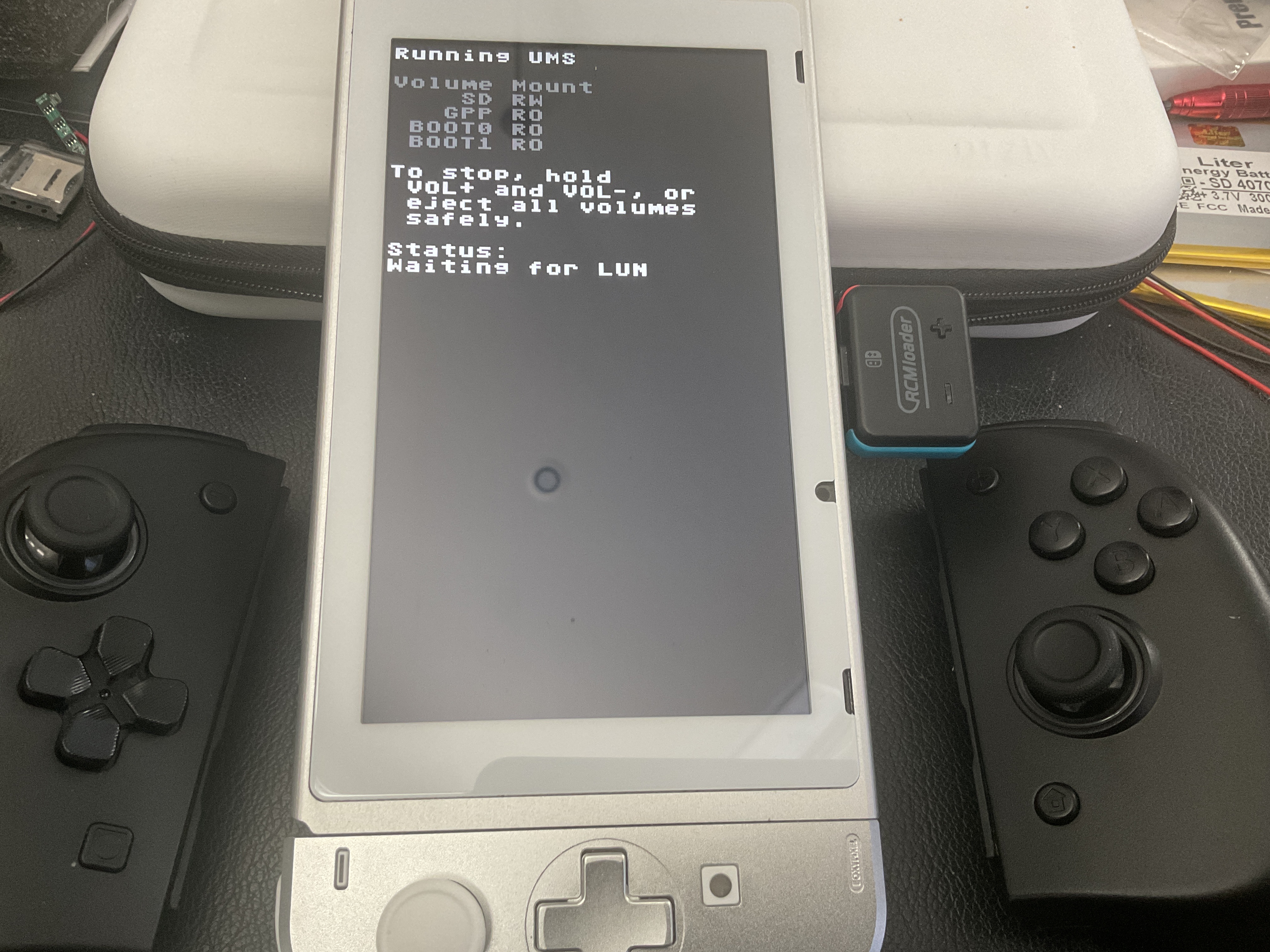

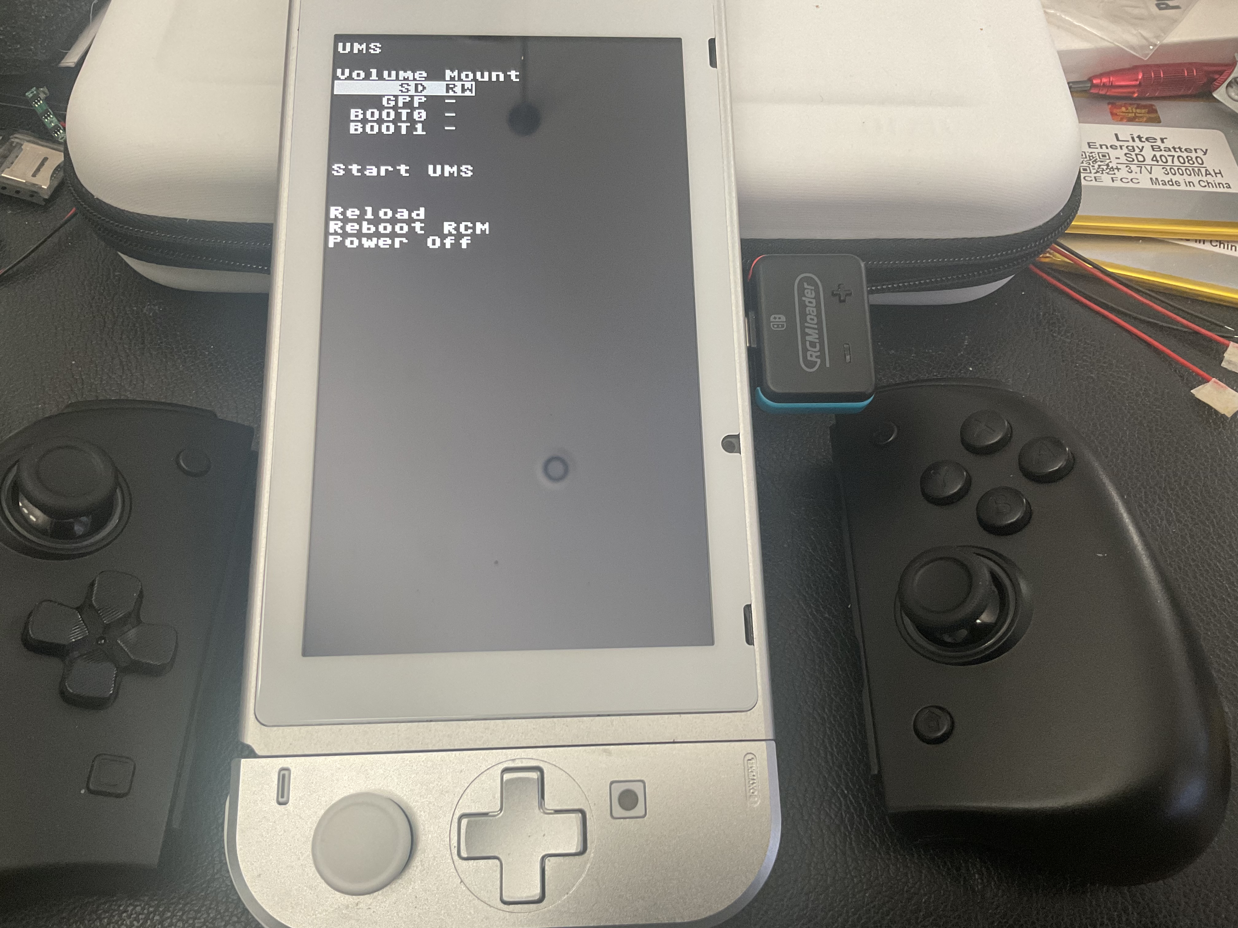

No sorry won't work
For ums feature you need NYX.
Here is a solution for this special problem.
https://gbatemp.net/threads/can-you-boot-cfw-using-a-usb-stick.624905/post-10051724
No sorry won't work

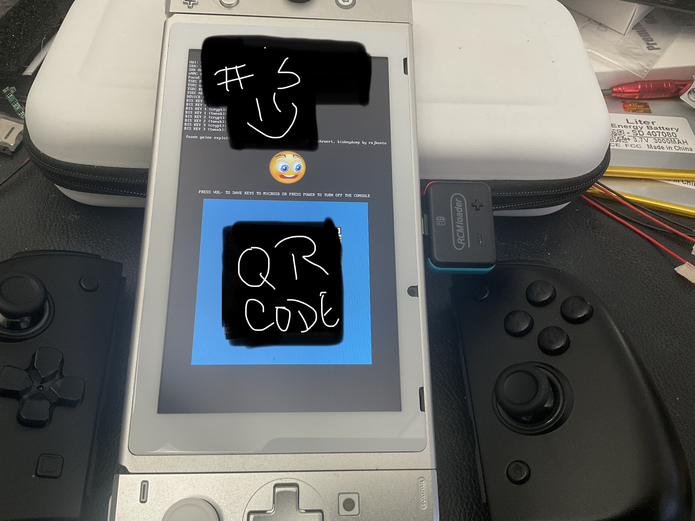

Confirmed…got it working using the link above. Neat!.
