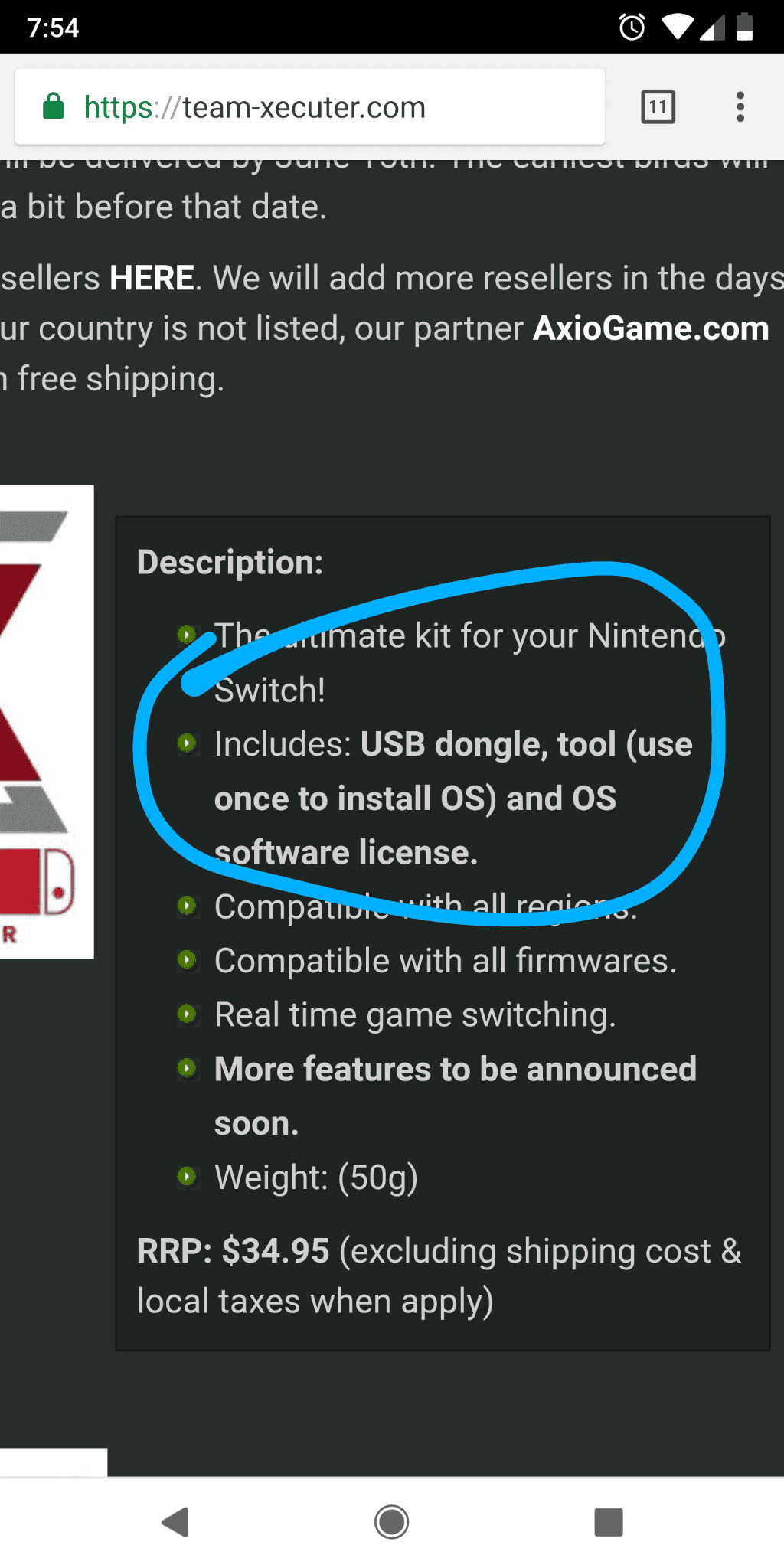

Wrong
It will be installed on the switch. You only need the dongle once
Wrong
No it will not.
You have to use it on every boot, or you use autorcm to skip using the jig.
It uses Fusee Gelee, nothing is persistent.

Wrong
That's completely incorrect.
Even in their own documentation it says you need the dongle every time.
The only thing you won't need every time is the jig (or as they can it the tool), which with AutoRCM installed won't be needed.
You'll still need the dongle for every reboot.
You should probably actually look into things before spending money on them.
Usb dongle, tool
The comma separates them because they are two different items.
The dongle is obvious, the tool is a jig used to boot into RCM.
The jig (aka tool) is only needed once to install AutoRCM, after which you don't need the tool (jig) but will still need the dongle. This is even explicitly stated in their Q&A someone quoted above.
