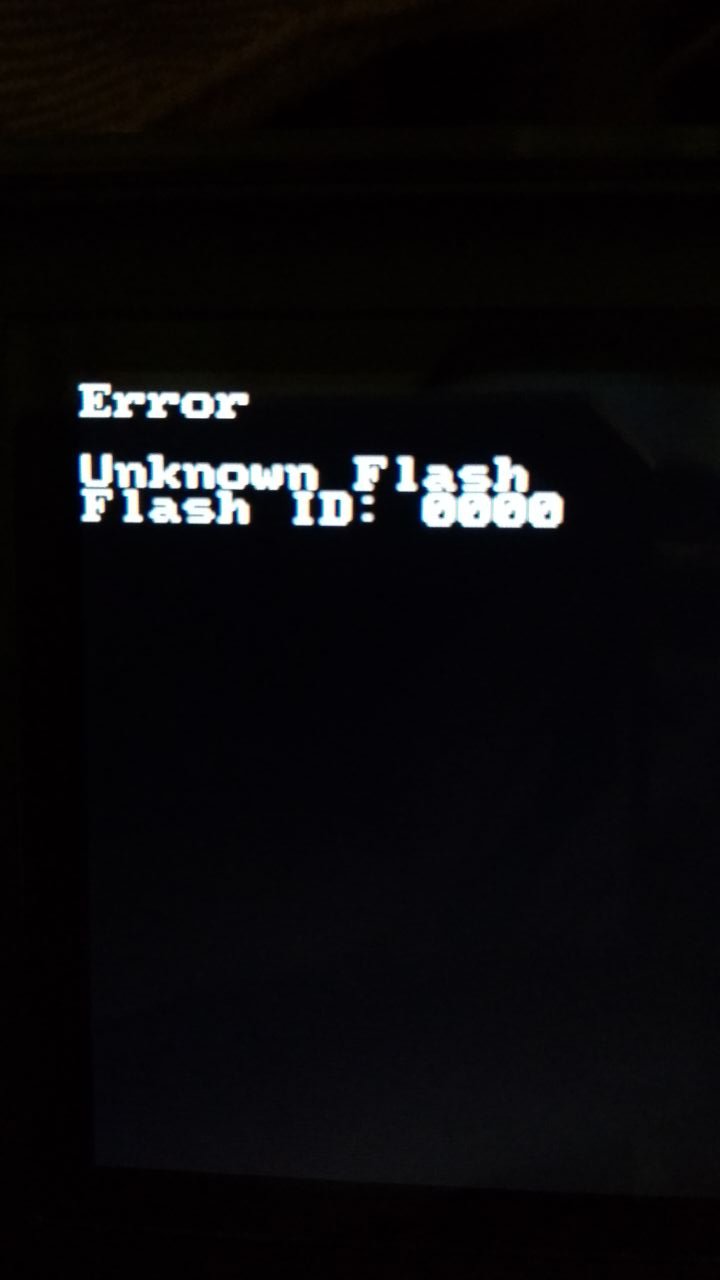

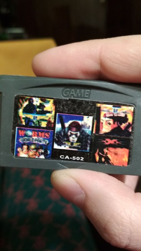

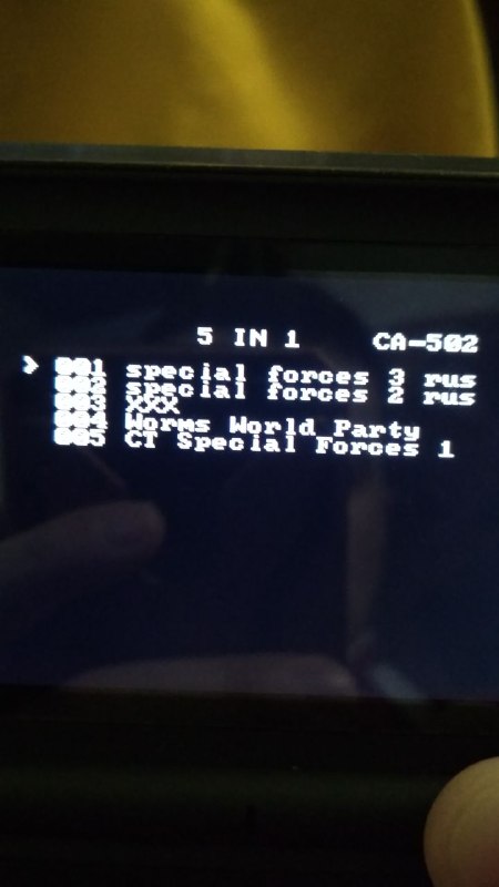

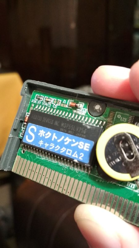

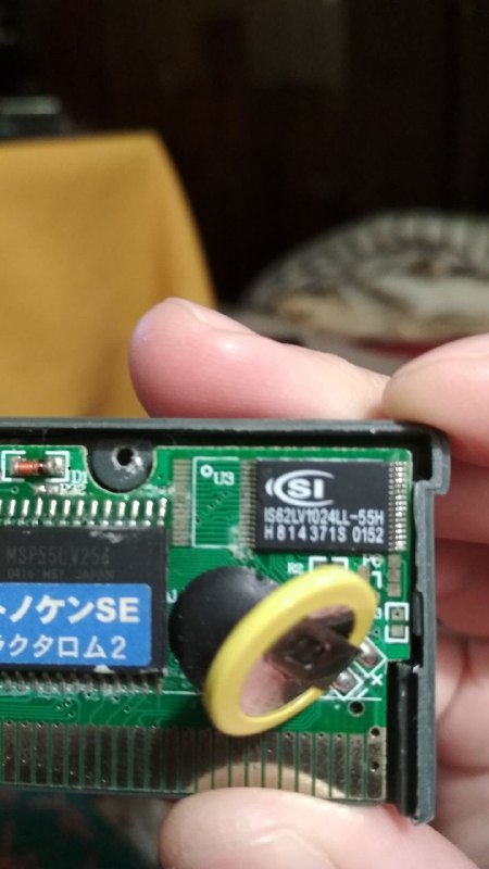

Hello. Thanks for your software, it's great. I have some bootlegs and am ready to be your tester. Bootlegs on fujitsu chips with 16 MB are recorded perfectly, but similar ones with 32 MB give an error 0000. In the evening I will be able to take a photo of the bootlegs
U a welcome)

32MB bootleg judging by the roms
