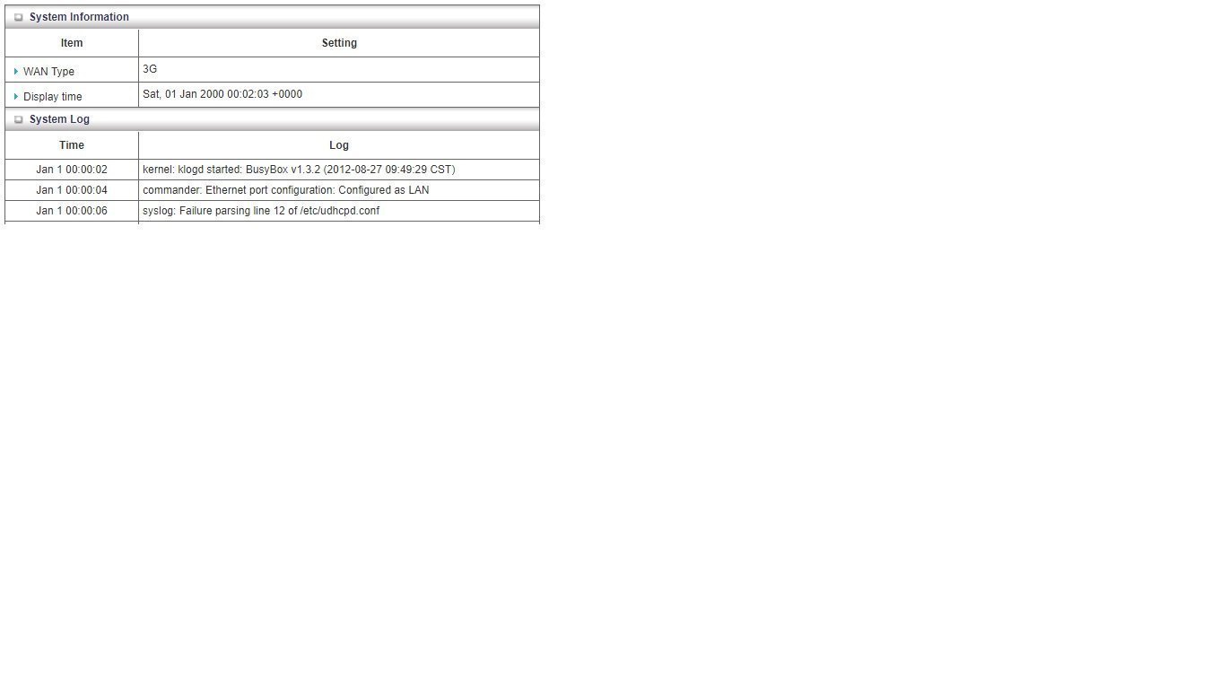

Back to my Alcatel Linkzone MW40 4G Router.
I finally managed to get script execution exploiting a vulnerability in GoAhead webapplet (Cross Site Request Forgery). Any clue how to open a root shell from there ?
Typically, the root password is also the password used by the web admin portal. (because the web-admin portal typically just wraps console commands, and uses that user authority to do its things. :P) If you can get it to execute sshd, or telnetd under root user, you can then log in and do the needful.
In fact, you might just try ssh at it regardless. The ADSL router I got from century-stink has an ssh daemon running by default, but lands you into a 'strange' half-assed router admin shell. You can get to normal linux busybox shell by running sh at the command line, and then its your oyster. (Root filesystem is reasilly remounted as RW even.)

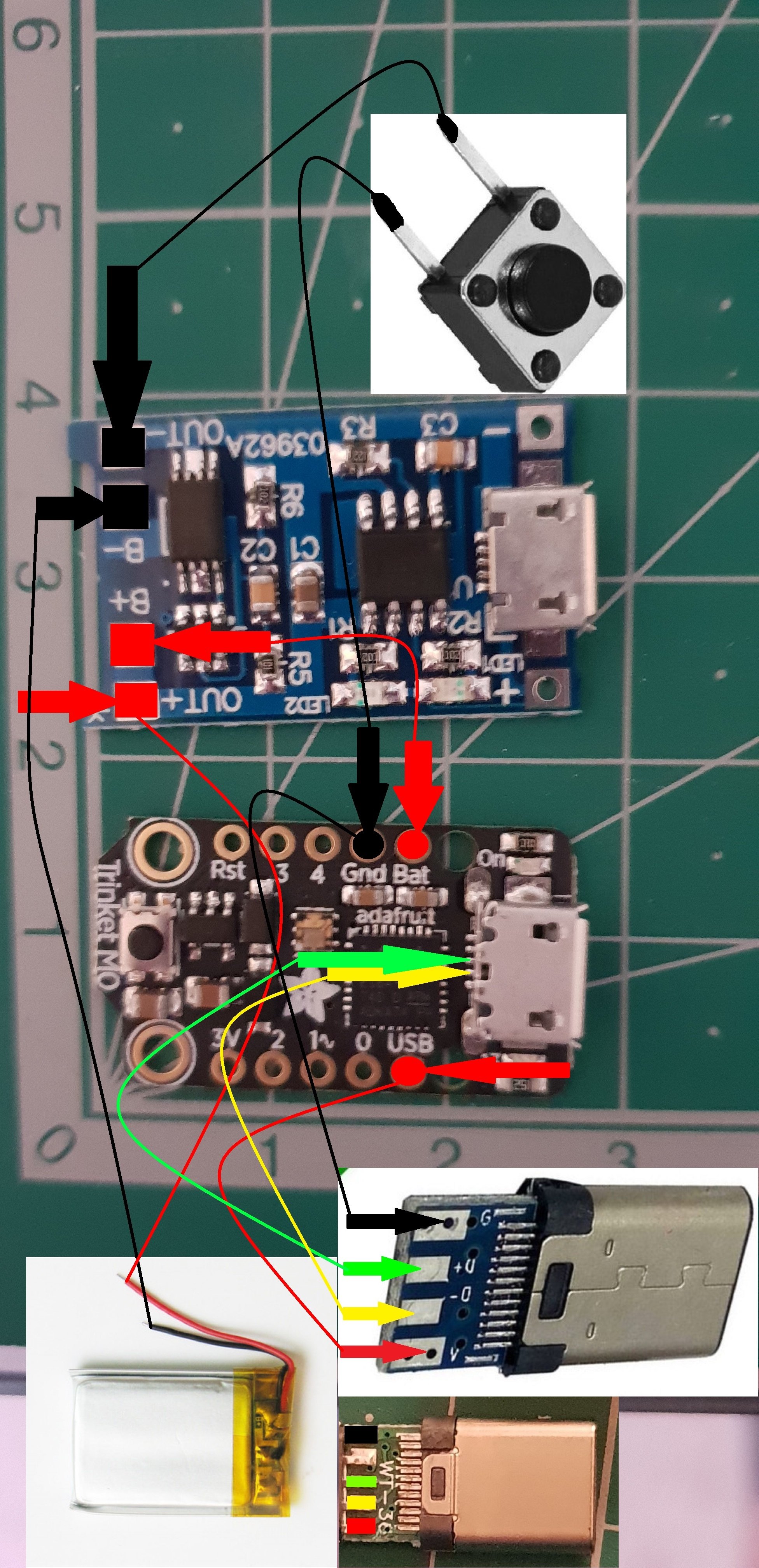

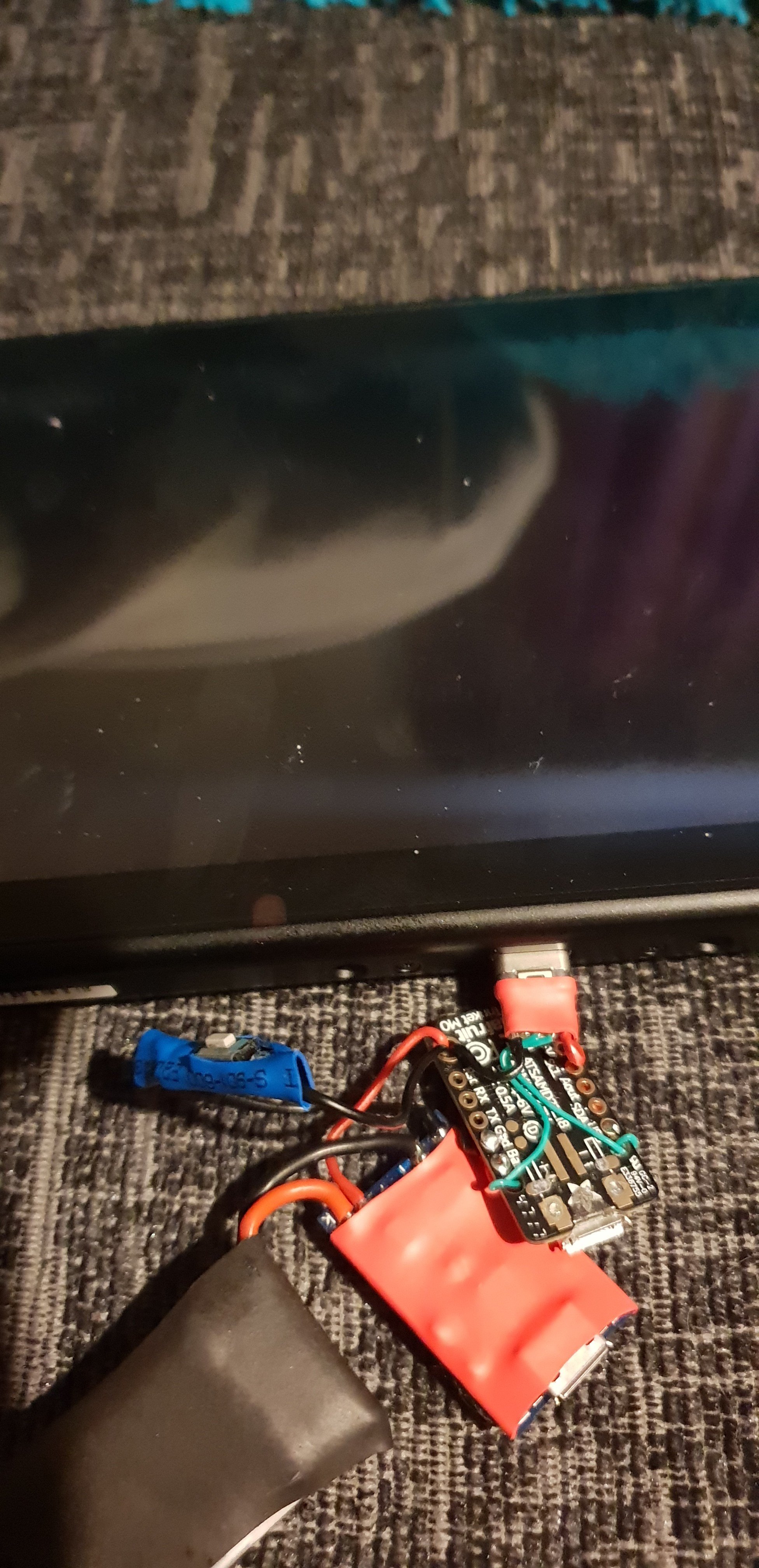

trinket m0
tp 4056 charger module
trinker M0
3.7v 240mah polymer rechargeable Lithium battery
TP4056 battery charger module.
OTG usb 3.1 type c connector with pcb.
switch.

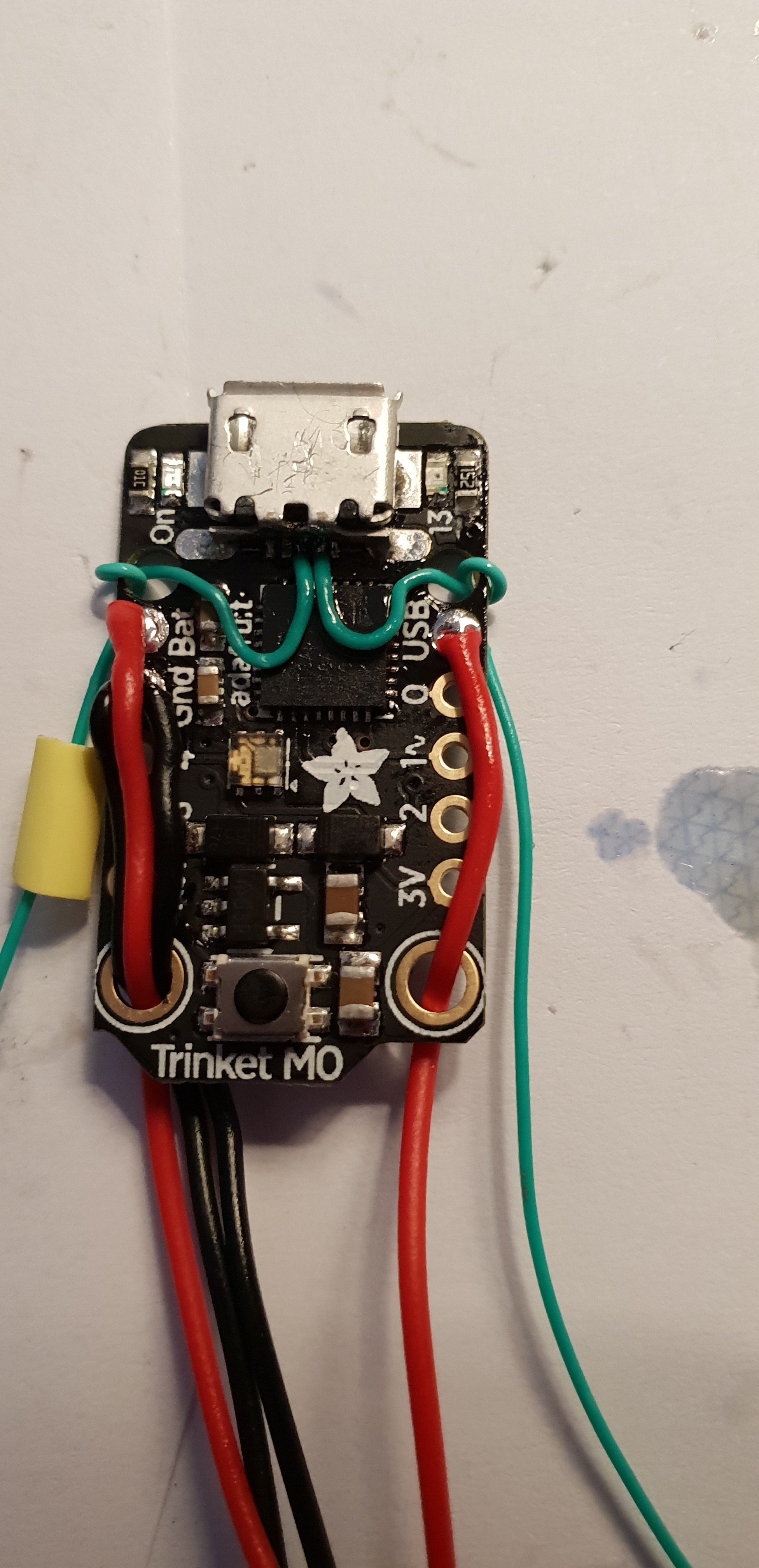

this how I did mine, the most difficult part was actually soldering the data + & data - wires the the points on the trinket as you don't have much room and pins are small.
you don't have to solder the usb wires to the trinket for this to work you can get a micro usb male to type c female usb lead or adapter. so removing the need to solder 4 wires on the trinket.
data wires are the most difficult to do. I used kynar wire.

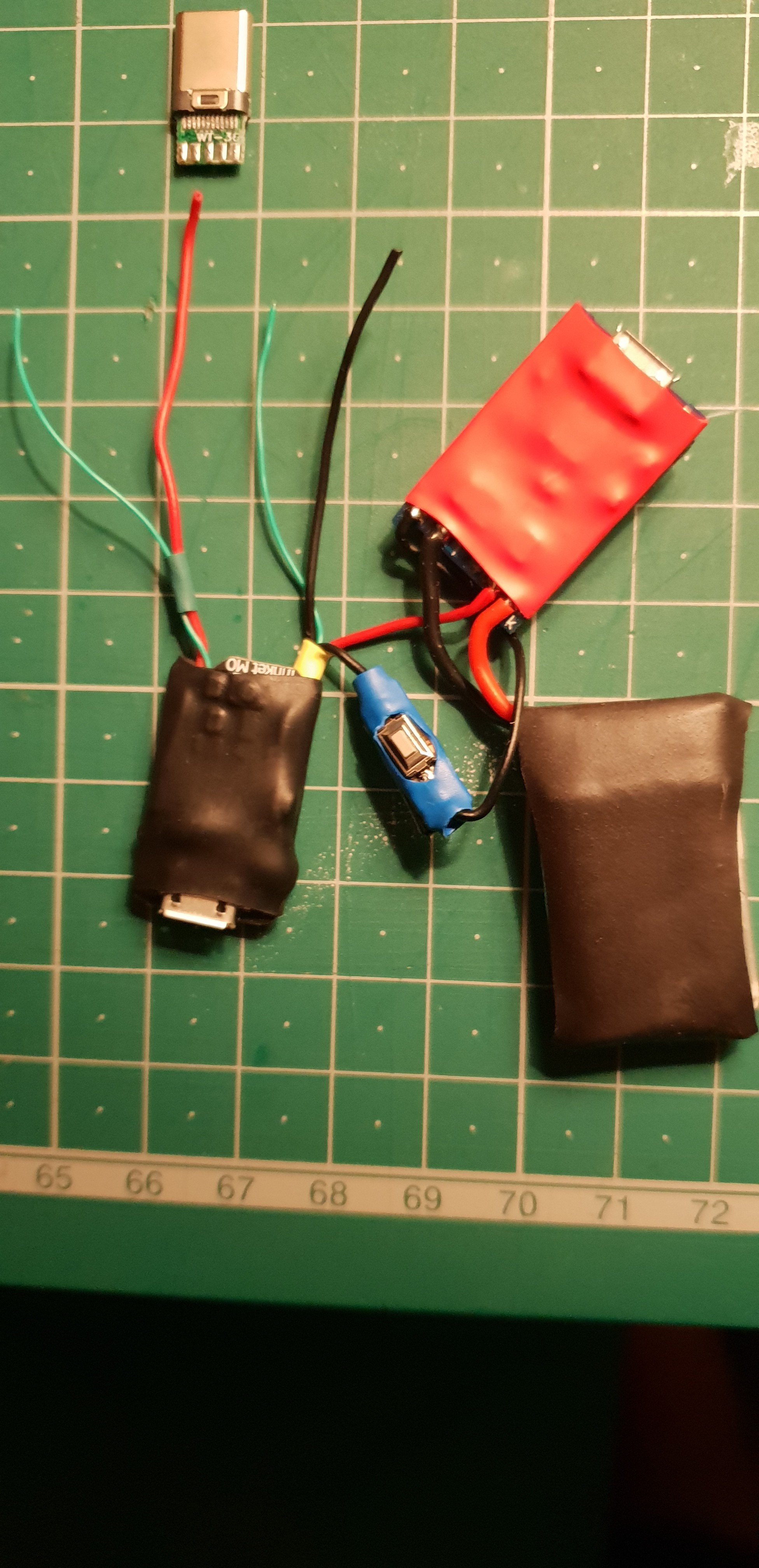

how mine looked before last stage of build.

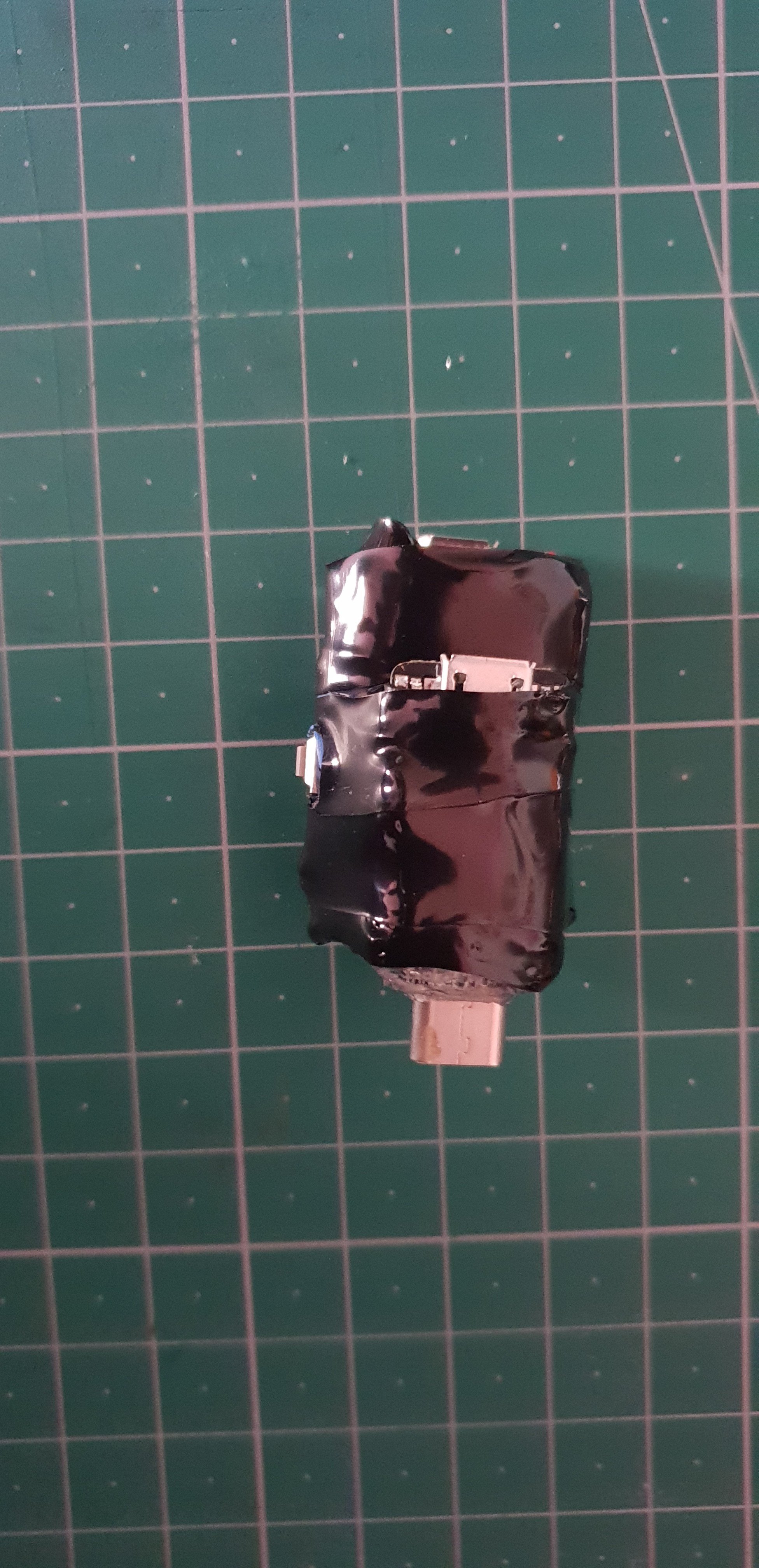

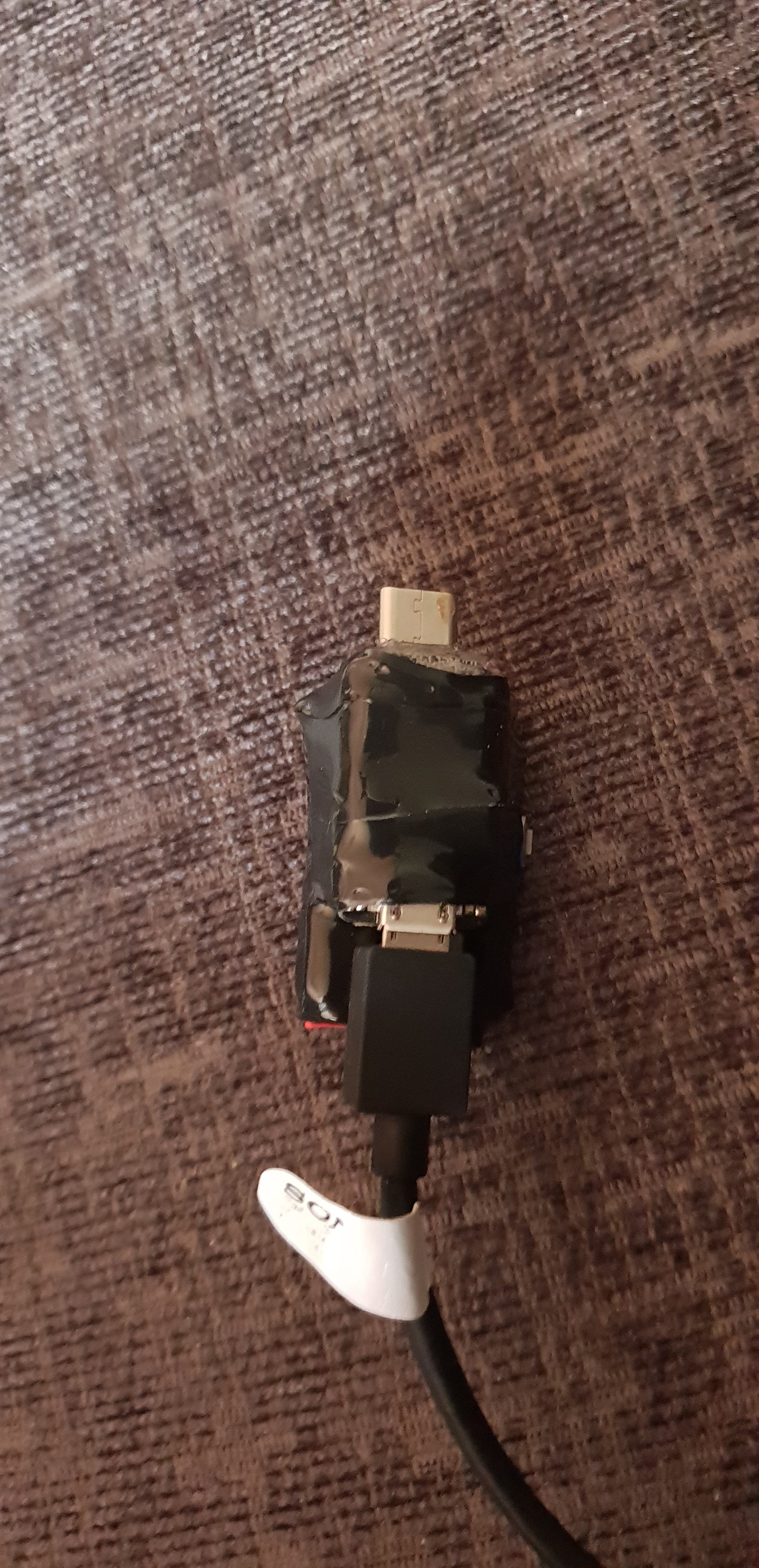

my final outcome.
if you wanted to skip soldering the data wires and red usb and black GND wires, then you can do so and use a lead like in this image to connect to the switch

trinket m0
trinker M0
switch.
View attachment 133201 View attachment 133202
my final outcome.

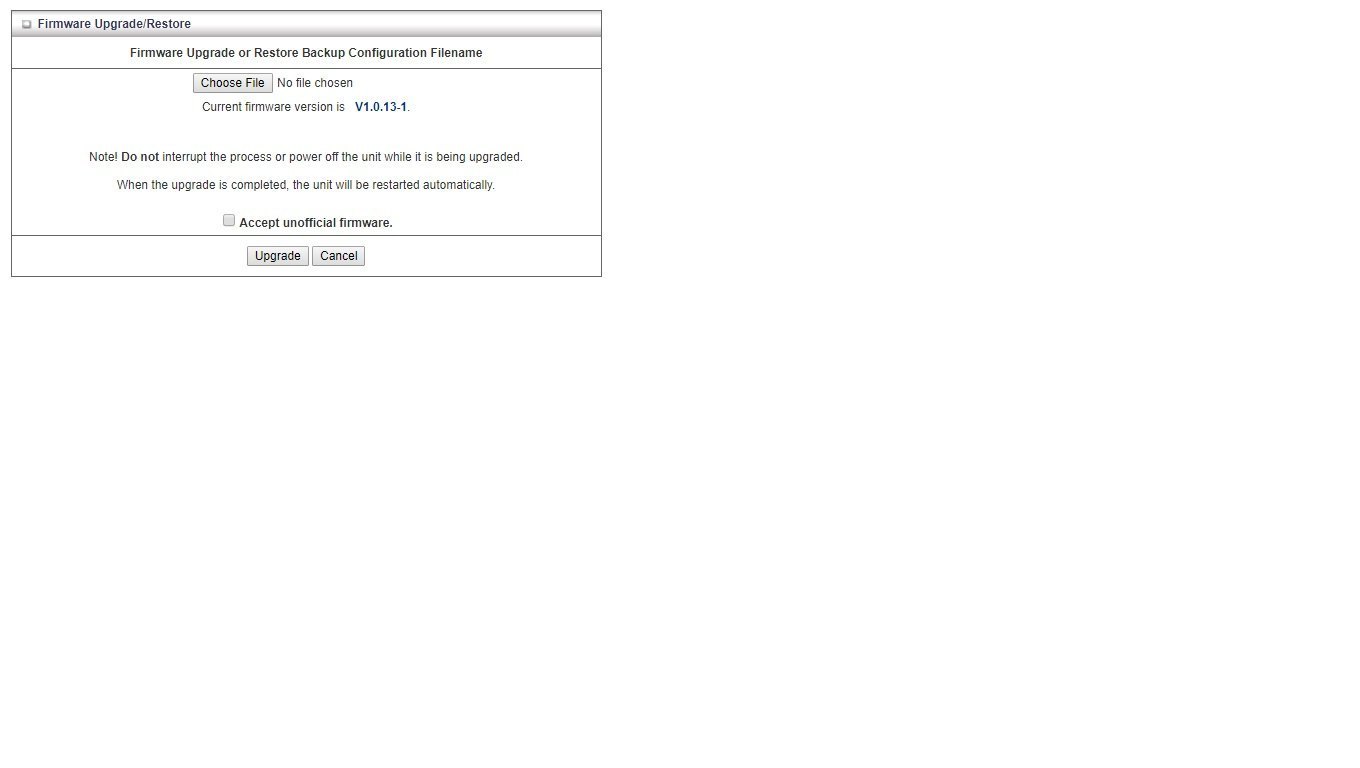

Will this one work ? I have one doing nothing and would appreciate if someone can help me flash it because i don't know how to do it my self? Thanks
http://www.zoomtel.com/products/4506_specs.html
Wireless LAN standards IEEE 802.11n, IEEE 802.11b/g
Interfaces 1 X RJ45, 10/100 Mbps selectable for either a WAN or LAN connection
1 X USB 2.0 Host
WPS button, power switch, reset button
Wireless LAN security 64/128 bit WEP (Wired Equivalent Privacy);
WPA (WiFi Protected Access) and WPA2 with Pass Phrase;
SSID stealth; WPS for easy security setup
Internet security Stateful Packet Inspection (SPI) Firewall
Network Address Translation (NAT)
Denial of Service (DoS) attack detection
Virtual Private Networking (VPN) pass through
MAC, Packet, and Domain name filtering
URL Blocking
Management Universal Plug and Play (UPnP)
Browser based management
Wizard-assisted setup
Simple Network Management Protocol (SNMP support)
Advanced router
functions Quality of Service (QoS) support
URL Blocking/Filtering (parental control)
Scheduling rules (parental control)
Virtual Server, Port triggering, and DMZ host
Dynamic DNS
Configuration Backup/Restore
Wireless Multimedia Extension (WME), WiFi Multimedia (WMM) support
VPN support IPsec, L2TP, PPTP VPN passthrough
PPTP, L2TP connect

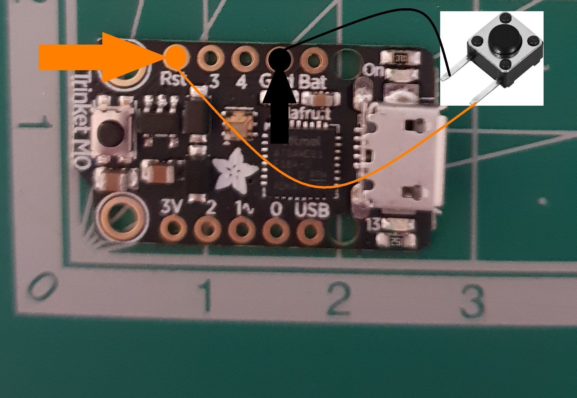

it's possible to fit the trinket in the switch, but how would you flash an updated payload to it as the reset button needs to be double pressed, also the power source for the trinket for rcm mode, now power from the switch once powered off.
I'm not that clued up about the switch like I am with the 360 installs.
I'll probably try pick up a second switch to have a good tinker with..
I gave testing flashing the trinket while plug into the switch and it seems to flash without a issue
possible this could be the new reset if installed actually inside the switch. but im still waiting on a few bits to turn up to give this a try.
