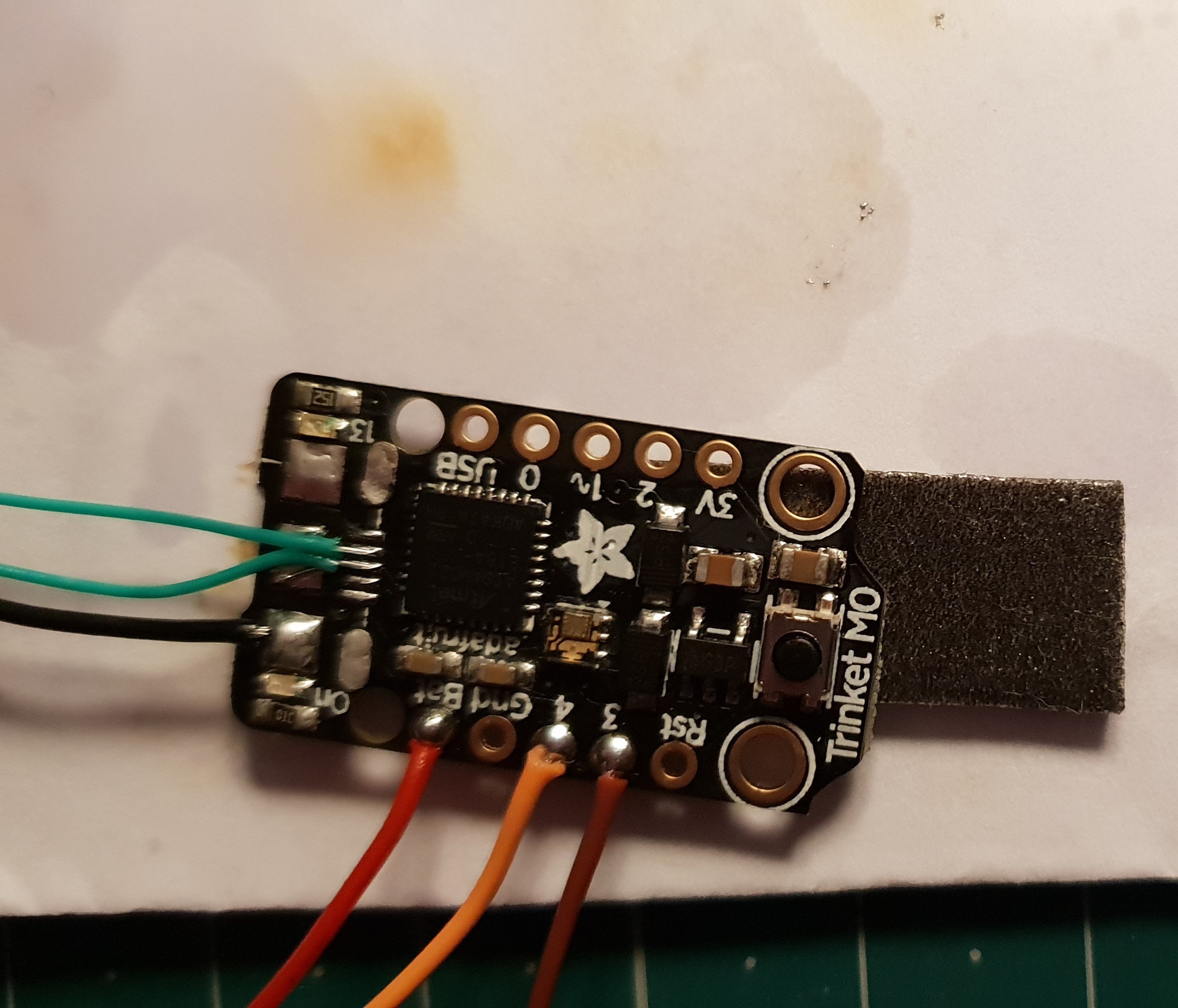

yeah I have the trinket files already created, I just tested the sxos one I created and it works fine.
how I tested was plug a usb lead into the trinket with only the data wires connected, the external power to bat pad and gnd pad,I didn't have pads 3 and 4 connected.
pressed and held volume up button and power button, released then I touched one off the pads that need to be connected to mobo and sx os booted up.
hopefully my switch opening kit turns up tomorrow so I can do the install properly.

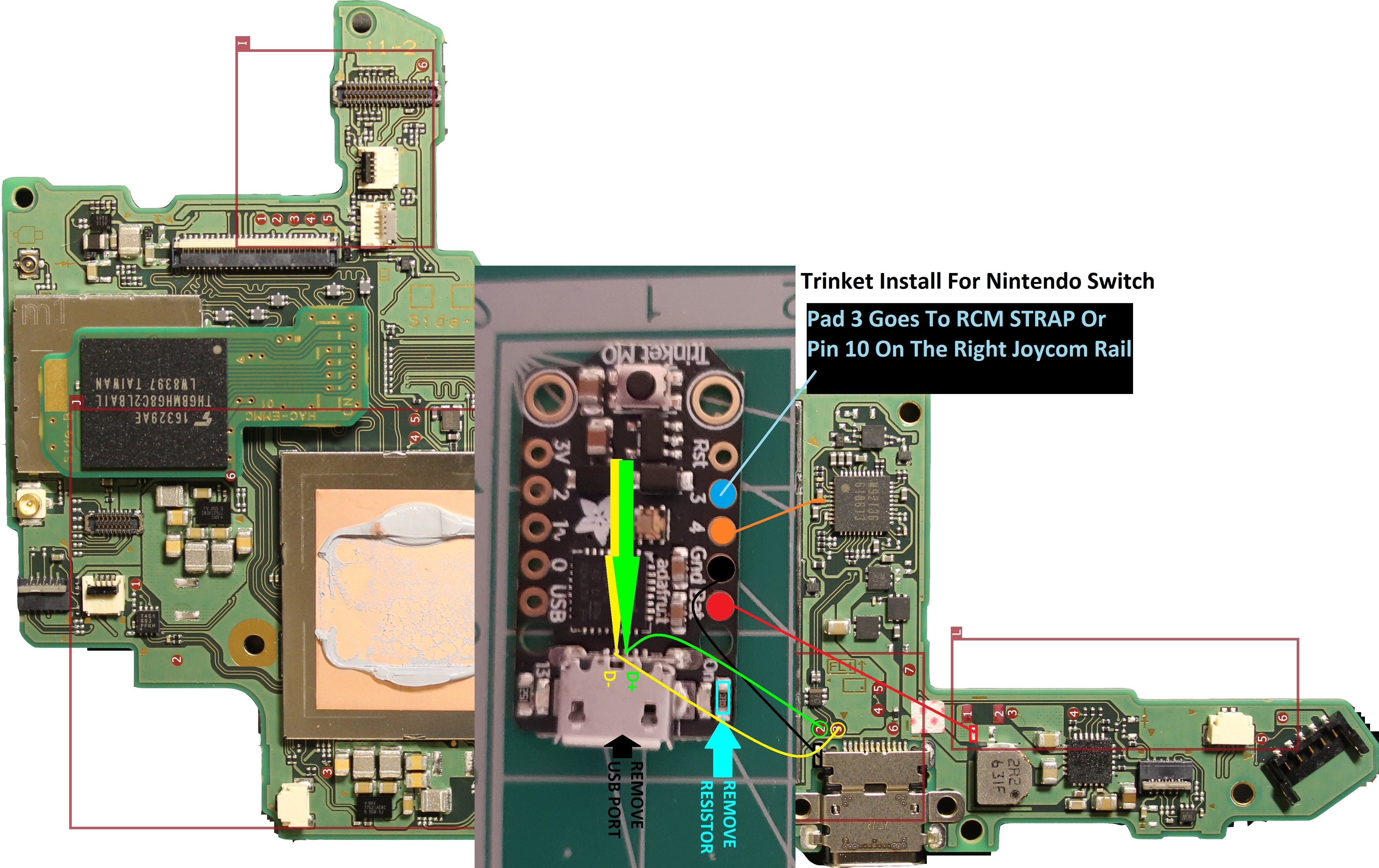

i copy his guide but colour coded the points for ease of use for myself.
