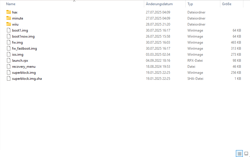

Okay, I downloaded the entire ZIP file again from the website and extracted it to the SD card again, with the same result. Then I downloaded the three files from 1.4 minutes via Git Hub and moved them to the SD card, overwriting one of them. Now I have two more files in the root of the SD card (fw_fastboot.img and boot1.img) and I don't know what to do with them. But in the end I still get a pink screen and when loading the Wii U menu it stays in a continuous loop (I even waited 5 minutes to see if anything happened).
Here's a screenshot of my SD card. It's possible I copied something incorrectly.

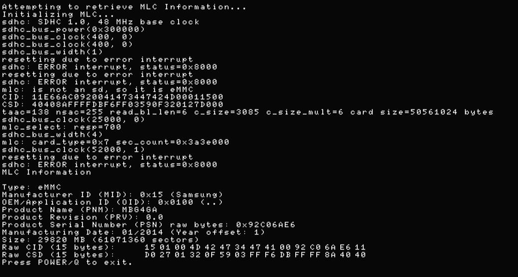

Can you display the MLC info in minute? It's in the backup and restore menu.
Also dump the logs again to see if a new log was written or if it crashes so bad, that it can't even write logs anymore
Hi SDIO, sorry I haven't been in touch for a while, but we were on summer vacation, and my kids kept me completely busy.
So, I dumped the system crash log again and also took a screenshot of the MLC.
hm the logs didn't change. The eMMC is a Samsung so probably fine.
Did you already try creating a new user? You could also try setting up redNAND and see if that helps.
