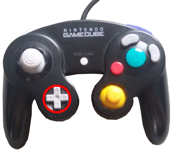

Prepare GameCube Controller
If it is an official controller, it must be screwed on beforehand. This step can possibly be skipped for 3rd party controllers.
Screw your GameCube controller with the tri-wing screwdriver, being careful not to misplace the screws. When you have removed all screws, carefully remove the back plate of the controller and now remove all screws from the motherboard of the controller.
When all screws have been removed, you can now take the controller board out of the housing. When removing the board, take care that the individual rubber pads of the buttons can still adhere to them.
You should now only hold the board with the connection cable in your hand - take the pad of the control pad and place it on the mainboard where the control pad was.
635px-GameCube_Controller_Rückseite_Schrauben.jpg 800px-GameCube_Controller_Rückseite_abnehmen.jpg 691px-GameCube_Controller_-_Vorderseite_Dpad.jpg
Run SaveMiiFrii
- Connect the controller to the fourth port on the Wii console
- Turn on the Wii and hold all buttons on the directional pad at the same time (or on the rubber where the directional pad was)
- The screen should remain black and (depending on the menu) show the version number of the system menu at the bottom right
- Insert a disc with a newer version of the Wii system menu than the currently installed version and the Wii should update from the disc
If you like to try.:)
Good Luck and
Thank you.:)
