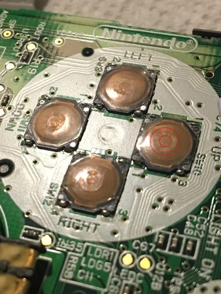

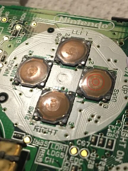

Hey all, I want to warn everyone about these metal CNC buttons. If you're familiar with them, perhaps you know these buttons are NOT to be installed with the silicone button pads. However, without that silicone protection, the metal CNC buttons scratch your motherboard. Look at my photos, this is after second day of install (actual time button mashing and having fun; probably less than 10 hours, realistically). Can you imagine what a month or year of usage would do? Look further, I've taken images of the buttons underside, you can see the pegs are the exact size and spacing as the scratch marks on my motherboard. If you've installed these, and you care about preserving your Gameboy, you might want to check your unit.
Also, these metal buttons rattle in the shell, ALSO because there is no membrane to keep them in place. You'll definitely hear them rattle, because it's metal on plastic. Both Retro CNC nor Retro Lame Repair Shop won't provide any solutions, nor will they return my purchase. These buttons look awesome, but it's not worth damage to the unit, in my opinion. If that's not your concern, at least know what you're getting into. Perhaps these are for display units that you don't intend to play. Otherwise don't be like me and get stuck with this expensive fail. Yippeee! Maybe I can turn them into lapel pins. lol

Do you have any pictures showing the condition of the switches before using the metal buttons?
Nintendo used a couple different types of switches over the years and these dark brown ones are softer than the silver ones. Even the original pads and buttons left marks on them.
If you’re worried about that scuff on the PCB I would just put some Kapton tape over it, not electrical tape. Electrical tape would probably do more damage than the buttons ever will.

Although I had my concerns about this install, I didn't take before pictures of the d-pad, B, or A button switches. I should clarify that I never installed the metal buttons on the start and select switches. The last image (of the start and select button switches) shows how the d-pad, B, and A button switches looked before install. I don't have proof of that, but I know my dark brown switches did not have any scuff marks, as they were the same condition as the start and select switches. But to further support my claim, how else would I have scuff marks identical to the pegs (in size and position) on the backside of the metal buttons? Besides that, I remember what I saw.
I might try that Kapton tape. Thank you for the suggestion.

Do you have any calipers to give us some measurements? For instance, I am willing to bet that those pegs on the metal d-pad are the same diameter as the nubs that make contact with the switches on OEM pads, around 2.8mm. That's why the marks you are seeing are the same size. The entire surface area of the start/select switch is only about 3mm so it would be difficult to see any rings from the contact pads as any marks would be about the same size as the switch.
I was curious so I just checked on one of my boards with silver switches and they have similar rings on them (No metal buttons used). In your photos you can see what looks like 2 separate rings, inner and outer. This is the same ring that the button pads themselves leave due to the fact that they have an "O" shaped contact area with the switch.
Without seeing any before photos it's hard to say, but I'm not sure how a flat metal peg would leave that type of mark tbh.
Again, I would just put a small piece of kapton tape in the center of the D-pad to help prevent scuffing your PCB if you really care about it that much.

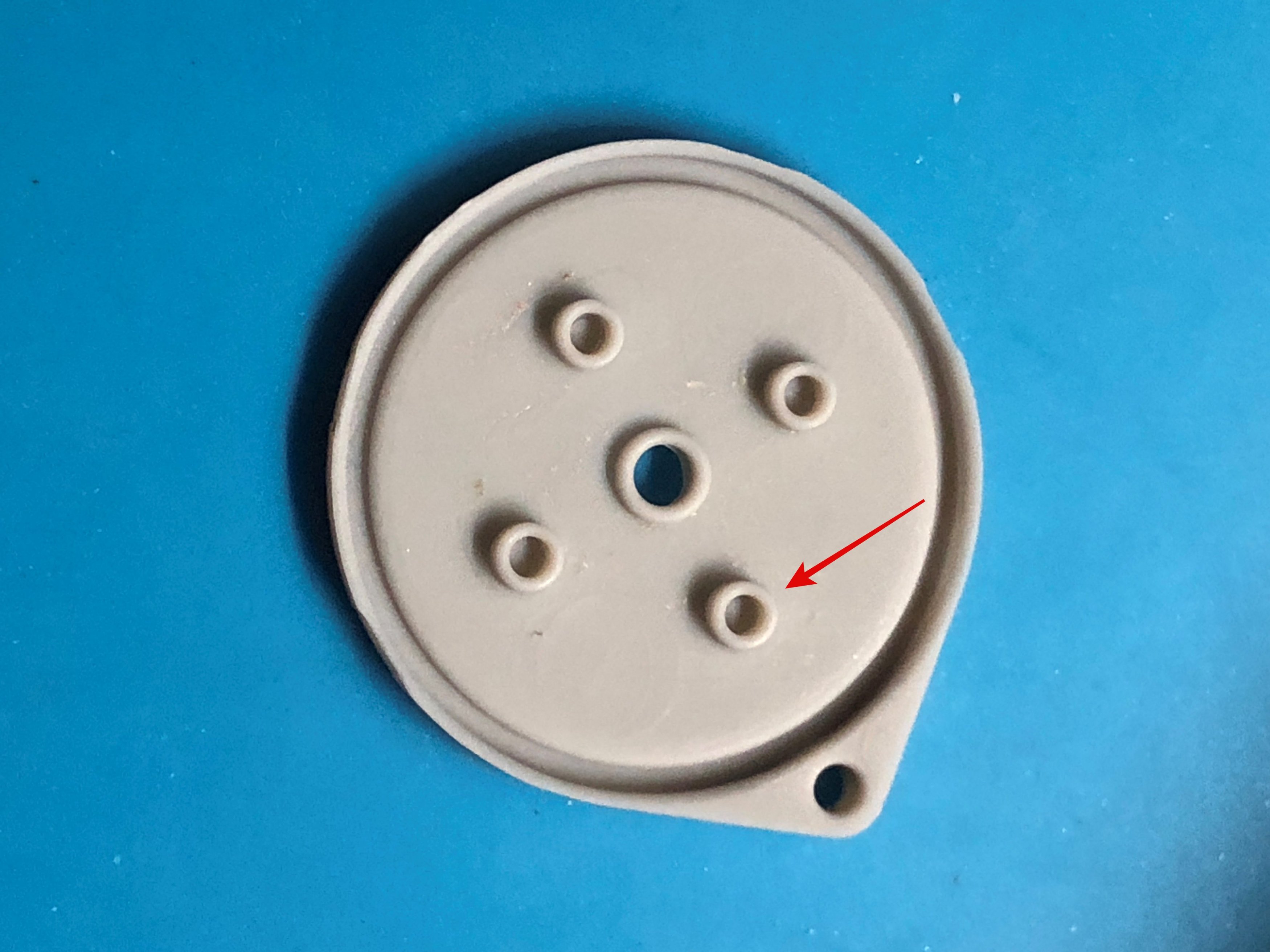

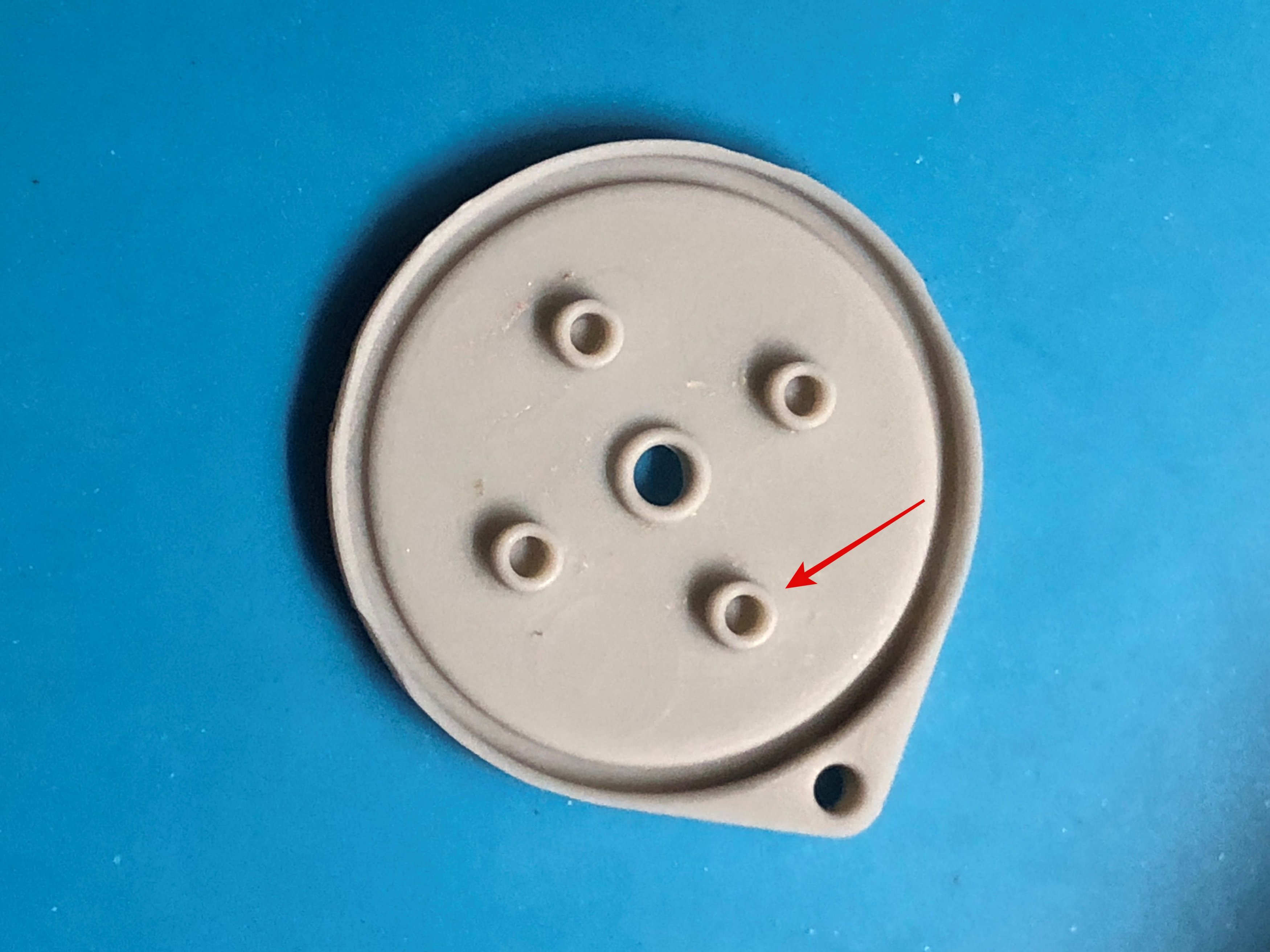

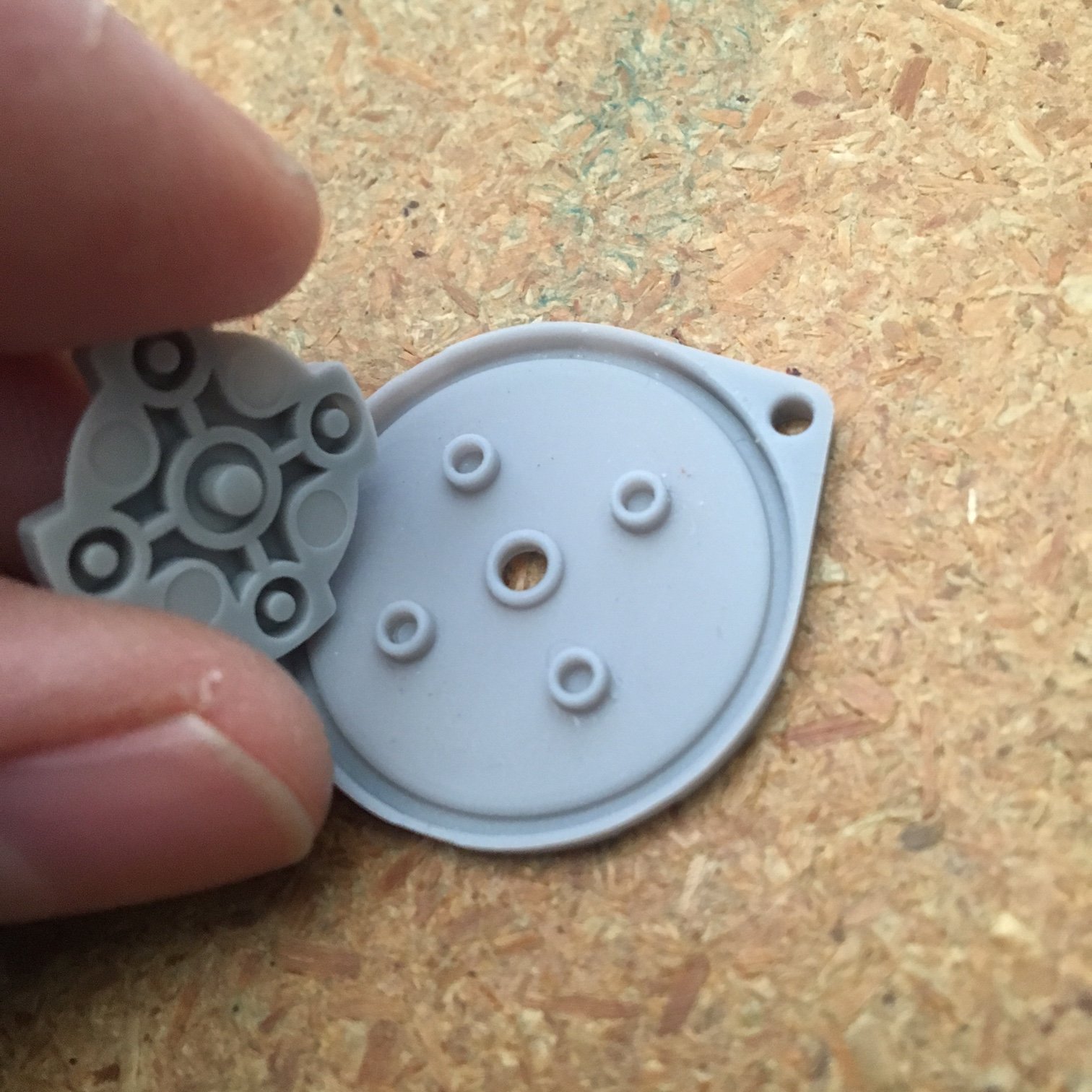

Thanks for the response and your questions. Can you include pictures of your pads (if you haven't already put your Gameboy back together)?
Just to clarify, that membrane pad goes on the other side you pictured. The side your red arrow is pointing toward, is the side that touches the d-pad button itself.
Below is the side that touches the motherboard. I've placed that piece side by side with the underside of the metal buttons.
You can tell from looking at the image; the metal pegs have a larger surface diameter, similar to the marks on my motherboard. My motherboard did not have scuff marks previous to install of the metal buttons. The scuff was created by metal friction.
