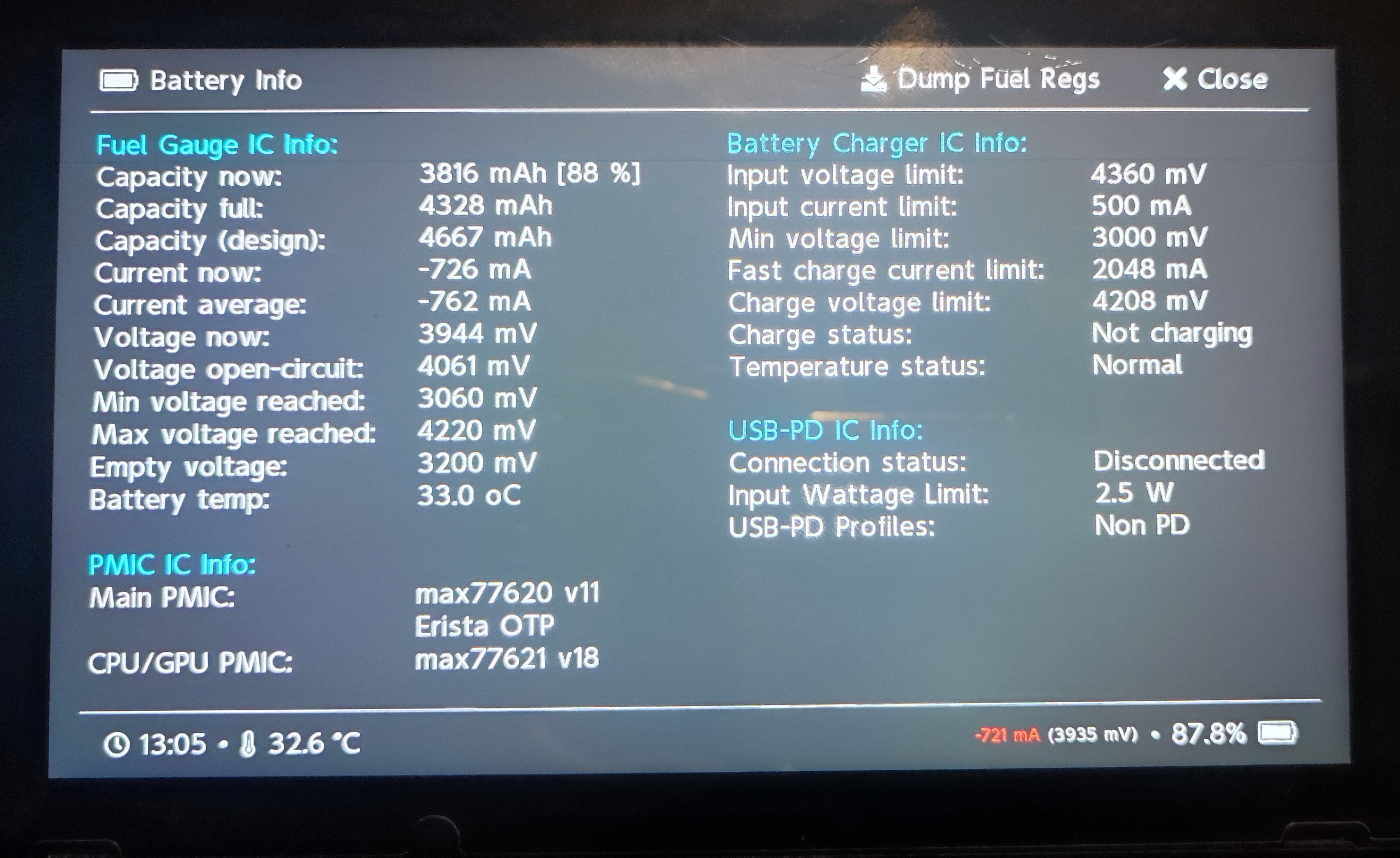

I've been having a problem with my switch and I was wondering if anybody experienced something similar. My switch is draining its battery in less than an afternoon while sleeping. I get between -700 and -800mAh drain while on Hekate.
Is it possible that any shorted component could cause this? My switch had some drops of water fall through the fan vent more than a year ago, I did the usual turn off, IPA bath and drying. Everything worked after that but this problem stayed since then. I have opened it again since then, gave the board another IPA bath and still the same.
Appreciate any help!

Yes its very possible and by your diagnosis very probable. Use aheat camera on the working console main bard to find which one is the culprit

Your current is about 150% of what im getting
