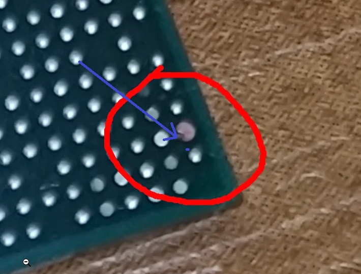

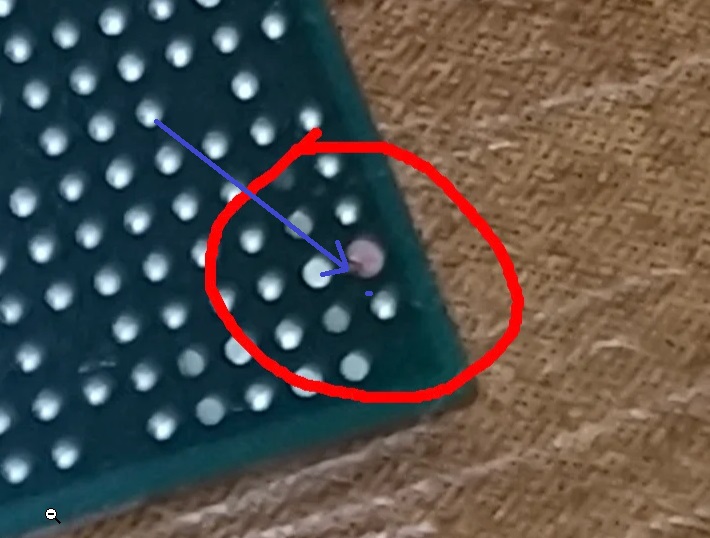

I dropped my Nintendo Switch Lite, now it has blue screen. I researched about problem and suggested to reball APU. Lifted APU and there it a torn pad on APU itself (right bottom corner), not on mainboard. Is it possible to restore it, and what is this pad responsible for, could it be just ground pad?

I mean it's not fully torn. So maybe you could just add a bit of solder to the area and like kind of stretch it/solder it slightly more diagonal at least that's what the picture looks like.
Hey,
I sanded back a part of the APU for u. So as You can see there is a small "tab" on the picture where u can solder a wire (I recommend 0.04mm wire )
0.04mm wire

According to boardview
Hey,
0.04mm wire
Thanks! Also according to boardview that i found, this pad is tagged as unconnected
