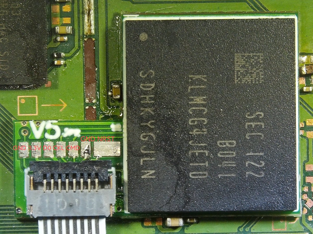

Hello every body.
Everithing is in the question, i broke the line of clk on a switch oled motherboard.
I install this modchip 8 times now, and all the console work great.
I broke the line using quicksolder pad , so now my advice is to no use it, it s not fit perfect, and it can cause damage for the switch.
So now the switch doesn't want to power on, so i think the CLK is relly to another point in the other face of the mother board, but no way to find it.
Is someone know an alternative , because i desolder the apu, and recreate the beginning but i think i have to rely to another one in the other face of the motherboard.
Maybe directly on CLK in the nand chip ?

The chinese have a emmc breakout ribbon where they take out all of the EMMC point. ( only seen proof of concept)
Would you be able to disconnect the clk point and UV mask it . Then run a jumper wire a bit higher of the clk point on the line itself? depending on your micro soldering skill level.
Once you desolder the APU, there are too many variables now. It really is a last chance kind of thing

Do you have a link for buy this flex board ?
Clk is not very well placed under the emmc . The solder pad is in the center . But there is a track rely to other face too, so I think he must be 4 points for Clk in oled motherboard but I am maybe wrong .
I have bga semi automatic machine . And other tools for work.
But even with this tools it s hard to do.
I will upload picture tomorrow .
gl doing that
