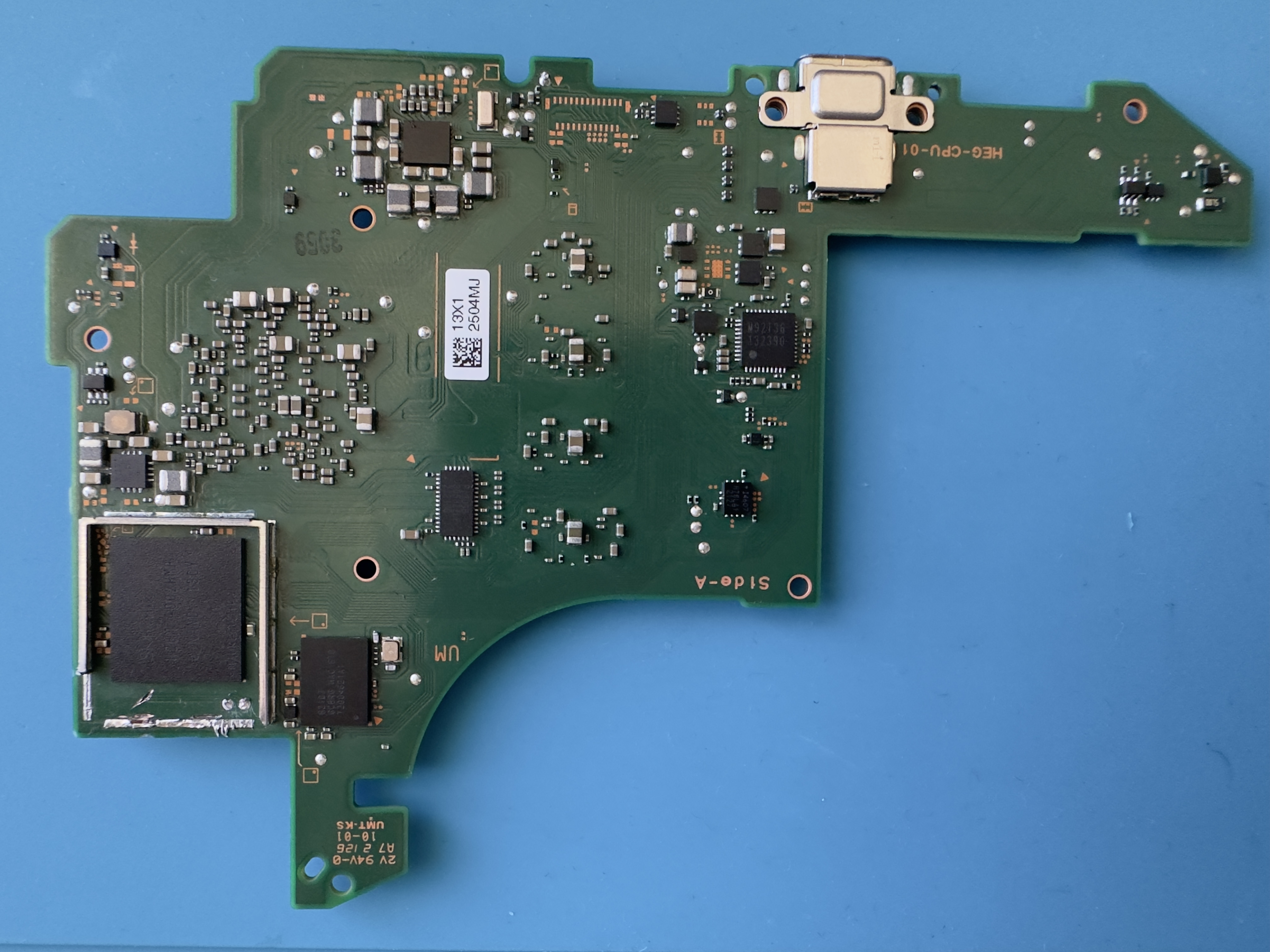

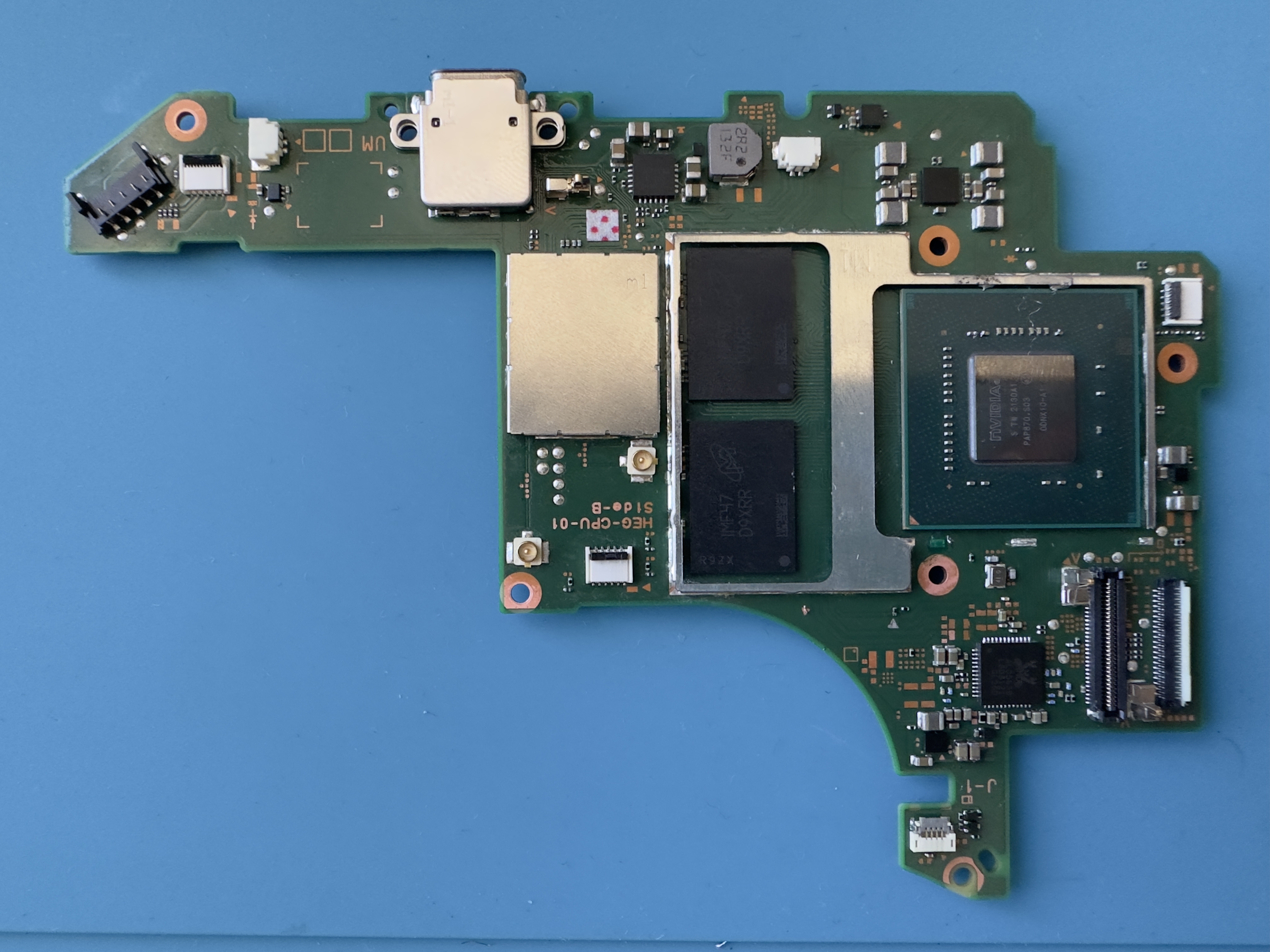

i try install to nintendo switch oled hwfly chip v5.
i had a few issues and i removed the chip.
My switch oled wont turning on.

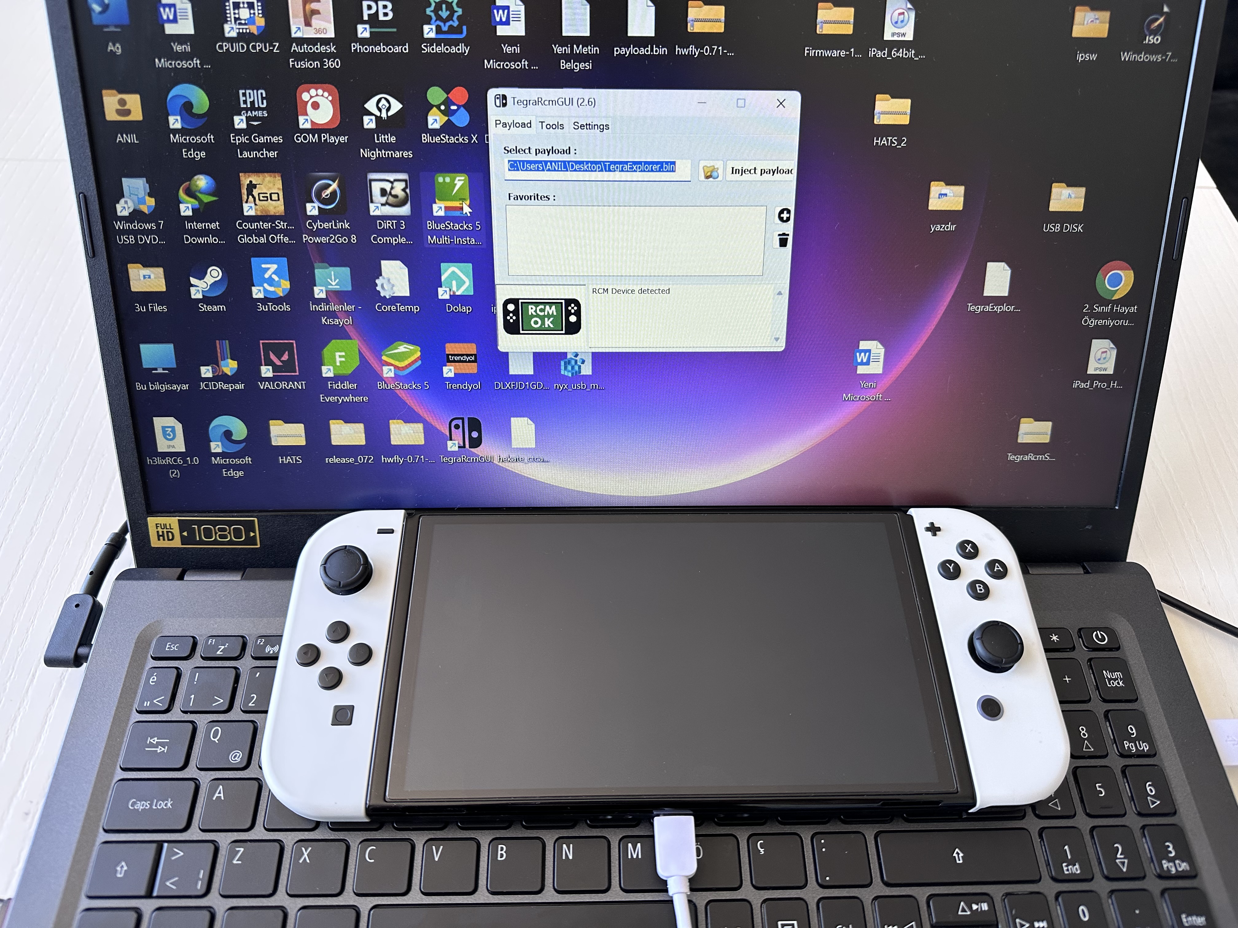

i connect to pc with usb type c and i see my switch APX mode.

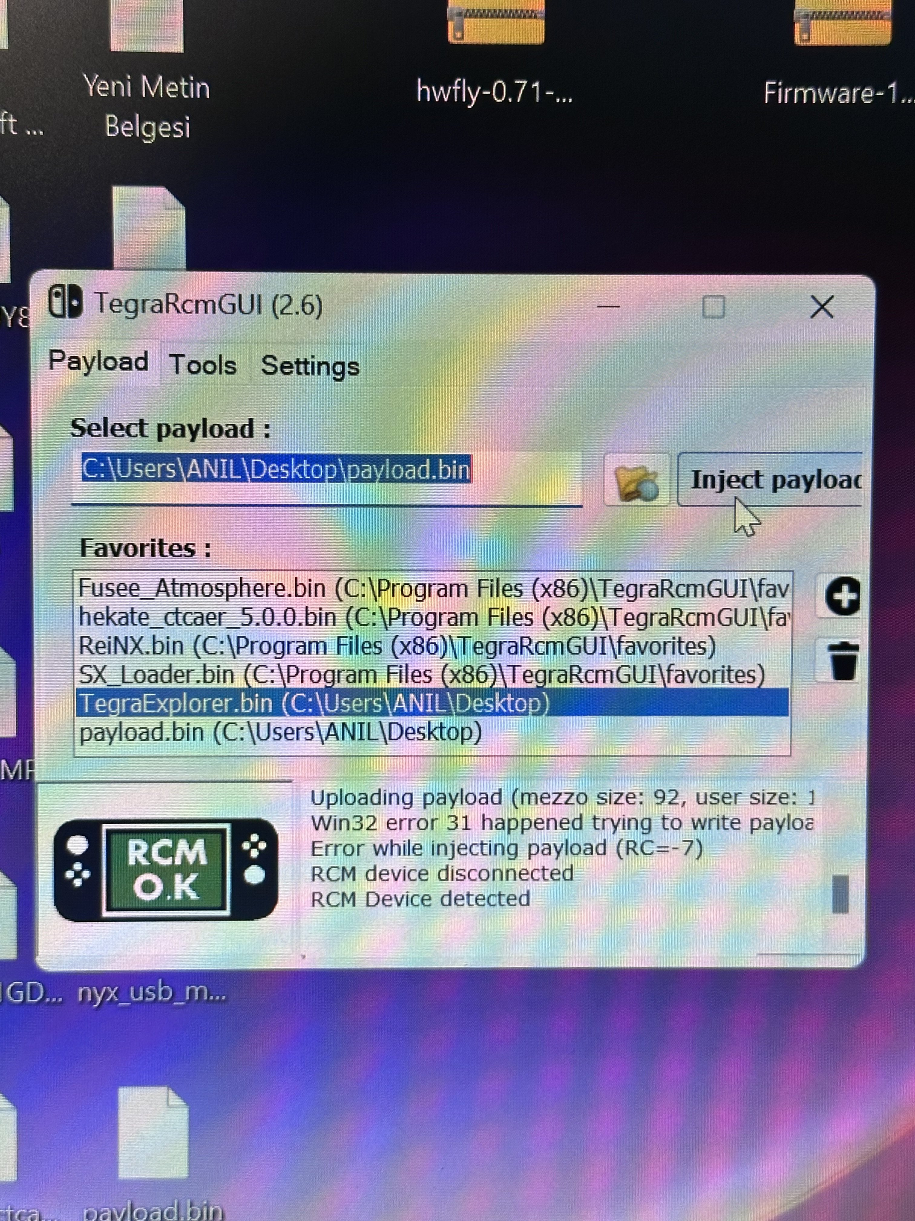

i install TegraRcmGui and i can see switch on rcm mode.
My switch can not exit rcm mode and not turning on with payloads.
is my switch brick? What can i do?

i try run payload with tegrarcmGUİ but nothink there…
whats the led light on the hwfly?
my guess is you killed cmd resistor or grounded dat0 point or even the clk
before removing the chip…
After remove device gone RCM mode. :(
You should inspect the board for damage from soldering, no point of using tegragui.
i will check. Is it possible it's an emmc error?
did you use heatgun to fix adaptor on eMMC? I suspect that there is a problem with the eMMC. Anyway I have a board that has the same issue right now so I'll keep checking and let you know :)
After remove device gone RCM mode. And i know now i bricked oled socked. :(
yes i would check the cmd resistor, it should be 4.7k it's easy to kill and misalign, it moves even with just a few jabs at 380 🤐
