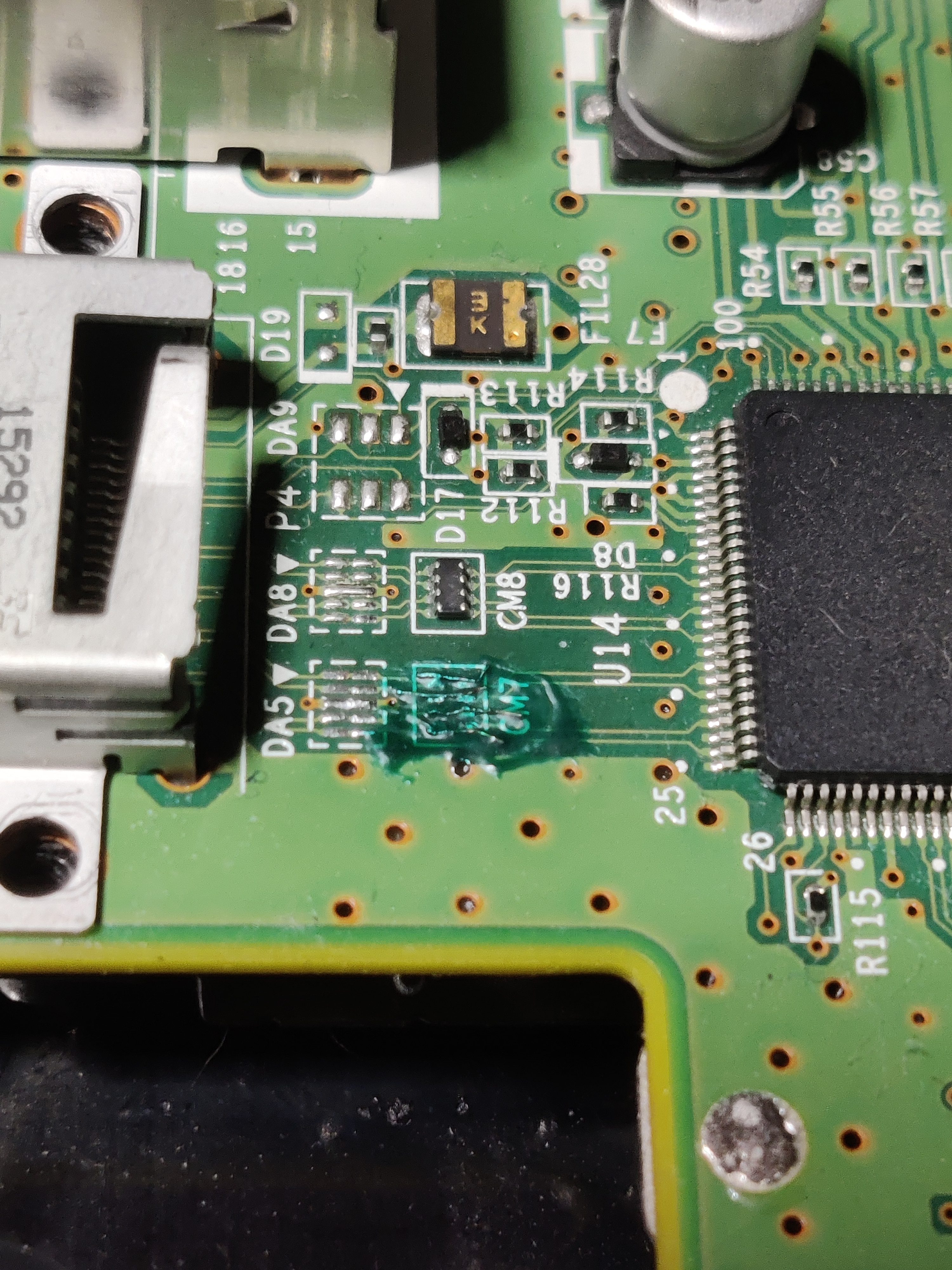

here i am with another update, today i wanted to check on my Wii U after a bit of not playing it, and again, i had no video signal, so here we go, opening the damn thing again, this time, the other filter in the HDMI line was faulty, so i had to remove it too, and add direct lines to fix it, this time i snapped some photos to show the procedure
here you can see my previous fix on CM7 already covered with solder mask, this time CM8 was failing, one of the lines didn't had continuity

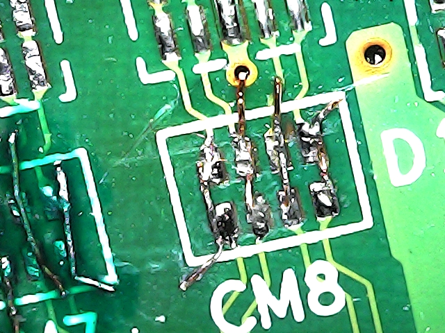

Microscope picture snapped while bridging CM8, it looks messy i know, but when the solder points are sooooooo tiny this is the best i can do with my level of expertise

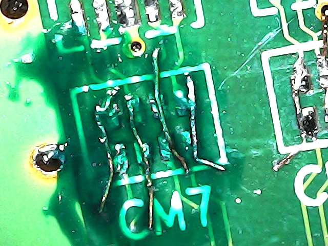

here's how CM7 looks in case people are curious, probably a bit more messy than CM8 because i didn't had the microscope or precision soldering iron i have now

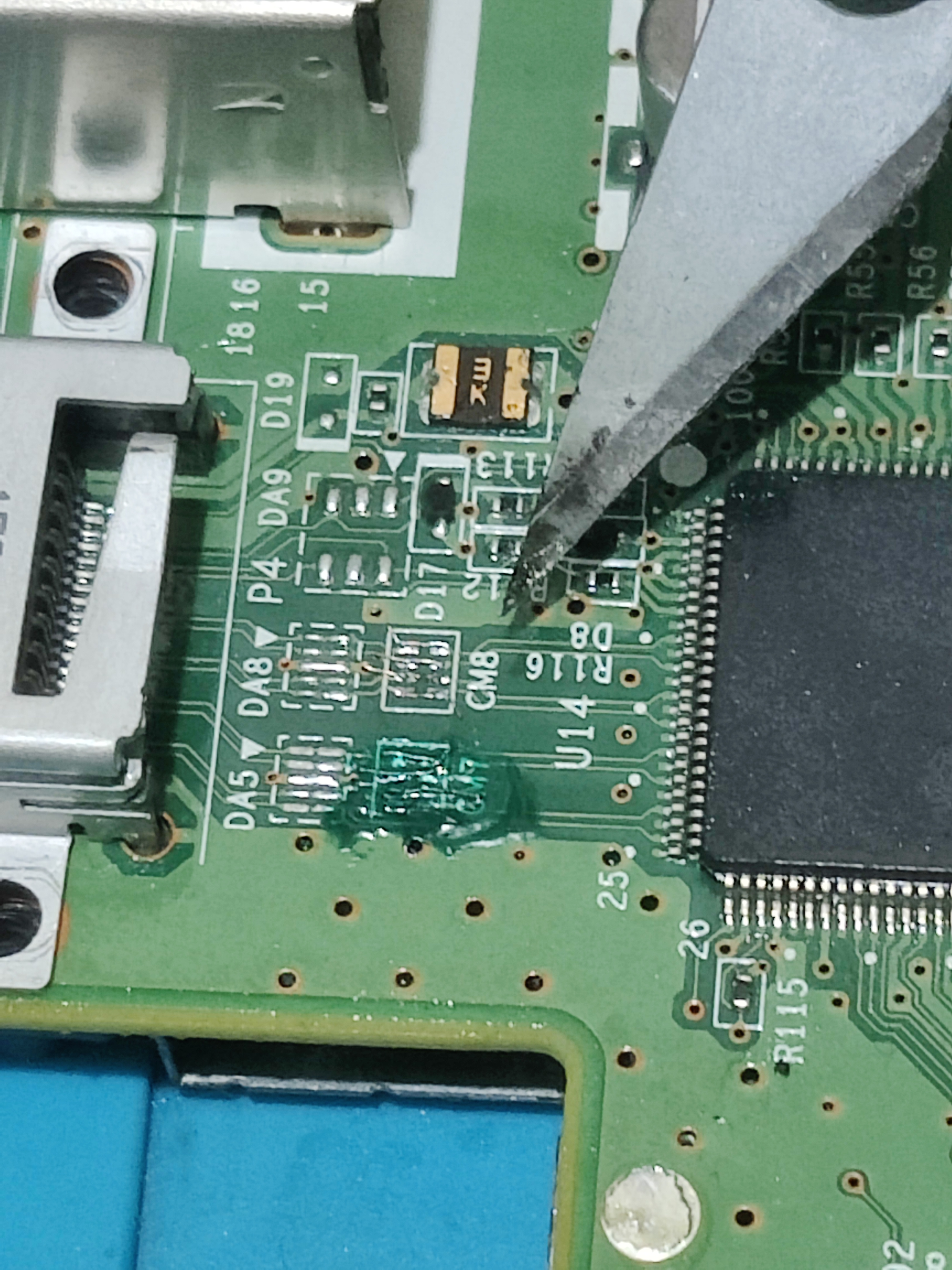

size comparison of the work site with the blade of my exacto knife, its absolutely minuscule
