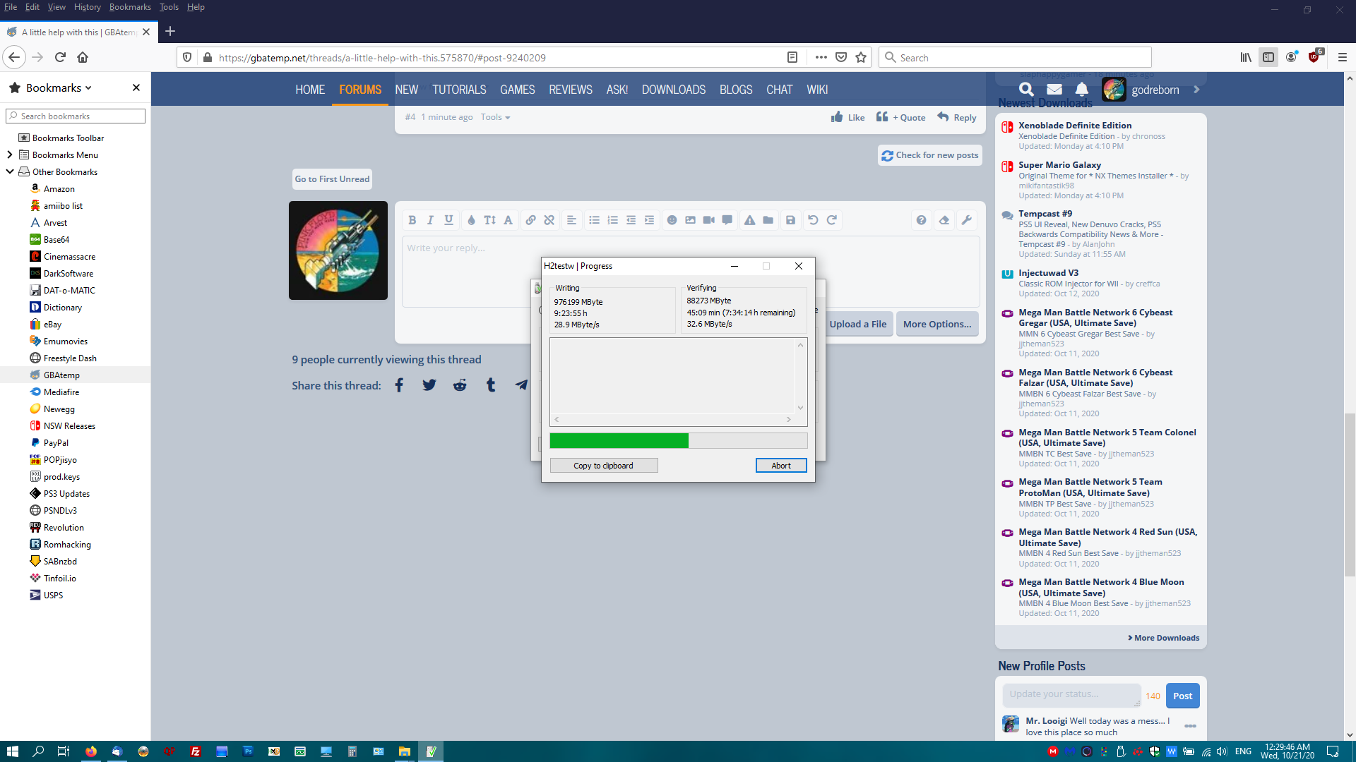

I have done the H2testw test and it concluded without errors. Still the problem manifested itself while playing. I use a micro SD card with adapter, that is just 8GB, a class 4. I will look for a class 10 and test if the error has disappeared.
