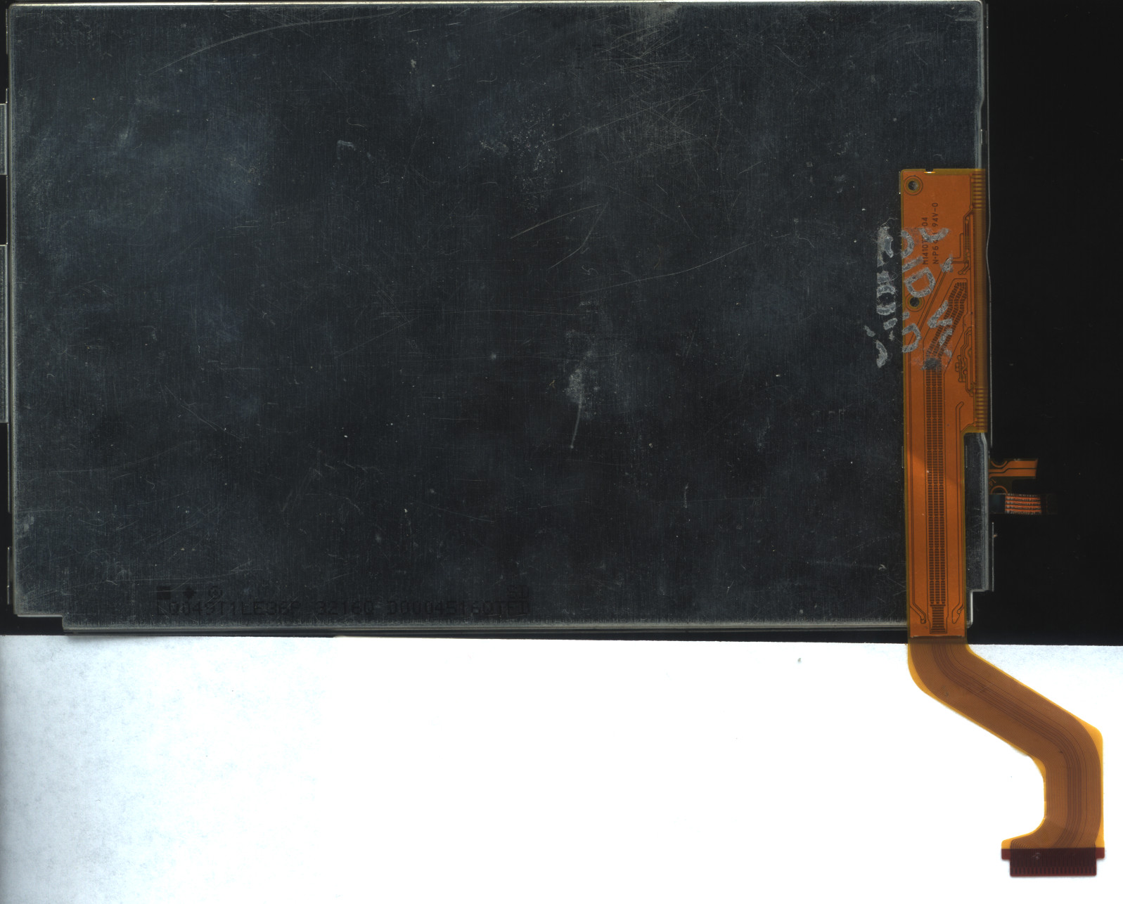

The upper screen cable has a fixed connection to the LCD which means you have to get a complete new upper screen if the cable is bad. Replacing only the cable is not possible (I know of no method to do this). Picture of a O3DSXL upper screen, LCD is completely broken, but it's cable is okay (which doesn't help me with another screen where the cable is bad):
