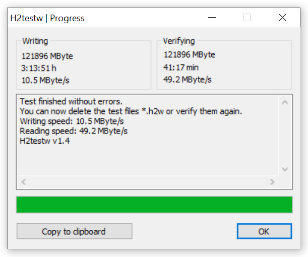

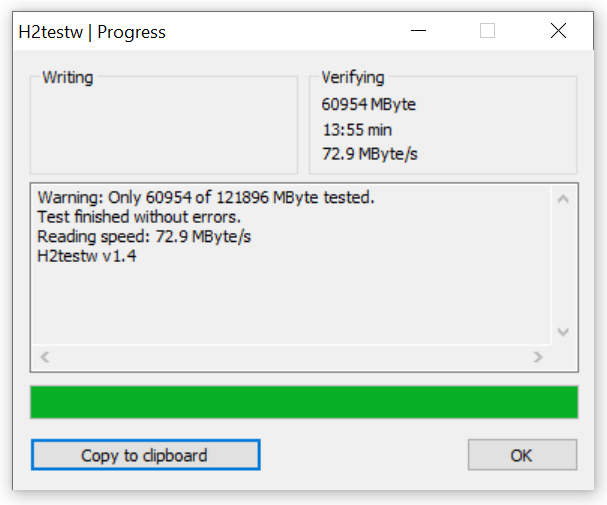

Huh, weird. The test says that there are no errors. I might have to try reformatting the SD card and test it again. I'll put the results here later...

Did you do this test with the sd card Fully Empty? If not then you will need to do so again.
You want to do a Full Write and Read set of tests to fully verify a sd card.

Oh oops. In the first test, the SD card wasn't empty.
I did another test with the SD card fully empty though. It still showed the same results:
