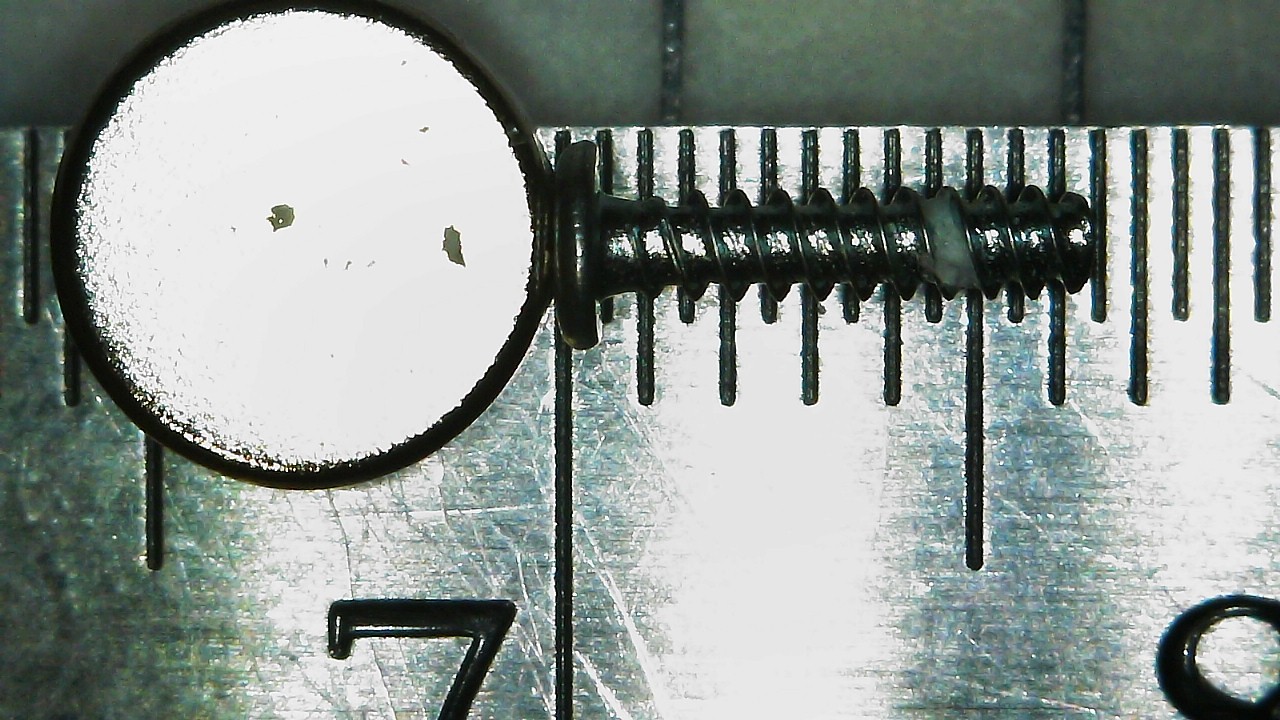

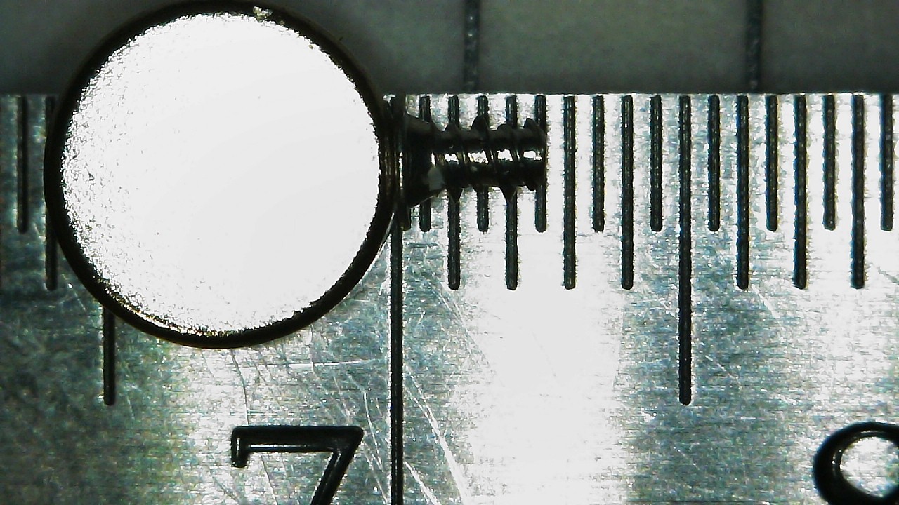

How I measured these screws.
I measured the screws on a ruler with markings down to half-millimeter increments and a digital microscope. Measurements were taken similar to this image of measuring Thread Pitch below.
(Image Sourced from Albany County Fasteners' video, How to Measure Screws & Bolts - US & Metric Sizing | Fasteners 101)
Since I do not have specialty equipment to measure screws this small, I am forced to estimate; especially on the thread pitch itself. Take the measurements with the knowledge that it was done by someone who is a novice in screw measuring.

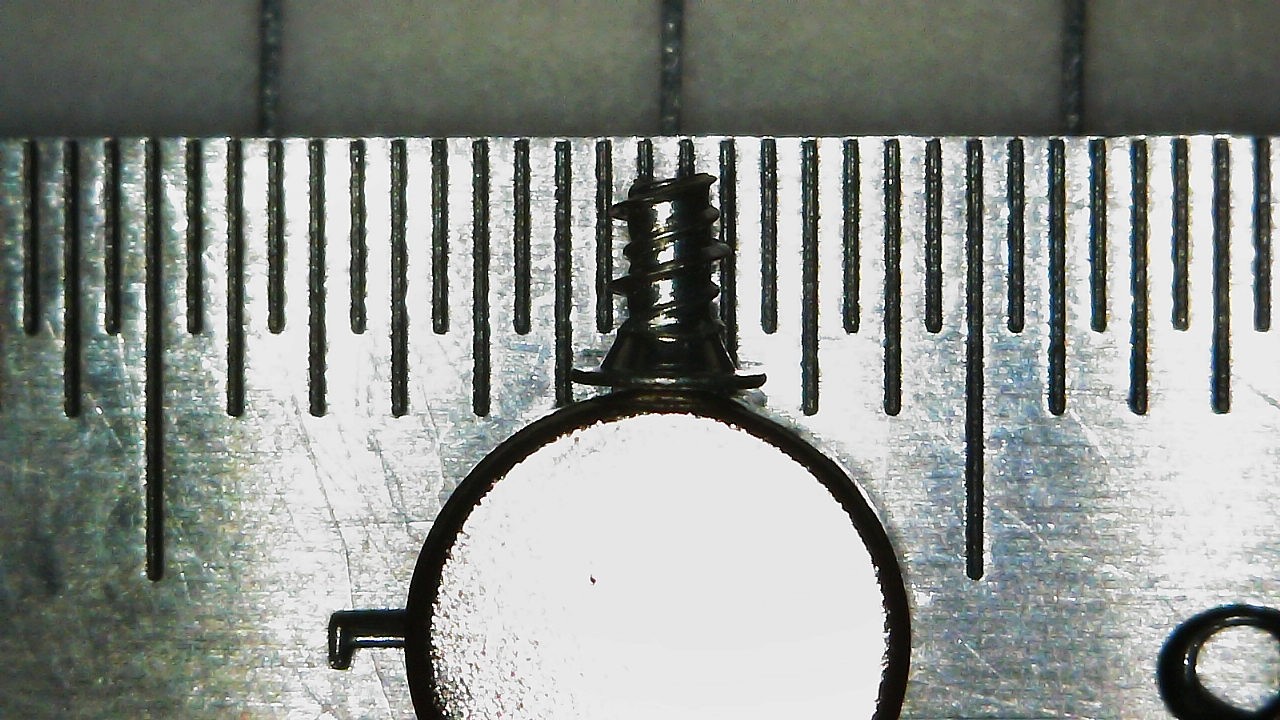

2.5mm x 1.5mm x 2.5mm
Phillips: PH #00
(2x) Rear Camera Screws (No Guide)
M1.4 – 0.6 x 2mm
3mm x 1.5mm x 2.5mm
Phillips: PH #00
(2x) SD Card Door Screws (No Guide)
M1.4 – 0.6 x 2.5mm
4mm length x 1.5mm x 3.5mm
Phillips: PH #00
(2x) Battery Door Screw (Step 1)
M1.4 – 0.4 x 3.5mm
4.5mm x 1.5mm x 2.5mm
Phillips: PH #00

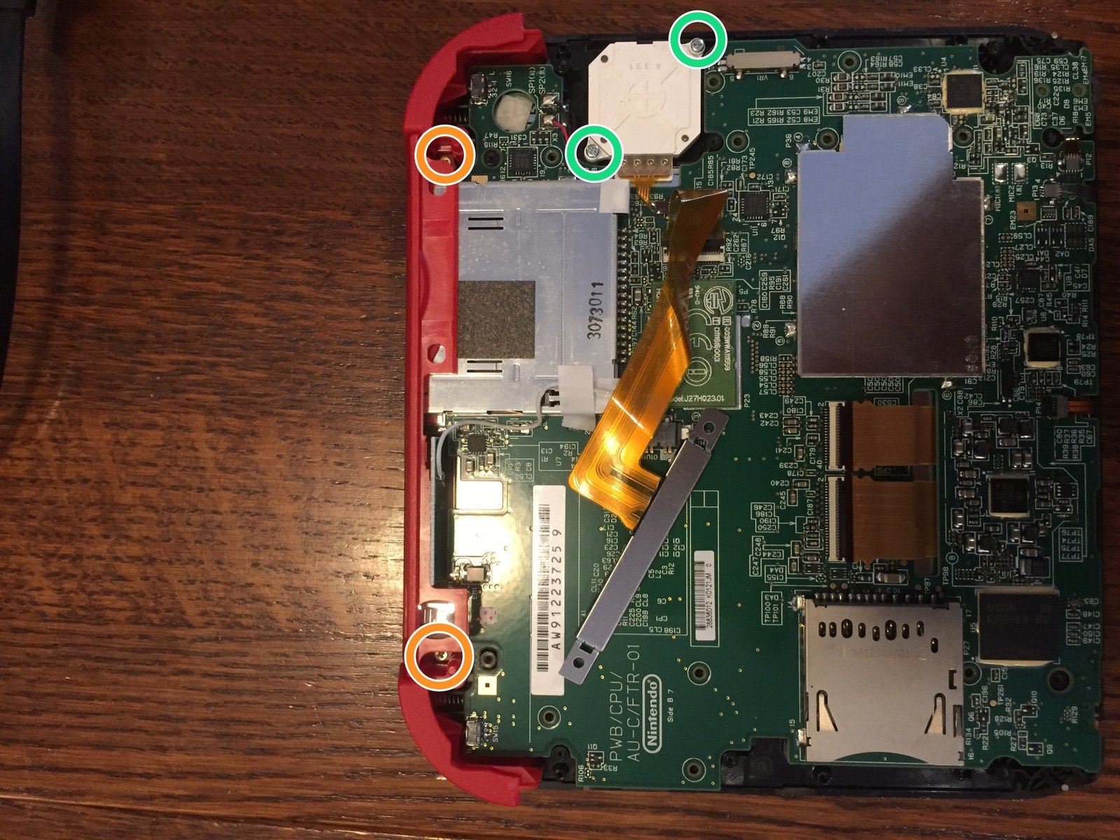

(2x) Shell piece around Charge Port Screws (Orange Circles) (Step 9)
(2x) Stylus Cover Screws (No Guide)
M1.4 – 0.6 x 4mm
6mm x 1.5mm x 2.5mm
Phillips: PH #00

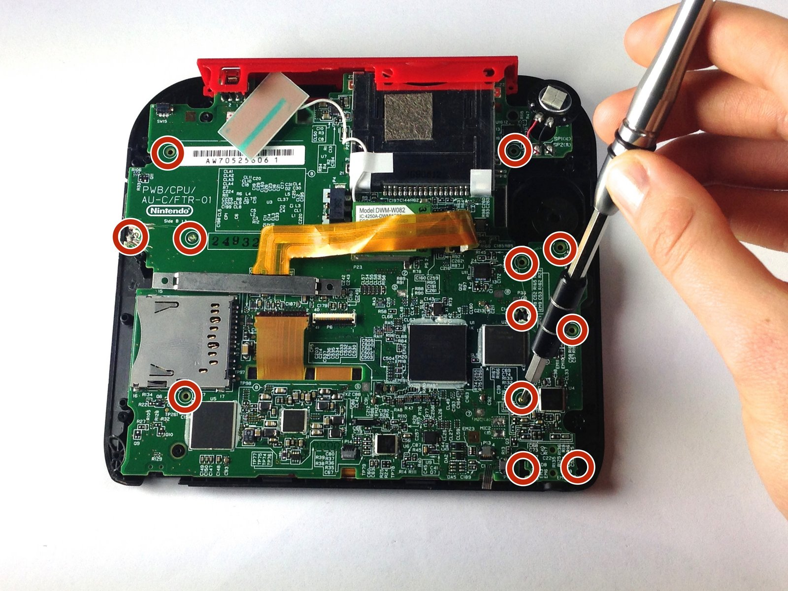

(12x) Motherboard Screws (Step 8)
M1.4 – 0.6 x 5.5mm
6.5mm x 1.5mm x 2.5mm
Phillips: PH #00

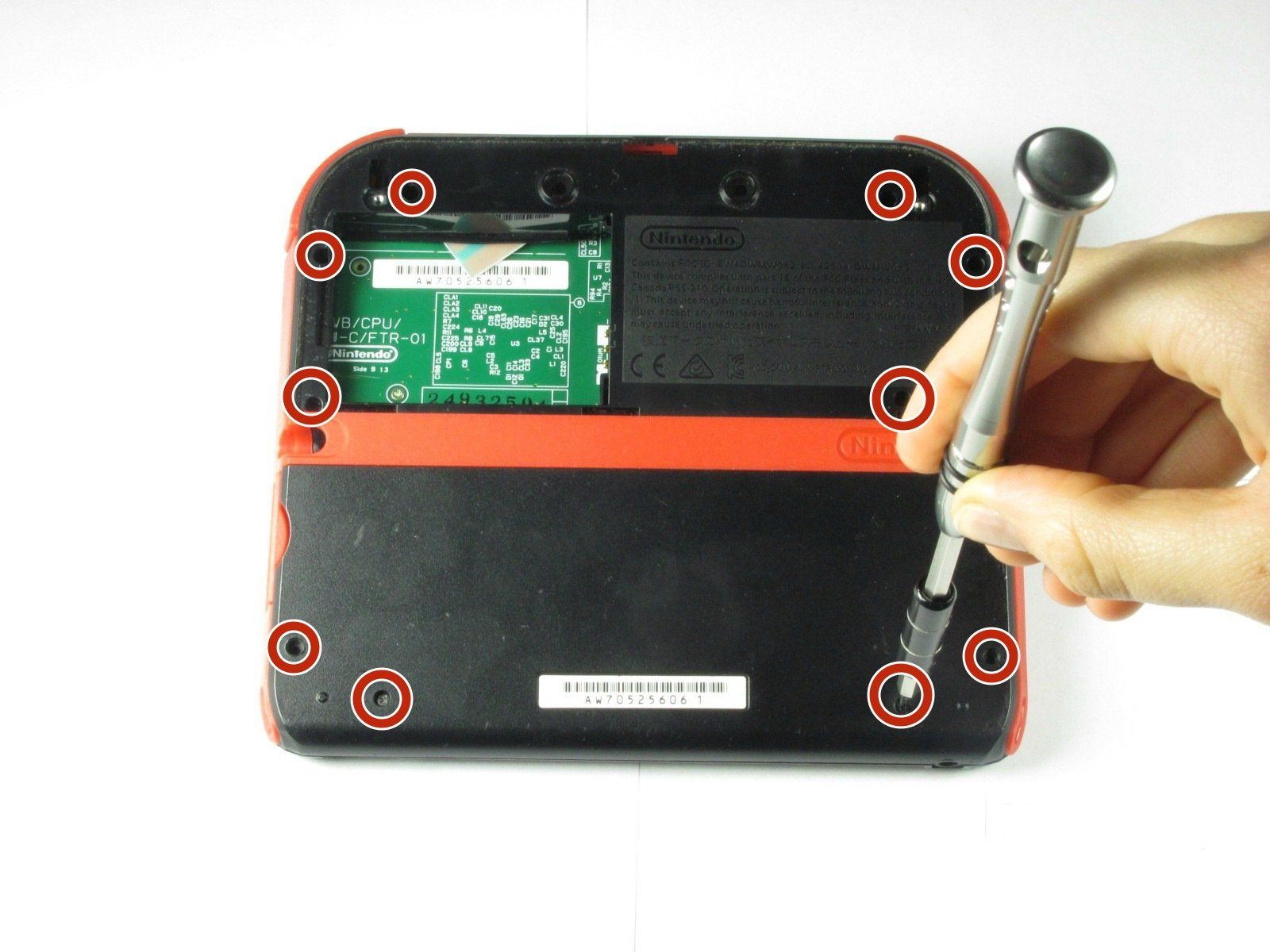

(10x) Rear Shell Screws (Step 4)
M1.4 – 0.6 x 6mm
7.5mm x 1.5mm x 2.5mm
Phillips: PH #00
(2x) Circle Pad Screw (Step 9)
M1.4 – 0.6 x 7mm

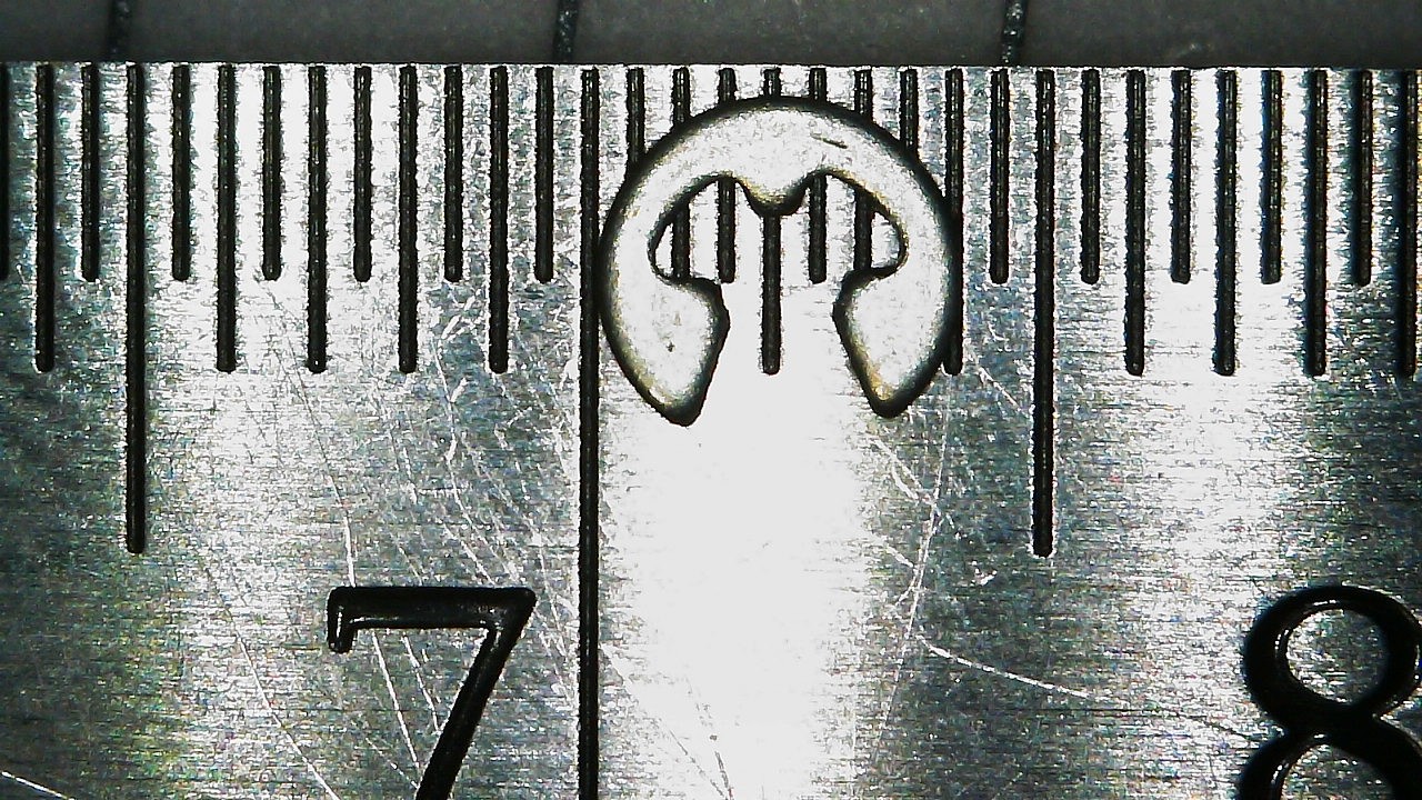

2x E-clip
4mm wide

Two E-Clips
4mm Wide

Rear Shell
Ten Rear Shell Screws
M1.4 – 0.6 x 6mm
Phillips: PH #00
Motherboard
Twelve Motherboard Screws
M1.4 – 0.6 x 5.5mm
6mm x 1.5mm x 2.5mm
Phillips: PH #00

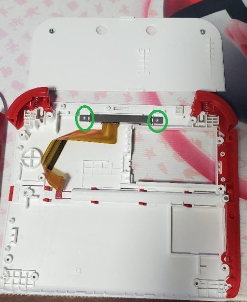

Shell Piece around Charge Port and Circle Pad
Two Screws for the Shell Piece around the Charge Port (Orange Circle) (Yeah, I didn't have a good name for them)
M1.4 – 0.6 x 4mm
Phillips: PH #00
Two Circle Pad Screws (Green Circles)
M1.4 – 0.6 x 7mm
Phillips: PH #00

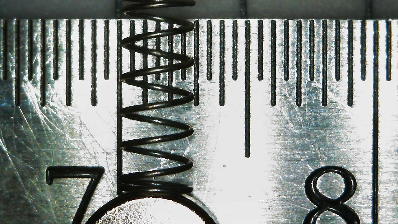

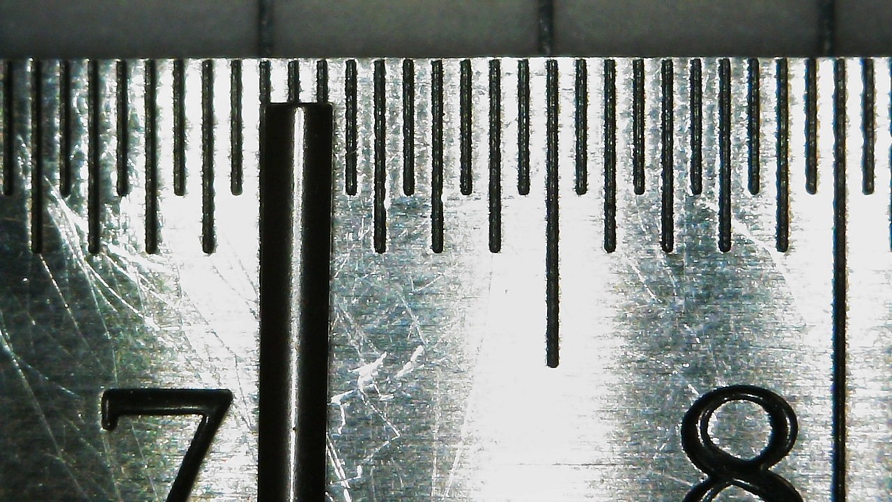

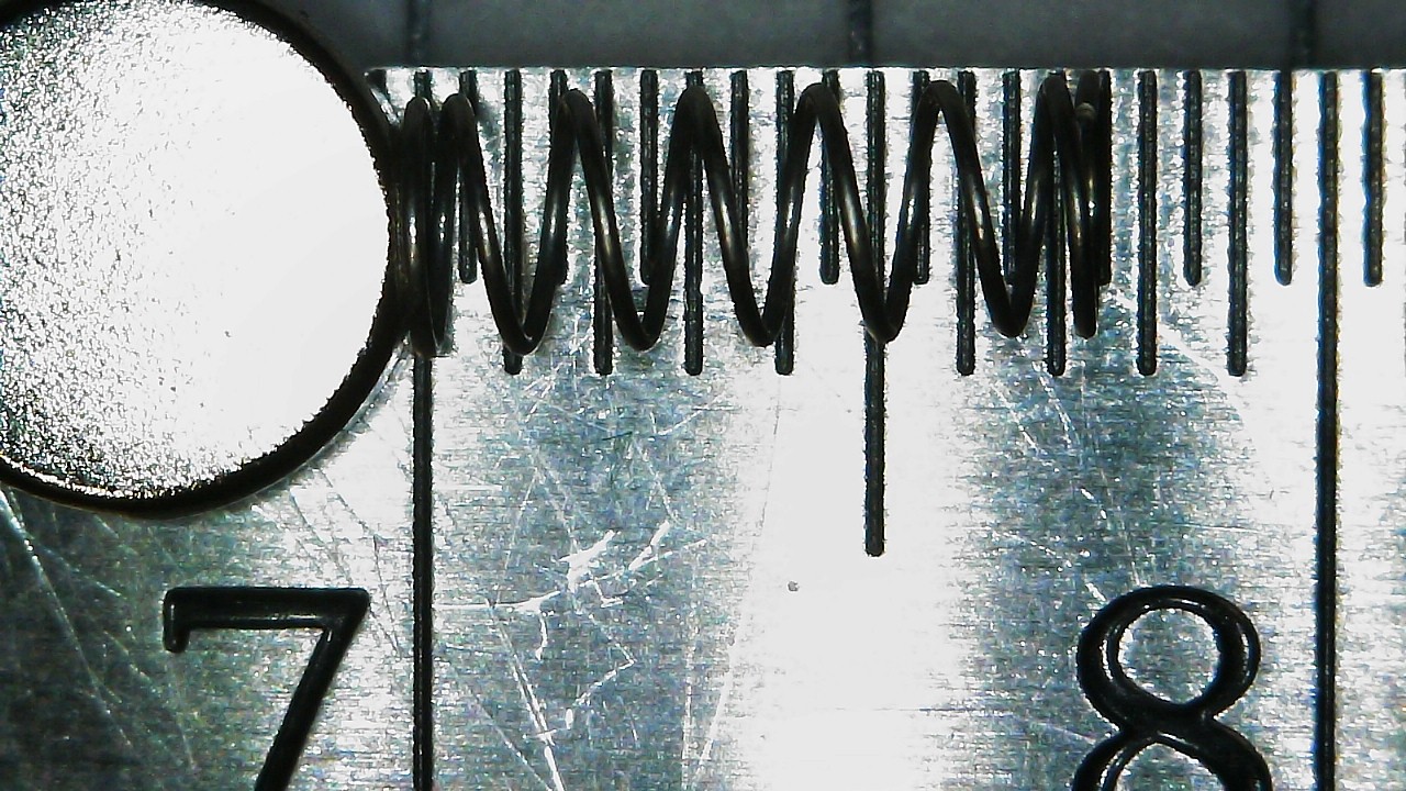

Shoulder Button Springs and Corner Posts
Two Shoulder Button Springs
7.5mm length x 3.5mm diameter
Two Corner Posts (For Keychains and stuff)
8mm Length x 1mm Diameter
