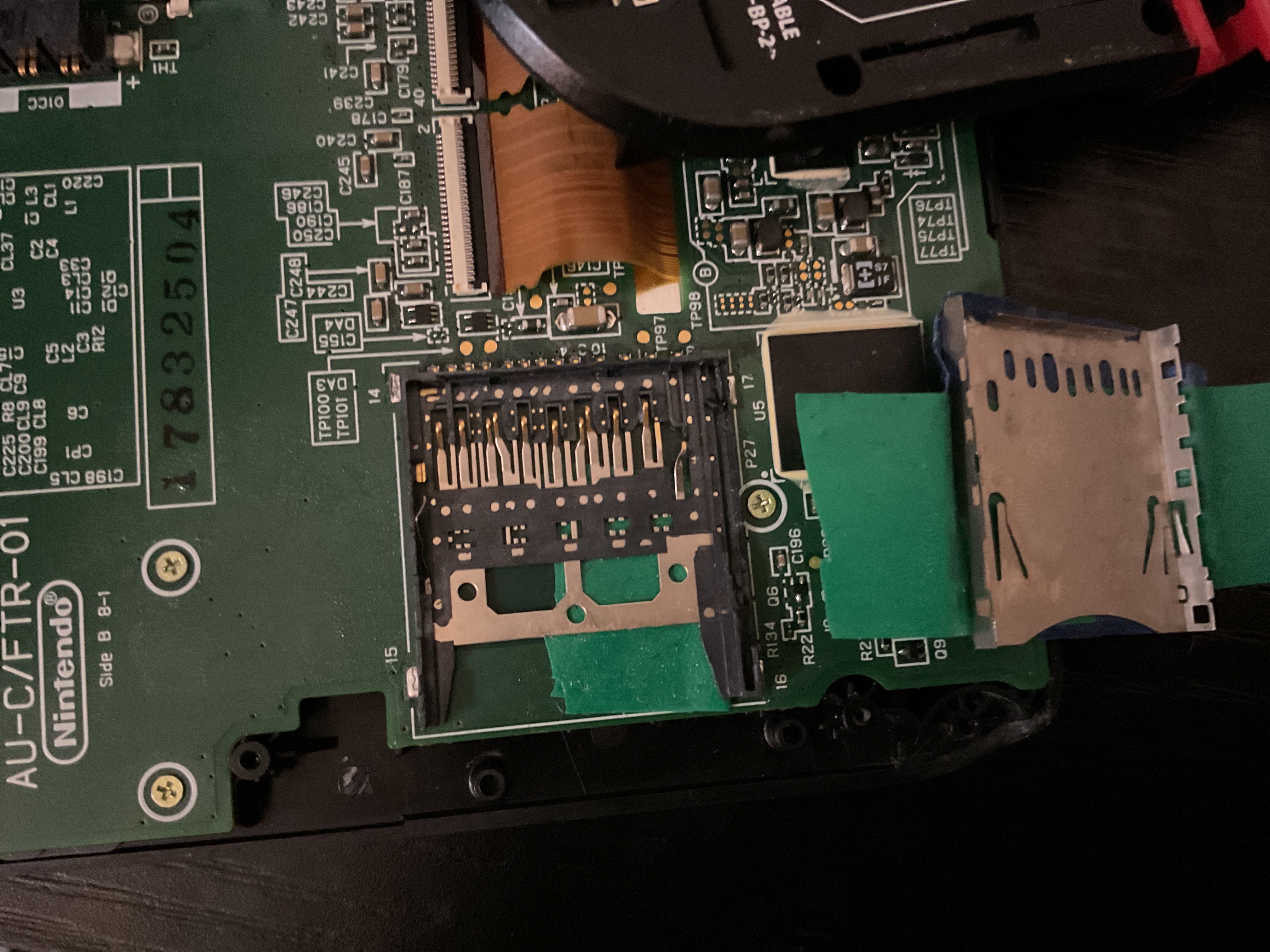

I was actually able to fix this with nothing more than a sewing needle. On the side of the slot where the write protect switch would be there is a small copper filament. This filament gets bent downward from repetitive use or inserting the sd card backwards. In my 2ds this was stuck about halfway down. I am guessing when it makes contact with the board, it reads write protection enabled.
Using the sewing needle, I was able to bend the filament back upward to the roof of the slot enough that when I slotted the SD card, it was now writable.

I just opened it up and it turns out the metal cover that tops the sad card slot has completely popped off and I’m sure the write switch thingy is above the sd card.
