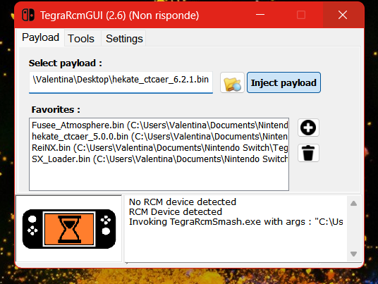

Hello everyone,
I brought the console to a repairing center, they replaced the flat 16 pin fpc connector on the motherboard; keep in mind that before this issue happened, I successfully replaced the emmc card due to the slow mode: I was able to boot into hekate. Now, if I try to boot into hekate from tegrarcm gui 2.6 nothing happens (I was able to do that before), in few words, tegra freezes and get stuck invoking tegrarcmsmash.exe.....The technician tested the console and I found it with the OWF launched so I turned it off. I am using the original nintendo's cable with the SD Card and relative hekate's folder.....What's happening guys, any suggestion?
Please
