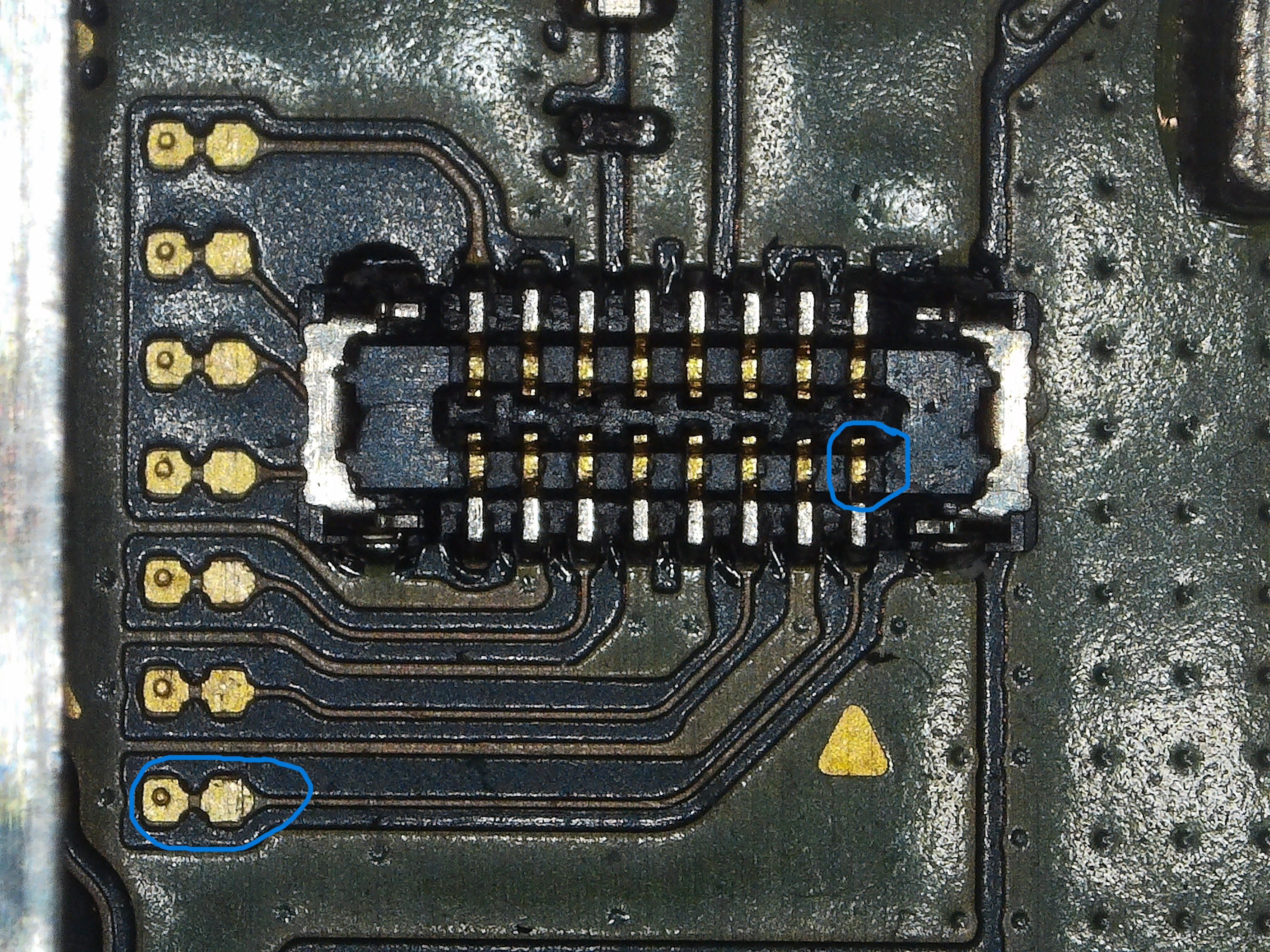

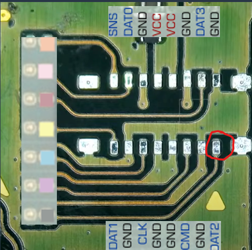

I’m new to being a DIY electrician and I’m trying to fix the 1-bit mode issue on Hekate for my son's switch. I tried to troubleshoot using a previous thread that mentioned testing the FPC connector with a multimeter. I found that the DAT2 pin is connected to GND. Does this mean the FPC connector is faulty and needs to be replaced, or could there be another reason for the DAT2 pin being shorted?
Yes, it connected to the black label point on the left, but it also connected to the GND. :unsure: I tried the other SNS, DAT0, DAT3, DAT1, CLK and CMD which none of them connected to the GND. I'm trying to figure out why this happened and looking for a fix, thanks.

Is there no damage on the SD card board or something conducting inside the SD card slot?
Is the connector itself also not damaged with the DAT2 pin having been bent to the GND that is next to it?
It could be faulty connector or some dirt under the FPC connector that started conducting.
But removing and reseating this connector requires a hot air station and the skills/experience to do that.

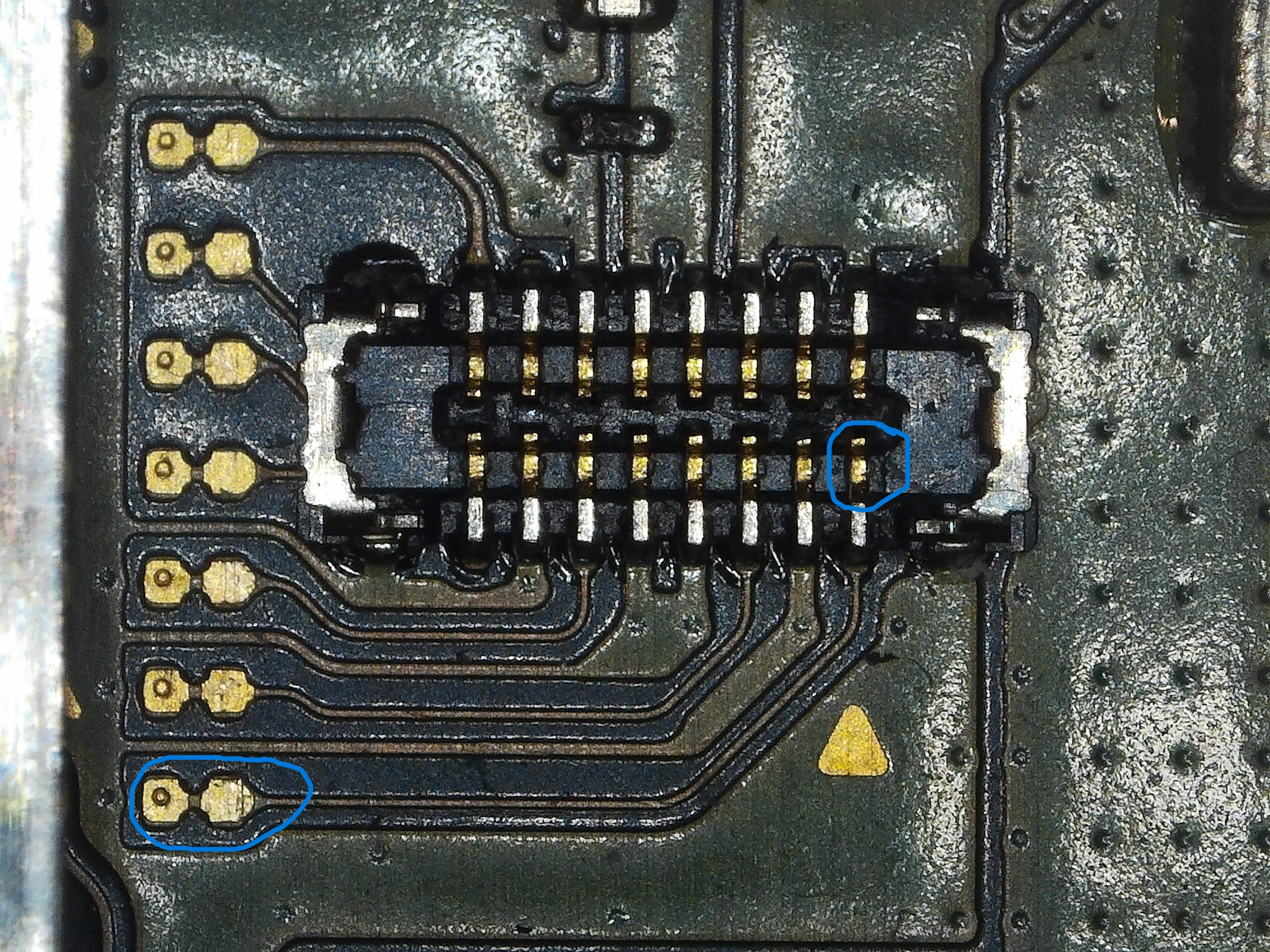

  • The FPC connector looks clean and no pins are loosing. From the picture, I measured both blue point connected to GND. :unsure:

The one your circled isn't connected to ground.
You should not test a point "connected to ground" on a assembled board because you are not measuring a connection to ground instead you are reading internal components of different chips and other devices.
be sure all left test points had continuity with one AND ONLY ONE point on the connector, then test your SD Card reader and look if any pin is missing or not connected to the correspondant pin on the reader.
