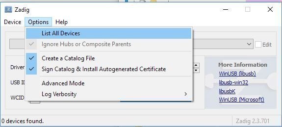

2. Download and run Zadig driver installer from https://zadig.akeo.ie/
3. From the device list, choose APX (if it's not showing up in the list, go to Options menu and check List All Devices)
4. For the driver type, cycle the arrows until you see libusbK (v3.0.7.0) in the text box (IMPORTANT!)
5. Click the big Install Driver button. Device manager should now show "APX" under libusbK USB Devices tree item.

Put your Switch with usb-c to Windows. start Zadig go to options and "List All Deviced". Does it show up? as APX (only in RCM Mode) or as "Switch" in charging Mode?
it found it,but when I press inject payload nothing shows up on screen help?
Have you installed the correct drivers for the APX device? It have to show up as APX.
