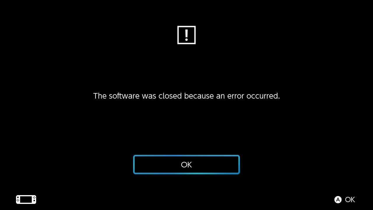

@ChanseyIsTheBest
All the compiler stages were clear, then textures got converted into ASTC successfully, but.. This error comes:
«The software was closed because an error occured»

Build log is OK:
Build succeeded with 97 warning(s) in 288.0s
  ILC output: /src/aot/bin/Release/net9.0/linux-bionic-arm64/publish/sts2_aot_root.so
== verifying output
file      : /out/libsts2.so
arch      : aarch64
type      : shared object
LOAD span : 125.9 MB   (wrapper DOTNET_SO_SLICE must exceed this)
mapped    : 103.7 MB of file, 0.0 MB debug/symbols
NEEDED    : libdl.so, libz.so, liblog.so, libm.so, libc.so
exports   : 8 defined dynamic symbols
  OK  godotsharp_game_main_init
  --  godotsharp_editor_main_init
  --  godotsharp_dllimport_resolver
RESULT: usable
Logfile /switch/sls2_nx/boot_stats.txt here:
build Aug 26 2026 14:40:39
   1225 ms  modules loaded + init arrays
   1232 ms  GodotLib.initialize
   1234 ms  main pack: FOUND
   1978 ms  GodotLib.setup (project+drivers)
Any advice?.. :)

Could you send me the layout of files on your SD card?
Take a look please, attached to this post.
Also found another logfile /switch/sls2_nx/save/logs/godot.log
Godot Engine v4.5.1.stable.mono.custom_build - https://godotengine.org
Vulkan 1.3.354 - Forward Mobile - Using Device #0: NVIDIA - NVIDIA Tegra X1 (GM20B) (NVK GM20B)
ERROR: Can't open dynamic library: libmonosgen-2.0.so. Error: .
   at: open_dynamic_library (platform/android/os_android.cpp:245)
