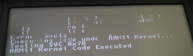

It says
Testing nop slide
Exited nop slide
Loaded adr eff83c97 for kernel 2220000
Overwriting free pointer 141a0000
Triggered kernel write
Exited nop slide
Kernel exploit set up
Executing code under ARM11 Kernel...
Testing SVC 0x7B
ARM11 Kernel Code Executed
what now, senpai?
My guess is that was a heap error or something, atm the heap is incredibly unstable. However, it passed all the tests so that would probably be an faaffaaf. Just never got to display it.

With the corrupt letters, where exactly did it get corrupted at? It could just be it freezing after ARM11 kernel entry in which case the success rate getting into ARM9 could be better (assuming that ARM9 doesn't present another set of difficulty getting in, although this one isn't as hard to mess up since it just patches functions directly).
I'm usually getting something like the top half of this:
Single letters every now and again.
The bottom half where the text is readable happens less often.
It appears to pass all the checks, but becomes corrupt for some reason and doesn't show the hex debug output. You mentioned something about an unstable stack, so maybe that?
