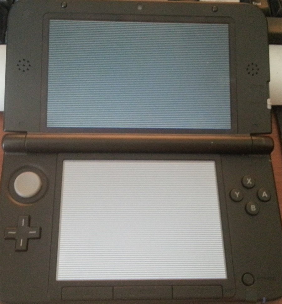

line demo? This is their cfw demo. Just dumped my nand from cubic ninja. (granted it was on 4.5 but hey)
Oh, really? If this is indeed the case, then I've read something wrong somewhere and it does not work on my unit.
I'm getting this:
yep, I'm clearly doing something, if not everything, wrong.
EDIT:
The reason I assume was right right is because of this post:
ARM9 Kernel Branch is open, you can take a looksie here. If you want to test, feel free. Payload is under data/payload.bin, just does the same framebuffer stripe murder I demoed earlier when I first got ARM9, so nothing special.
