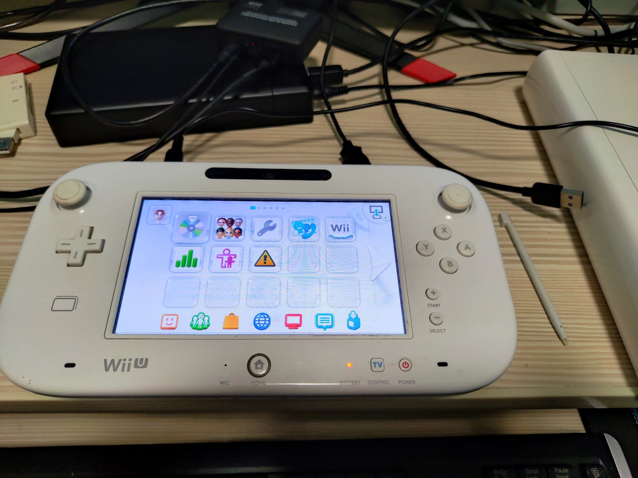

I just cannot believe it, I did exactly the same thing as you bro! Then I searched and arrived at this post, and just at the moment I am struggling at the "recovery menu" things,
I managed by purely chance and solve this problem! NO recovery menu, no pi pico NEEDED!!!
To anyone also arrived by searching in the future:
Here is the solution if you: brought a JAP Wii U, modded it with tiramisu, changed the language to ENG (or anything other than Japanese) and made a factory reset, and find yourself stuck at the booting, without see the Wii menu after an hour's waiting....again, man what have we done to deserve this ?!
Note: Not sure if step 2-3 is required, maybe you just need step 4, as I have recovered from this issue I cannot test it again, just try it out.
1.Force power the console down by holding the power button on the console for 4 sec
2.Hold X while boot the power button on the pad to enter the bootloader menu
3.Choose installer--Check--boot option--Wii U menu

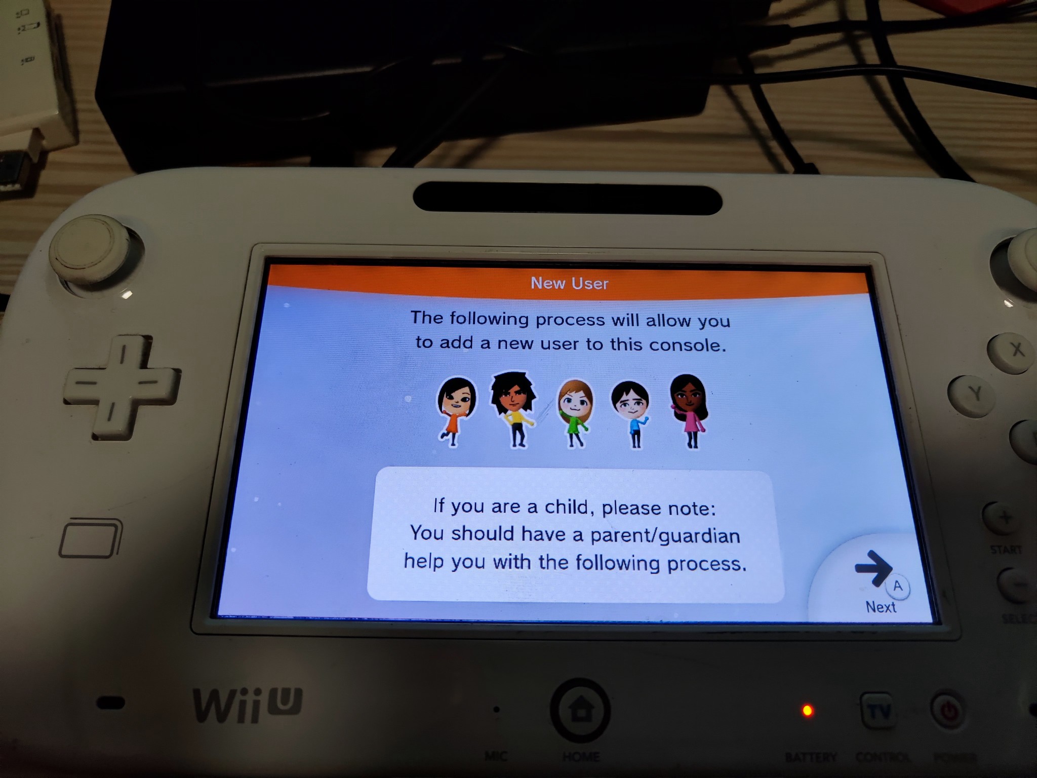

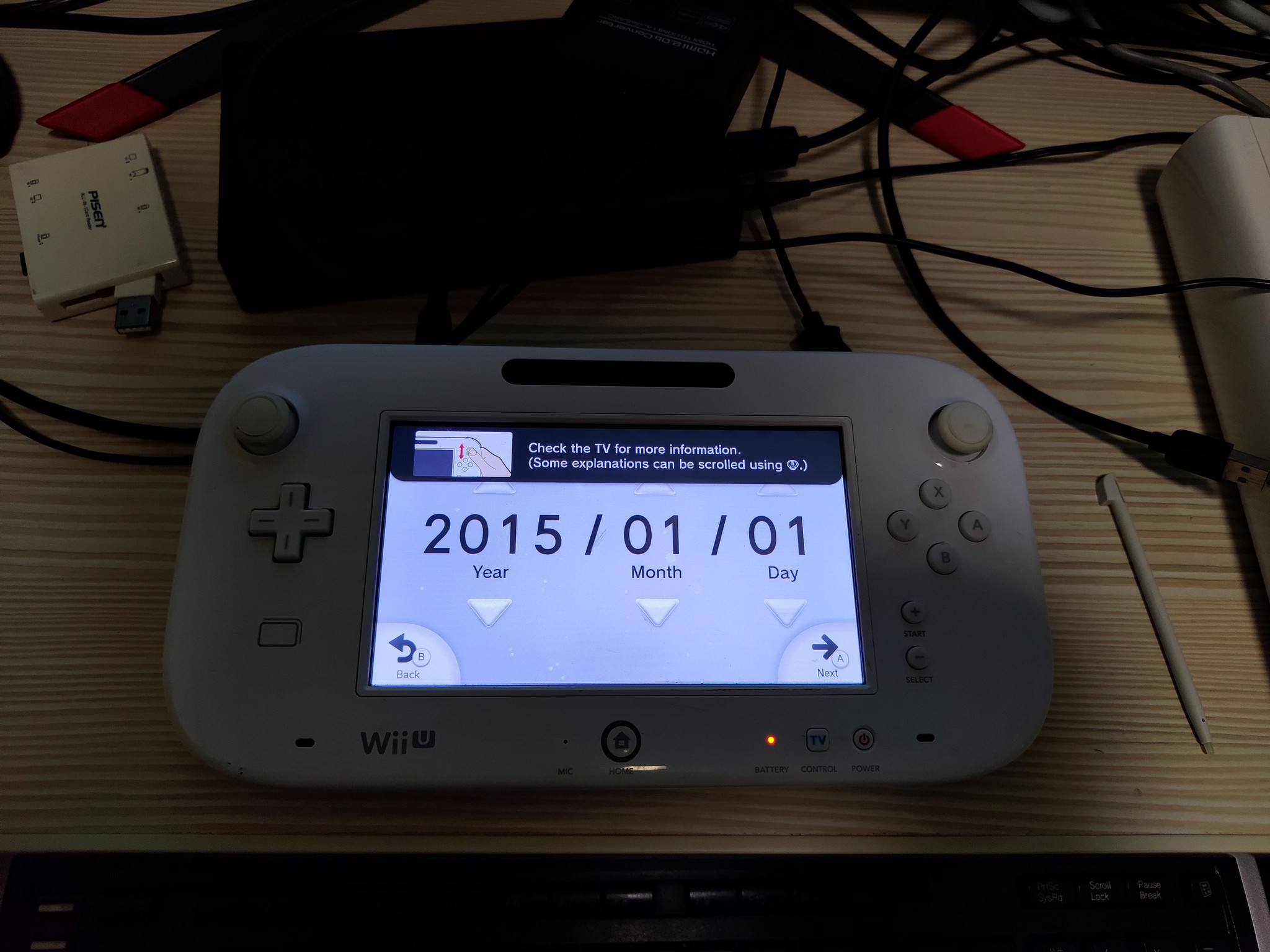

4. After another reboot, you will find your self still stuck in the "bubble" screen without Wii U menu, but here comes the magic:
TOUCH the lower right part of the pad screen, yes it shows nothing but just TOUCH it, you will hear a sound and VOLA!! The time/date setting screen will show up!! I cannot recall the exact screen location, just try blind touching several times!
My guessing is the " launch wizard" actually is on the screen it's just not being displayed due to the language change, but you can still interact with it!
And the rest steps are all good, minus some Japanese mixed but you can bear with it I am sure
And finally we are back to the menu, AGAIN!! Let's celebrate for no need of pi pico (I actually owned two zero Ws and one Pi3B+, but have 0% intention of digging into the recovery menu thing, no, never)~~~
And just discovered one perk of factory reset: All garbage official channels were gone! We have... maybe some extra MBs at our disposal on the NAND
