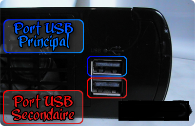

have you tried plugging your external hard drive (fat32) vwii into the back of the wii U and the other external hard drive wii U plugged into the front?
look at the back of the wii U on the hard drive connection with the main USB cable:
if your external hard drive vwii is plugged into the secondary port ==> it will not work.

i only have an external hard drive (formatted wii U) with wiiU games and wii game injection, and it is connected to the front of the wii U ===> it works perfectly.
It sure works, furthermore in my case it is the only way HBC and vWii apps could be loaded from vWii USB drive in dual drive setup.
I have no problems when only one drive is connected to WiiU. In single drive setup I could use any iOS/cIOS. I am looking for universal working solutions for dual drive setup.
Yes, I’ve tried it and every other possible combination. My goal is to be able to run HBC and any other vWii app from a USB drive, as could be done with a normal Wii, and in a dual-drive setup. So far, the only working setup I’ve found is having the Wii U drive in the top back port and the vWii drive in the bottom back port. I’ve also changed the apps and game IOS to use cIOS base 58 in slot 251.
The problem is with Wiiflow, because the game’s IOS can’t be globally forced to slot 251 for every game, as is possible with USBLoaderGX. In Wiiflow, I would need to change the IOS for each game individually in its settings.
