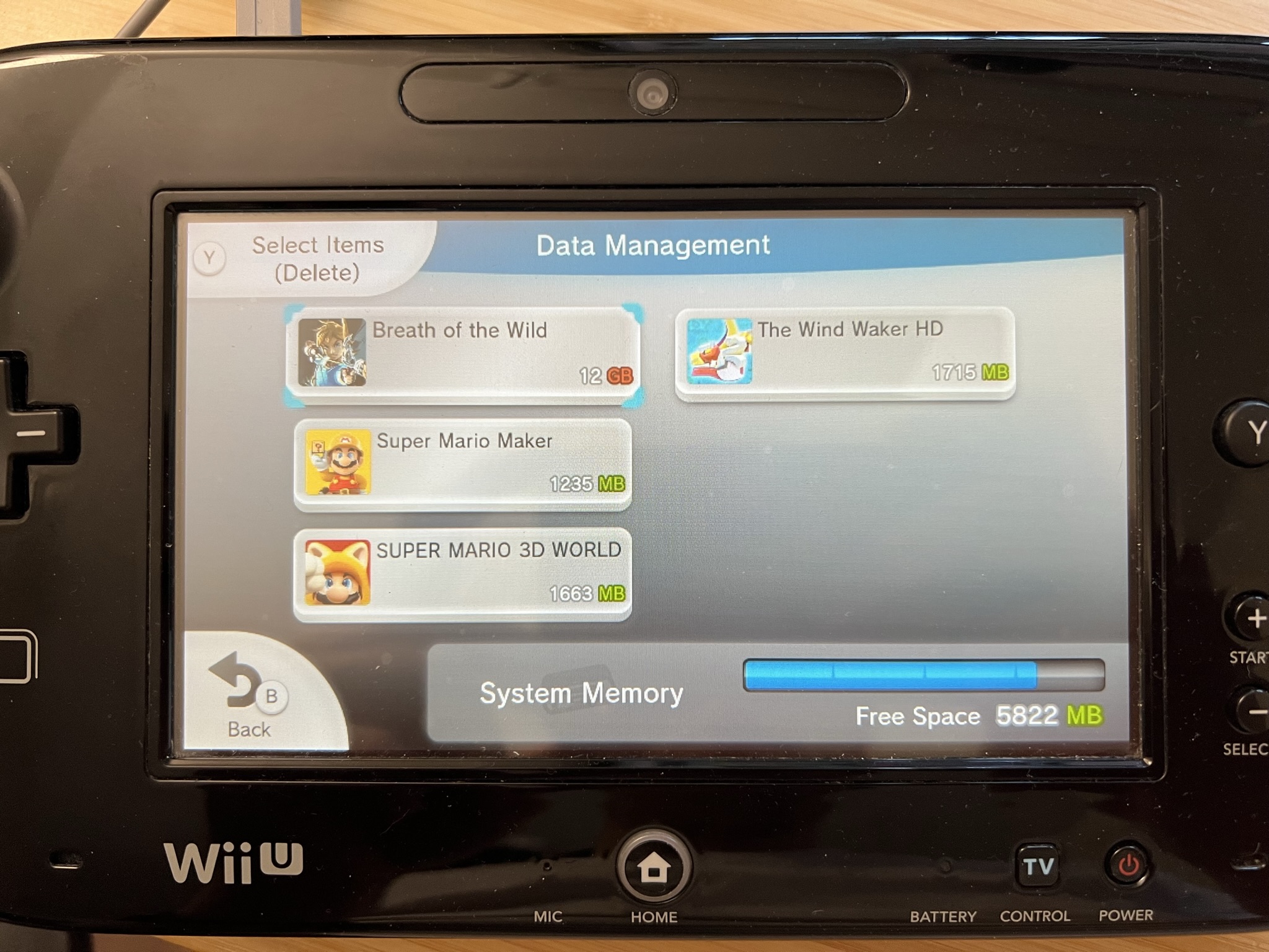

does the data management work now?
Running a mlc_checker now just to be sure. I'll check the data management once it's done. Seems to be taking longer now that I've installed some games.
Finally finished and looks the corrupted directories are out of the save directory!!
but it's still hanging at the `Preparing...` screen.
Maybe later today I'll try uninstalling those titles using wupclient? or maybe reinstalling them? I see now that `00050000/10102000` was Nintendo Land, my bad, I didn't realize that's why you asked, interesting how the game and saving worked last night. I supposed I lost the save for now, but all good, one night of play lol. The others are Wii Fit U and Notifications.
SUCCESS!!! I went back in, using wupclient I deleted a bunch of titles and saves that were there from the previous owner. I also reinstalled the Notifications title, 00050010-1004D100, and I can load the Data Management now!!!

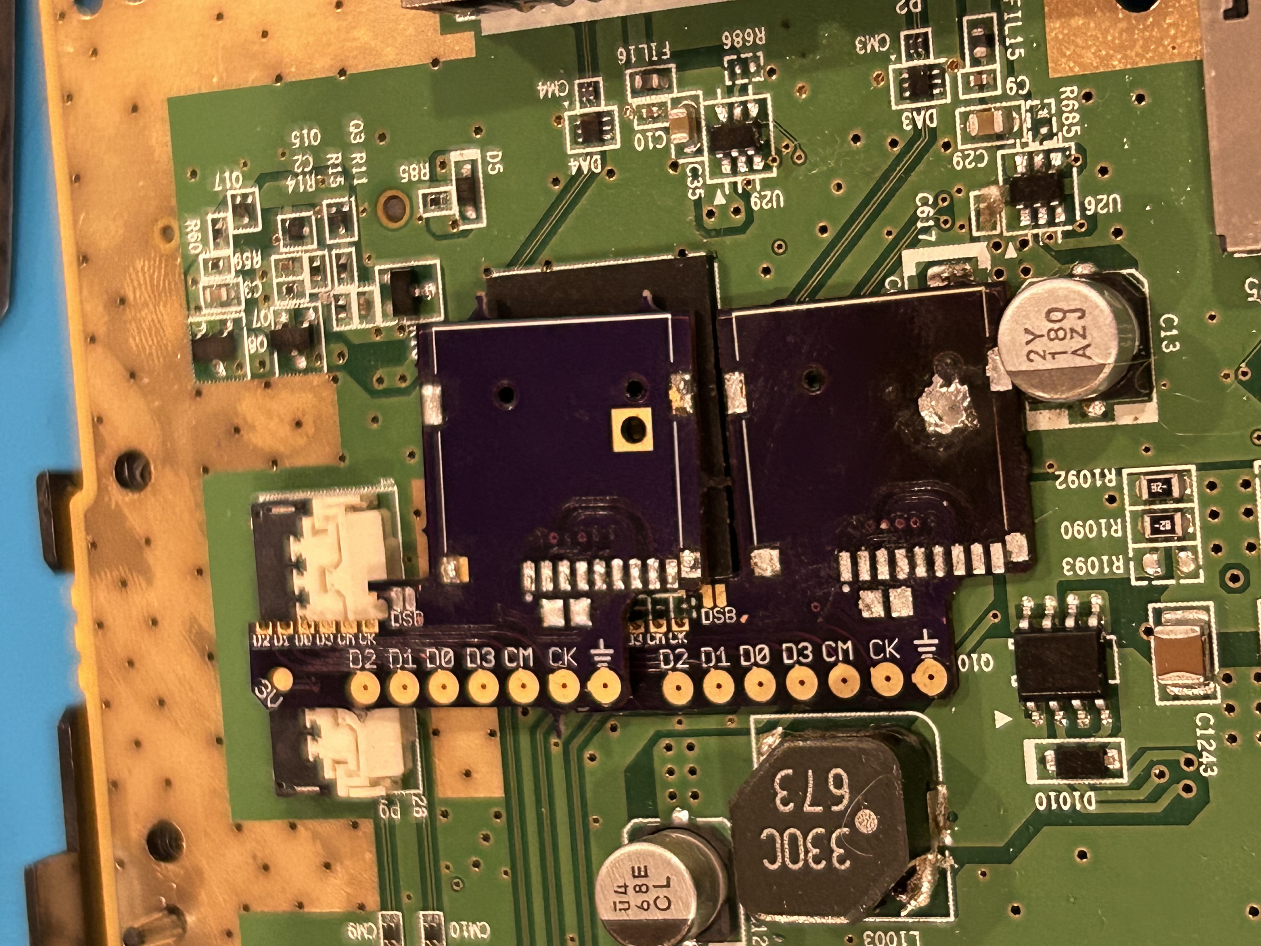

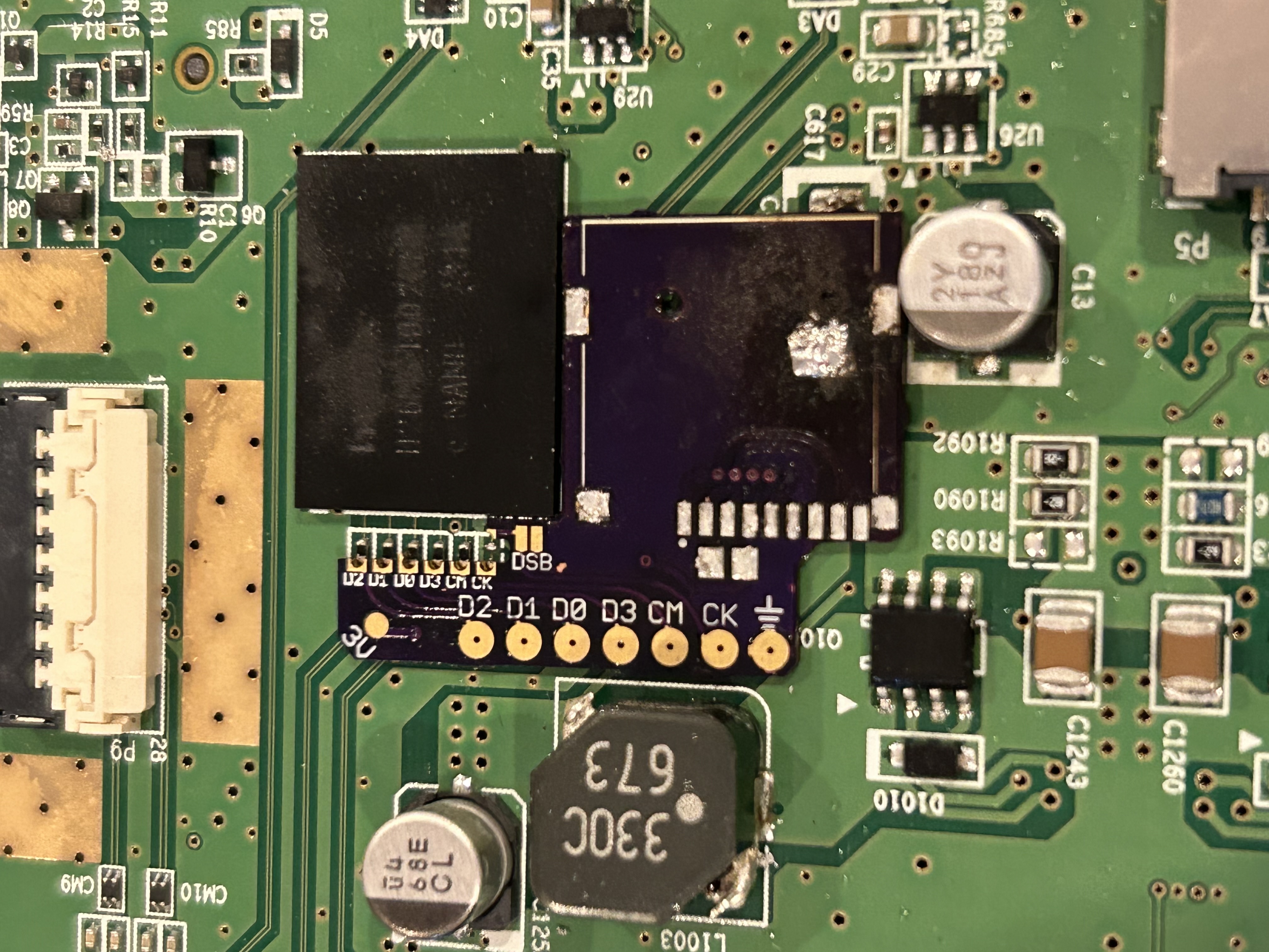

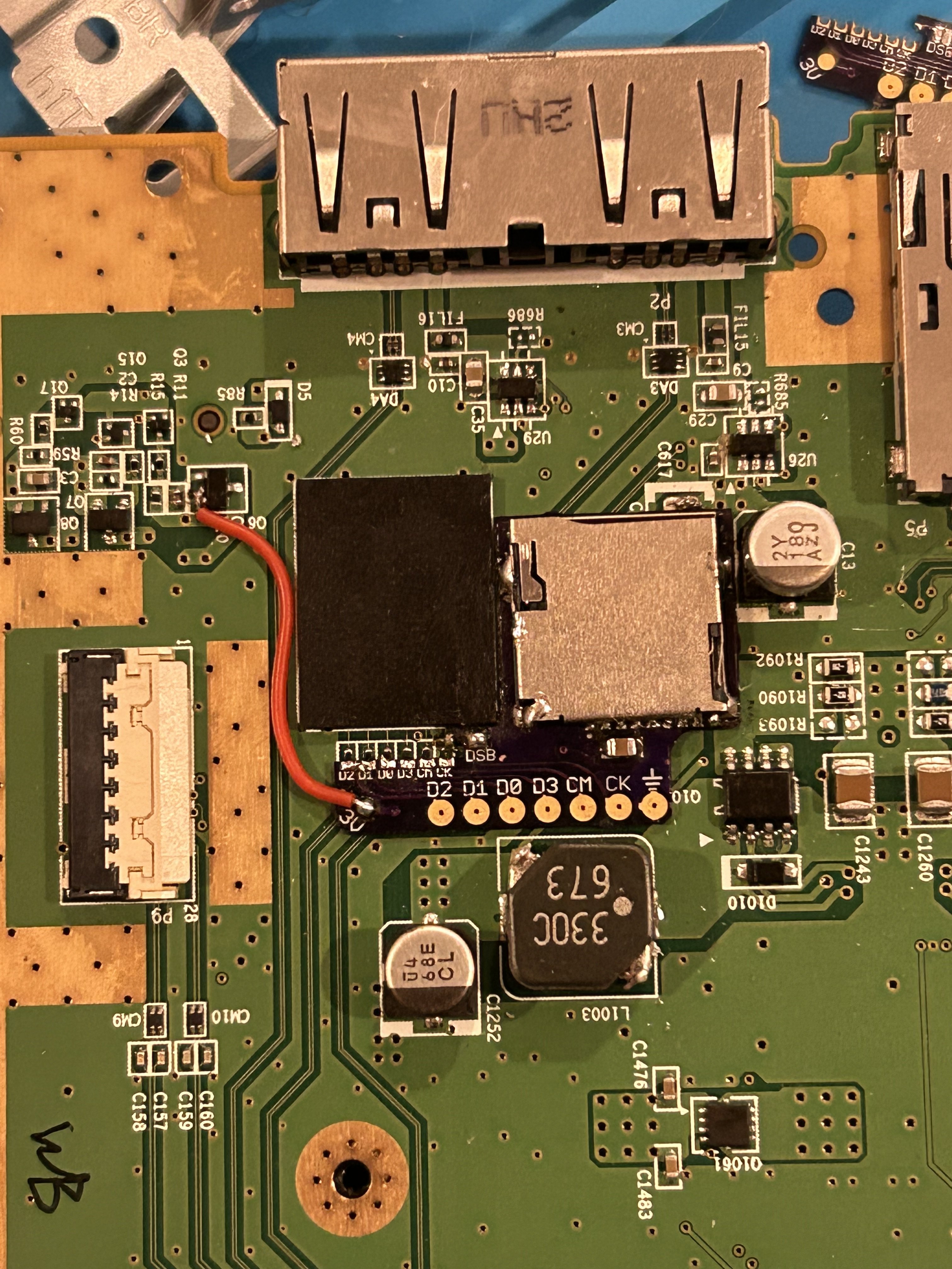

Just wanted to give an update. I successfully soldered the ground connection for the NAND-AID. I didn't need to use hot air. I plan on detailing what I did later or on the NAND-AID thread.
I finished the rest of the connections and tested them with a multimeter. I just wanted to have someone double check my installation (particularly the 3V3 wire) and see if it looks good to go.
Edit: Is it important for the 3V3 wire to not be running over the gold plane next the the ribbon cable connector? If so, I can easily tape it out of the way.

Looks good to me. With the 3V3 you just to have to be careful to not short on any of the VIAs near the the transistor. But from the picture it looks good.
I just tested out the console. When I try to power on, the light turns blue for a second and then blinks red. No picture on the TV. Any idea what might be happening?
Thats strage. If it were a mlc problem the LED should just stay blue. Red blinking means something more basic is failing.
Did you unplug any of the wifi or bluetooth adapters?
Can you check if any of the signals for the mlc are shorted toghether or to gnd? Especially the CLK on the SD slot. CLK is the 4th pin from the right.
I wouldn't plug in the Disc Drive at all at this Stage. Only plug it in when we get to the point where the Wii U throws an error and demands it.
It very well could be the disc drive. As for checking for shorts, I was pretty thorough with my multimeter. Let me take a look at the disc drive first before I check for shorts again.
Edit: Should I unplug the ribbon cable from both the disc drive and the board, flip it around, and then plug it back into both. I did unplug it from the drive to check something and lost grip of it, so it very well could be in backwards.
