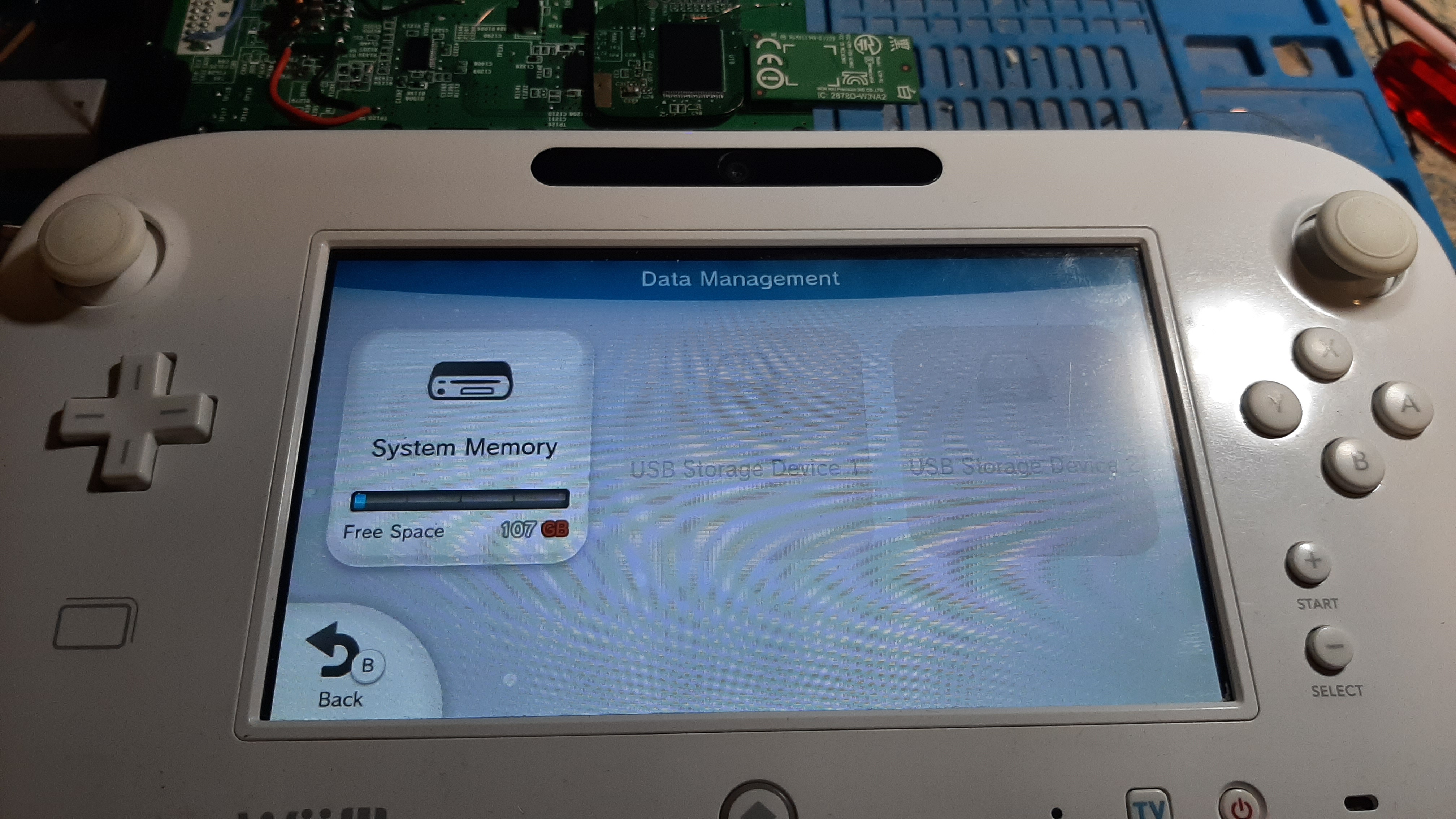

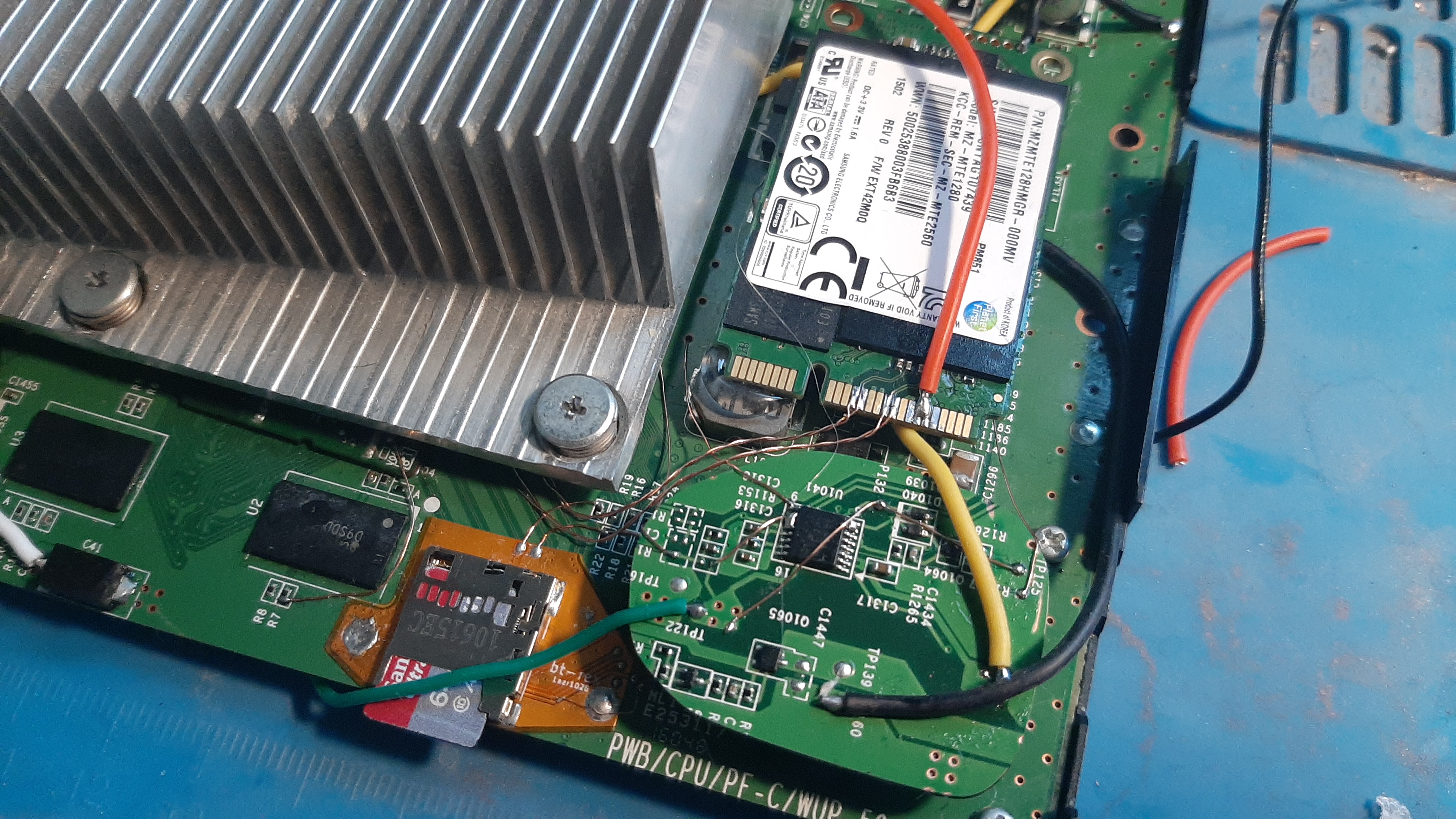

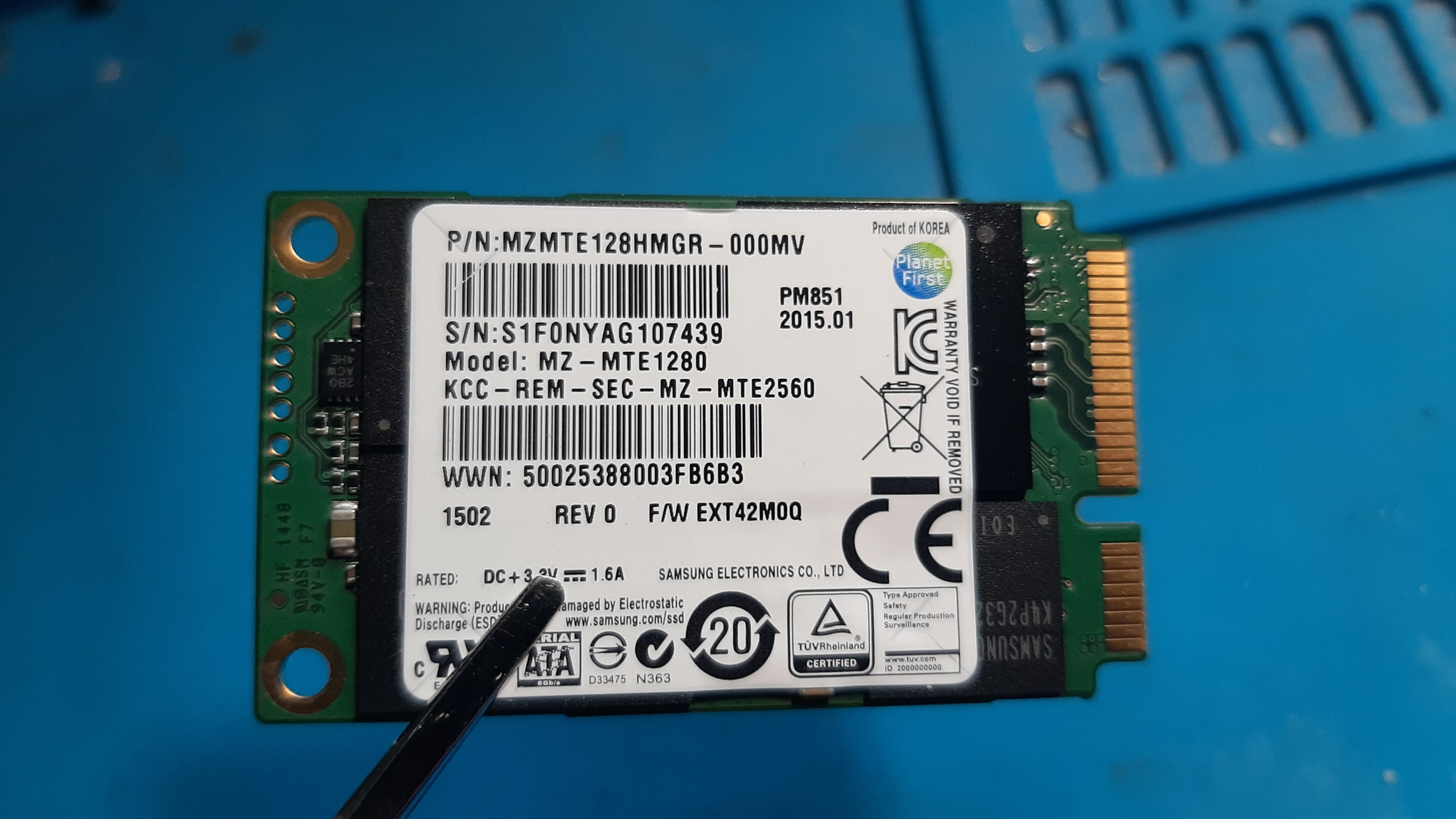

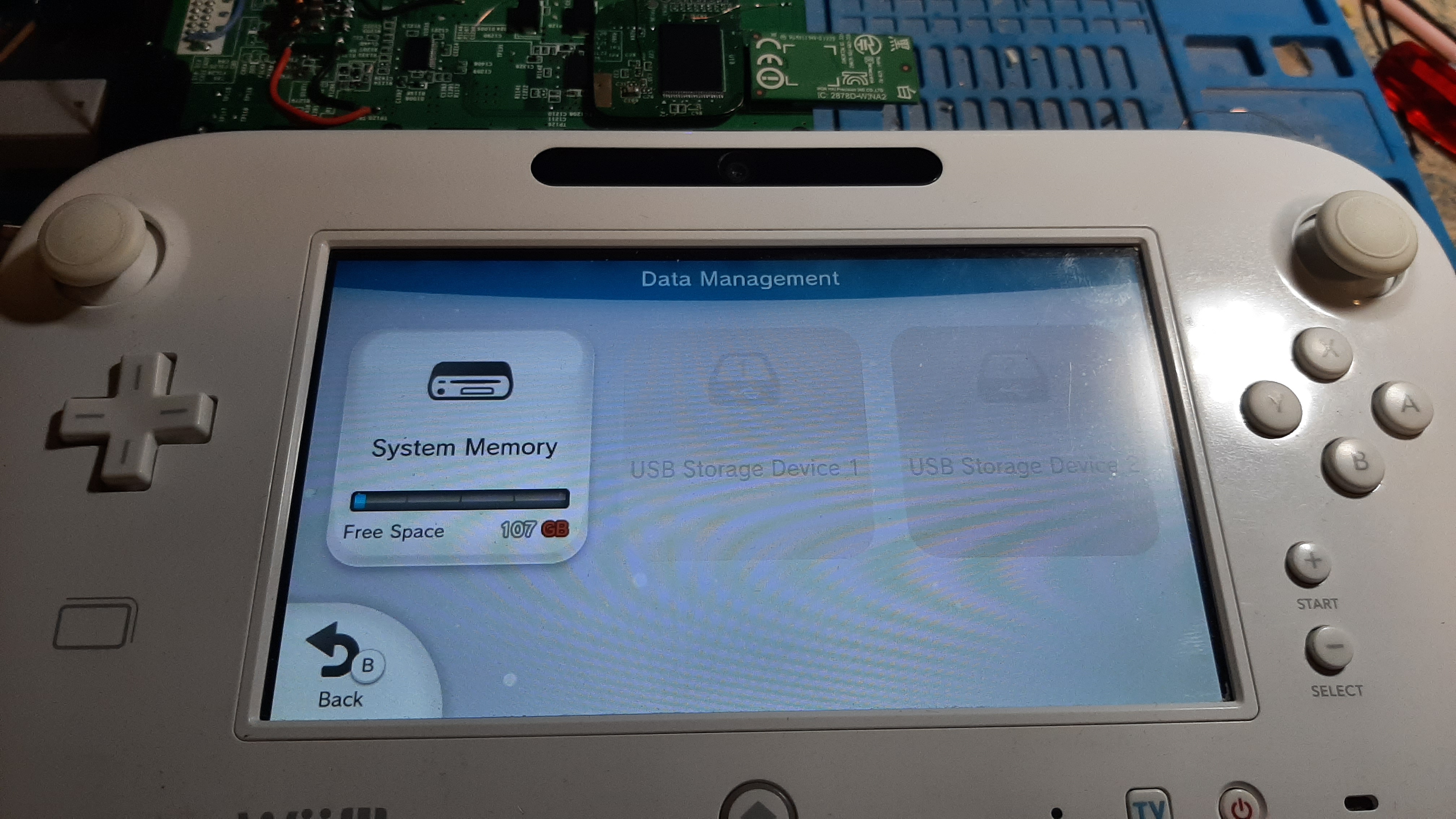

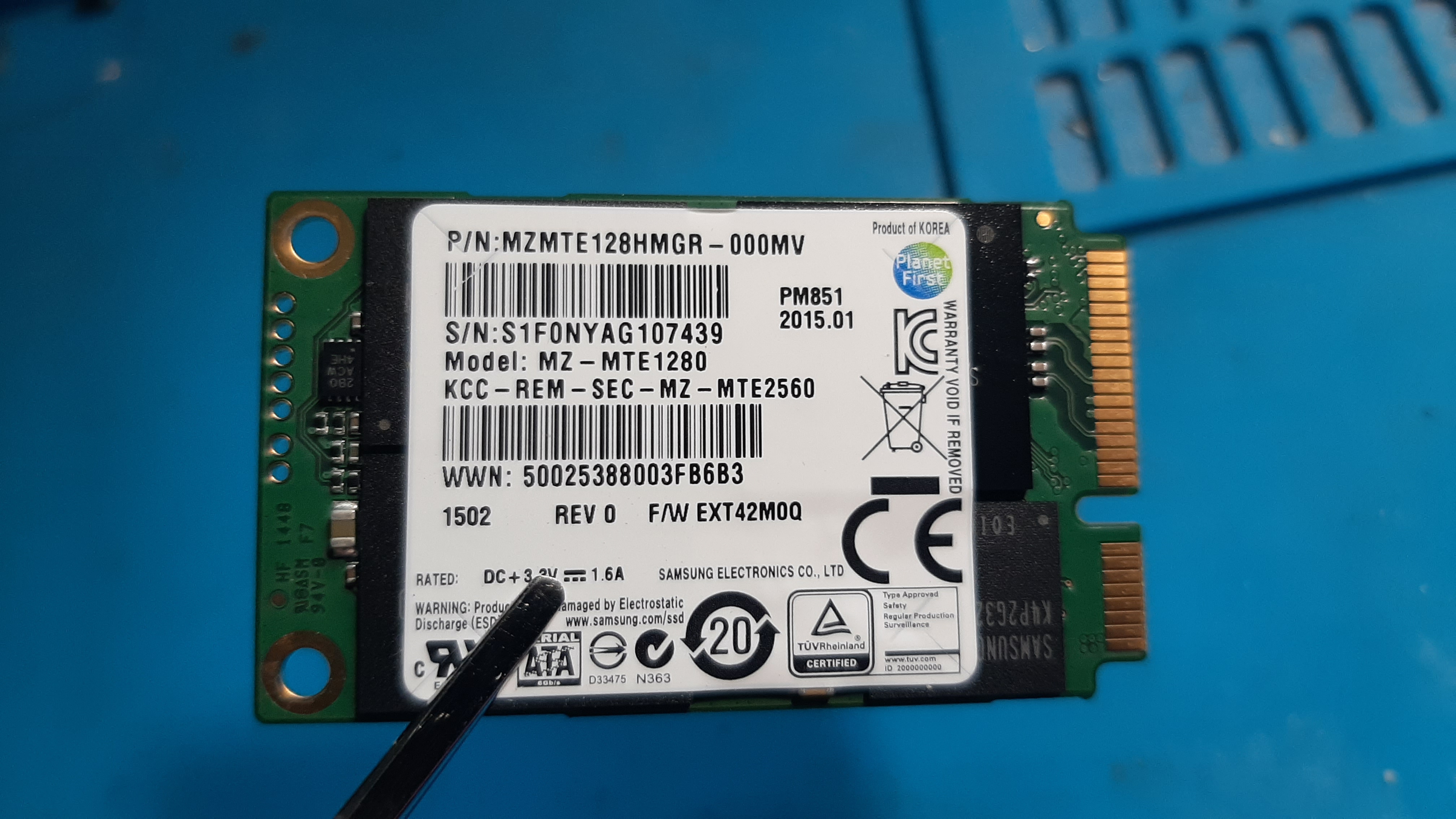

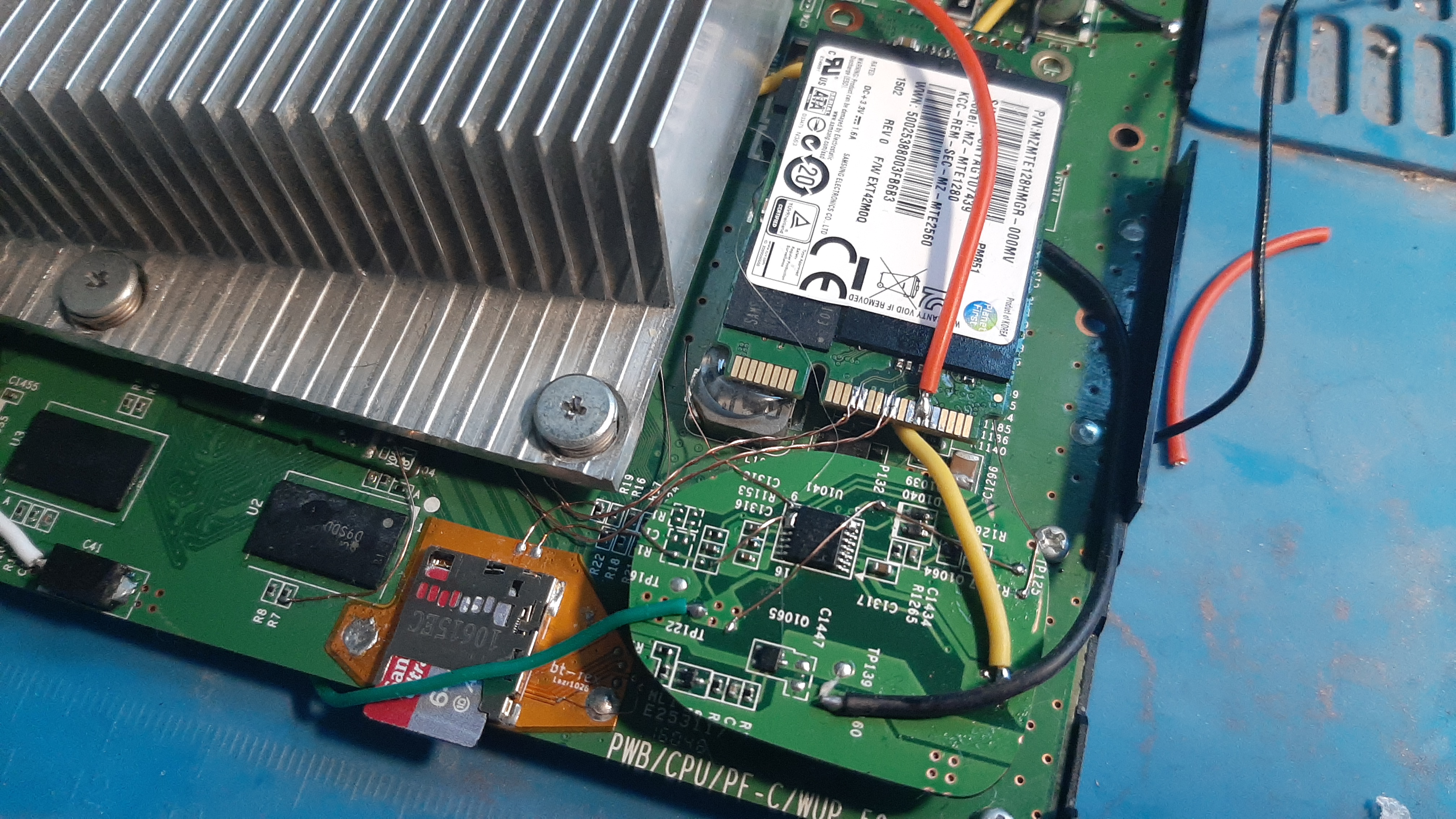

I've been working on my Wii U Mini for basically this whole past week, and I gave up on relocating a eMMC or SD card, so I bought a 128GB mSATA SSD to use as the MLC. Installation worked first try!

That is so cute! What are you using for the shell? You have the opportunity to tap into your inner Gunpei Yokoi and make a truly inspired design.
Is the SD card replacing the front slot, or the eMMC? You could use rednand and free some overhead out of the msata drive when you boot a game, it might be an interesting experiment.

Is the SD card replacing the front slot, or the eMMC? You could use rednand and keep the msata game drive, it might be an interesting experiment.
I crafted a shell out of the original shell. As for the sd, the picture is very old and that flex is no longer there.
