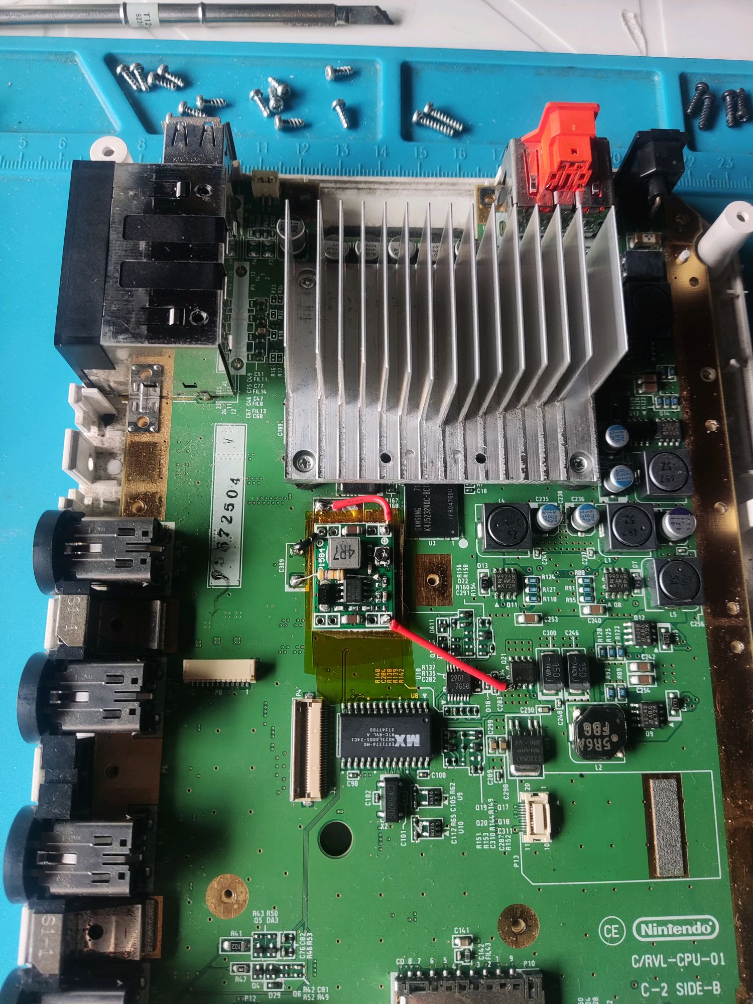

@KleinesSinchen I just tested U4, so... 3.3 volts coming in, but only 0.8 volts coming out (it should be 1.8v).
I'll order the regulator and hopefully it will fix the wii, I'll update this thread when the time comes.
Reactions: KleinesSinchen

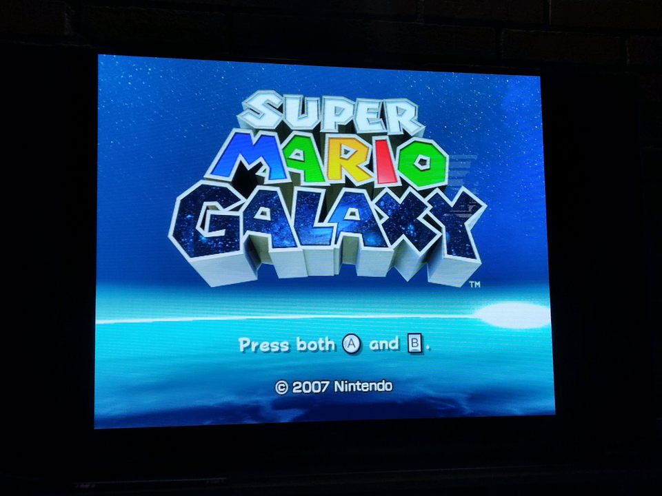

Hello guys, just reporting in.
I finally managed to replace the U4 with the new regulator and....it works!
Thank you so much for the help.
