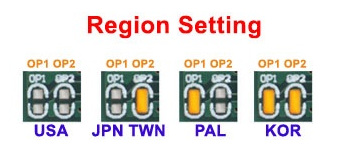

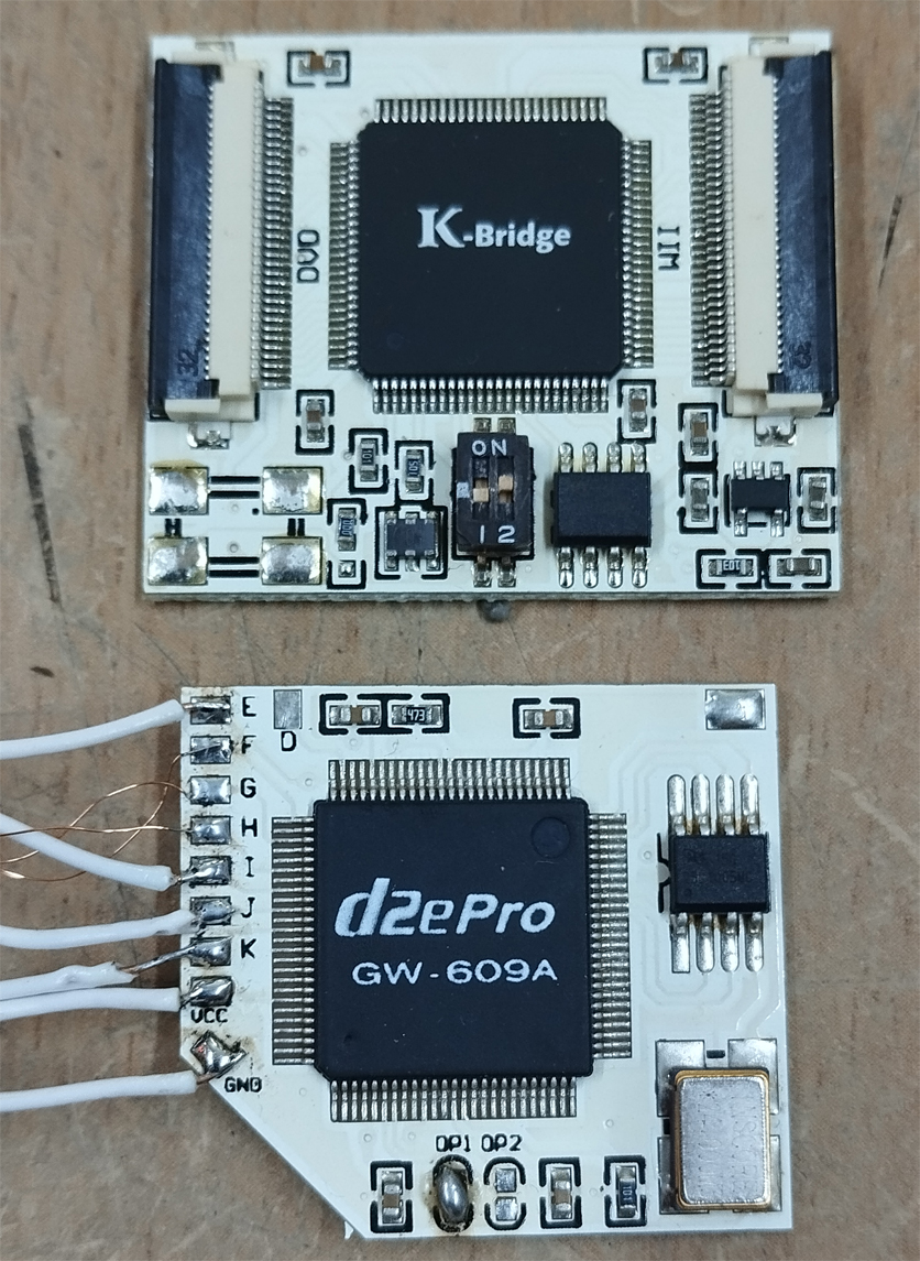

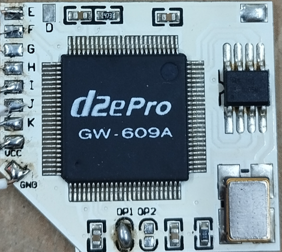

Hi everyone I finally success that unbrick my 003 wii with the modchiped drive. randomly my bricked 003 wii been USA region and fortunly modchip key set to usa region I think.

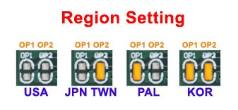

You don't solder wires to the jumpers, you solder to the pads by bridging them. I would also suggest you check your connections and use better wires.
Use the following diagram here to set the jumpers properly.
Reactions: Faruk1986
tanx for answer and nice guide
but soldering wire to the points is better than jump with direck soldering because if if need to ferquently change region free soldered wire is either fast and safe.
yes if one use it permanantly certain ragion yes set the jumper with solder is best choice but for me no
but soldering wire to the points is better than jump with direct soldering because if if need to frequently change region free soldered wire is either fast and safe.
No. Definitely not. If the jumper wires are exposed to the metal shielding, in many cases it could short out the chip. Removing a solder bridge isn't all that difficult. Add a small bit of flux to the pad/s and then swipe it away with the iron.
If you don't know how to solder correctly, watch a YouTube video.
no I use shielded wire for safety.
trust me if I could attach it micro latch switch for best possible state
You're using enameled wire, that is NOT what 'shielded wire' is.
Enameled wire uses either 'aluminium' (or in most cases 'copper'), which is covered with a thin enameled layer to prevent the remaining slack from shorting any other component. In contrast, shielded wires are found usually on audio or USB cables. Dozens of wire strands will be within the shrink tubing because their purpose is to reduce noise.
So, in conclusion based on your recent photos, you're using enameled wire. What I've said that you should do with the jumpers, is by bridging the points together with solder. How hard is it to bridge two small pads together? You don't need to make a massive blob, just enough so that the points touch one another. You can remove them at any time if you're considering to install it in another console but I digress.
This sounds a lot like a skillset problem of which I highly advised you to watch a tutorial on soldering, not only that this will improve your skills on what you SHOULD and SHOULDN'T do in the near future, but maybe make the wires a lot tidier than they were.

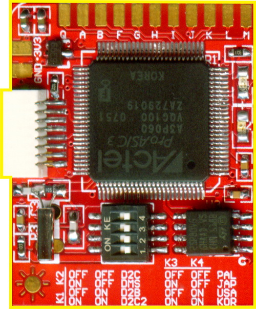

I have the same modchip as Faruk1986, and I mostly play via USB but now I'm curious on how these jumpers work. If I have a USA console and I bridge OP1, can I play PAL and USA discs? Or bridging depends on the console where the modchip is installed? Meaning that a USA console most have both jumpers always open.
Also, another question:
My disc drive (GC2-D2E) is FUBAR, I want to get a new one and there's no good info about this clone. Do you (or anyone who reads this) know by any chance which drive models are compatible with this thing?
If your console was of USA region, then do not bridge the jumpers and leave them open. Highlighted in 'orange' is where you will need to bridge the pads based on what region your console was made for.

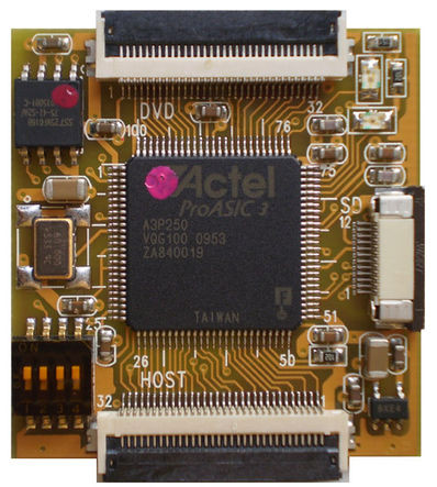

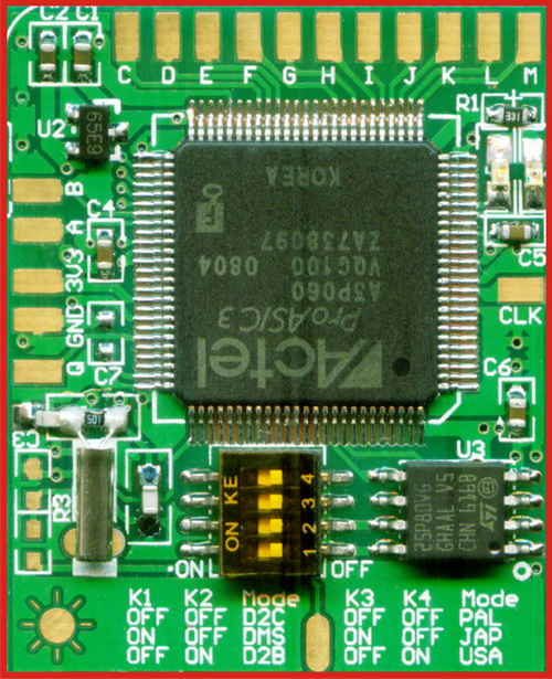

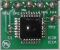

This thread will help you identify what modchip you have installed in your Wii (including uncommon ones).
Updated: 20th July 2023
Original:
FPGA: Actel ProASIC 3 A3P250
V1.x:
FPGA: Actel ProASIC 3 A3P060
V1.3A:
FPGA: Actel ProASIC 3 A3P125
V1.5:
V2.X:
V3.0:

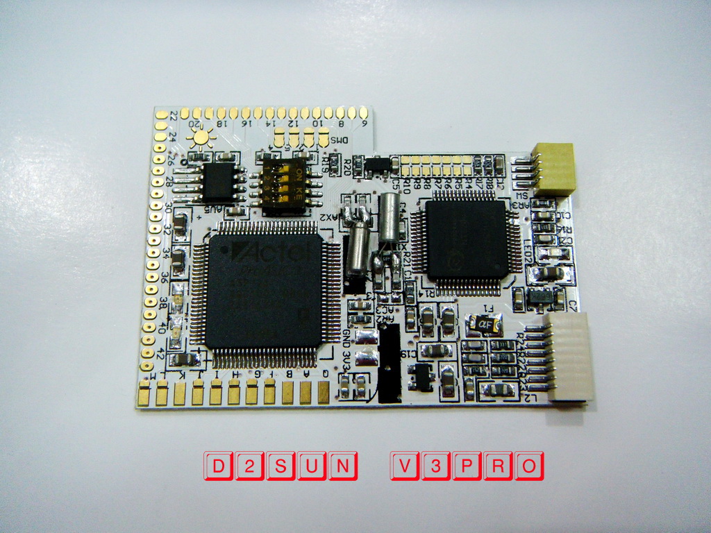

V3 Pro:

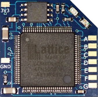

CPLD: Lattice MachXO LCMX0640C
FPGA: Actel ProASIC3 A3P060
MCU: ATMEL AT90S8515

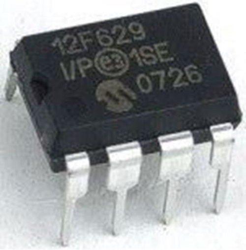

MCU: Microchip 12F629
Comes with or without a Wiinja sticker.

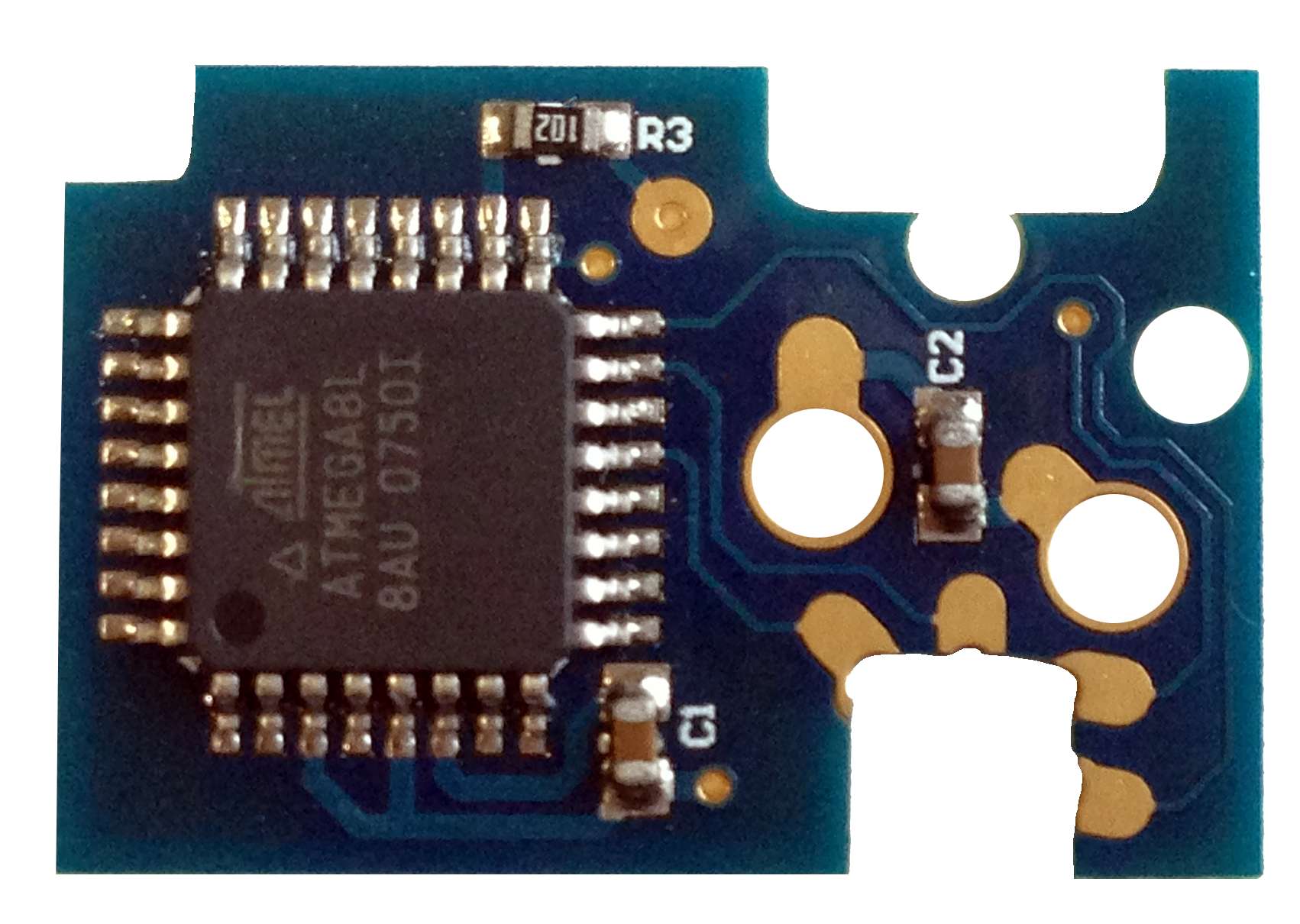

MCU: ATMEL ATMEGA8

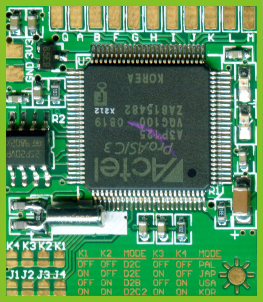

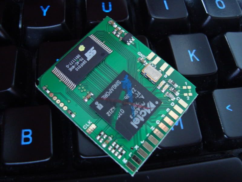

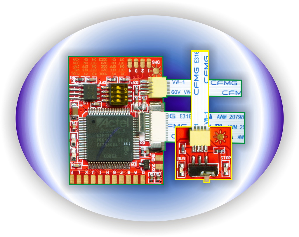

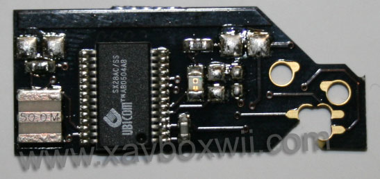

Clone identification:
MCU: Ubicom/Scenix SX28AC (same chip used on the PS2 Magic chips).
Clones:

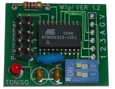

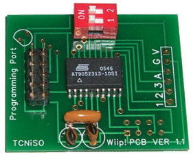

V1.0-V1.2
MCU: ATMEL AT90S2312

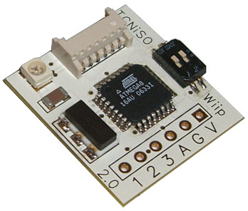

V2.0
MCU: ATMEL ATMEGA8
MCU: ATMEL ATMEGA8

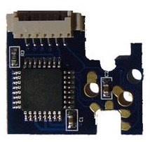

Clone of the WiiKey v1.
Clone of a D2Lite.
MCU: ATMEL ATMEGA8
Possibly using WiiSKAS or WiiFree code judging by the pinout.
Clone of a D2lite/WiiKey v2.
MCU: ATMEL ATMEGA8

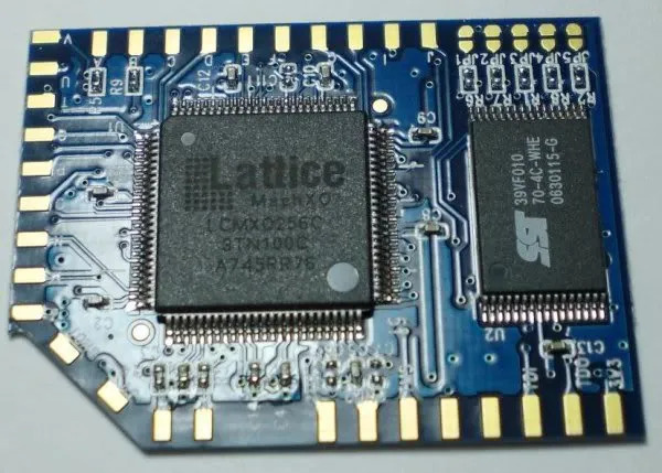

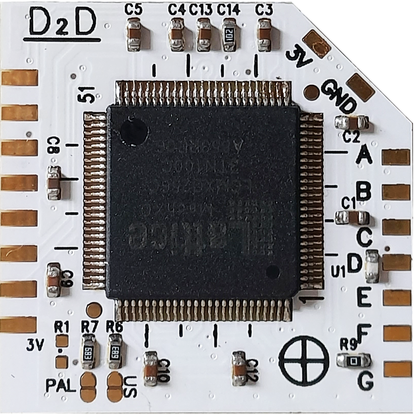

CPLD: Lattice MachXO LCM0256C
Clone of the Wasabi.
Clone of the WiiKey Fusion.
Clone of the DriveKey.

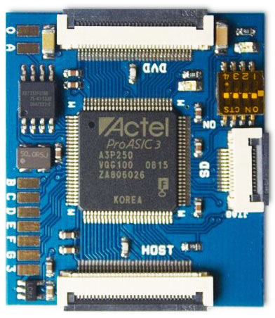

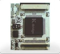

I have a k-bridge modchip
Any guide for region options switches?
There is 2 switch 1 and 2
Please guide me for regions
DriveKey Configuration
Here is the region configuration figure which tells you what DIP switches to set for which console region you have.
For example: If you have an American US Wii system, set switch 1 to OFF and switch 2 to ON.
Once you have installed the DriveKey and power on the system, you'll need to configure the modchip to your needs, such as region free and update blocker.
  • Power on the Wii, make sure that there are no discs inserted. If so, then power off the Wii, eject the disc, then power it back on.
  • At the 'System Menu', press the 'Eject' button 3 times. After a short period of time, you should then see the GameCube disc icon as if a GameCube disc was inserted.
  • Select the GameCube icon then select 'Start'. You will then arrive at the configuration menu, to which you can then make any changes to the DriveKey's configuration to your liking. Select 'SAVE SETTINGS' once you have finished.
The list of options are as follows:
- Region Override - Fully region free playback of Wii games [ON/OFF] (Recommended: 'ON').
- Update Blocker - Block online/disc updates [ALL/IMPORT/OFF] (Recommended: 'ALL').
- Wii Disc Autoboot - Direct-boot the disc when inserted [ON/OFF] (Optional).
- Full GC Region Free - Fully region free playback of GameCube games [ON/OFF] (Recommended: 'ON').

I got a new modchip but I couldn't determine which model is it
Number of wires are insane
