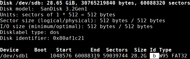

In the MBR system (have you confirmed it's MBR and not GPT or whatever?) partitions have type codes, while they are absolute chaos for historical reasons (and many thing will partially ignore them for the same reason), a "large" FAT32 partition should be type C
https://thestarman.pcministry.com/asm/mbr/PartTypes.htm
Example (lol it's wrong, type B when it should be C since it's over the 8.something GB limit of CHS addressing, but as said most PC operating systems nowadays are sloppy):
