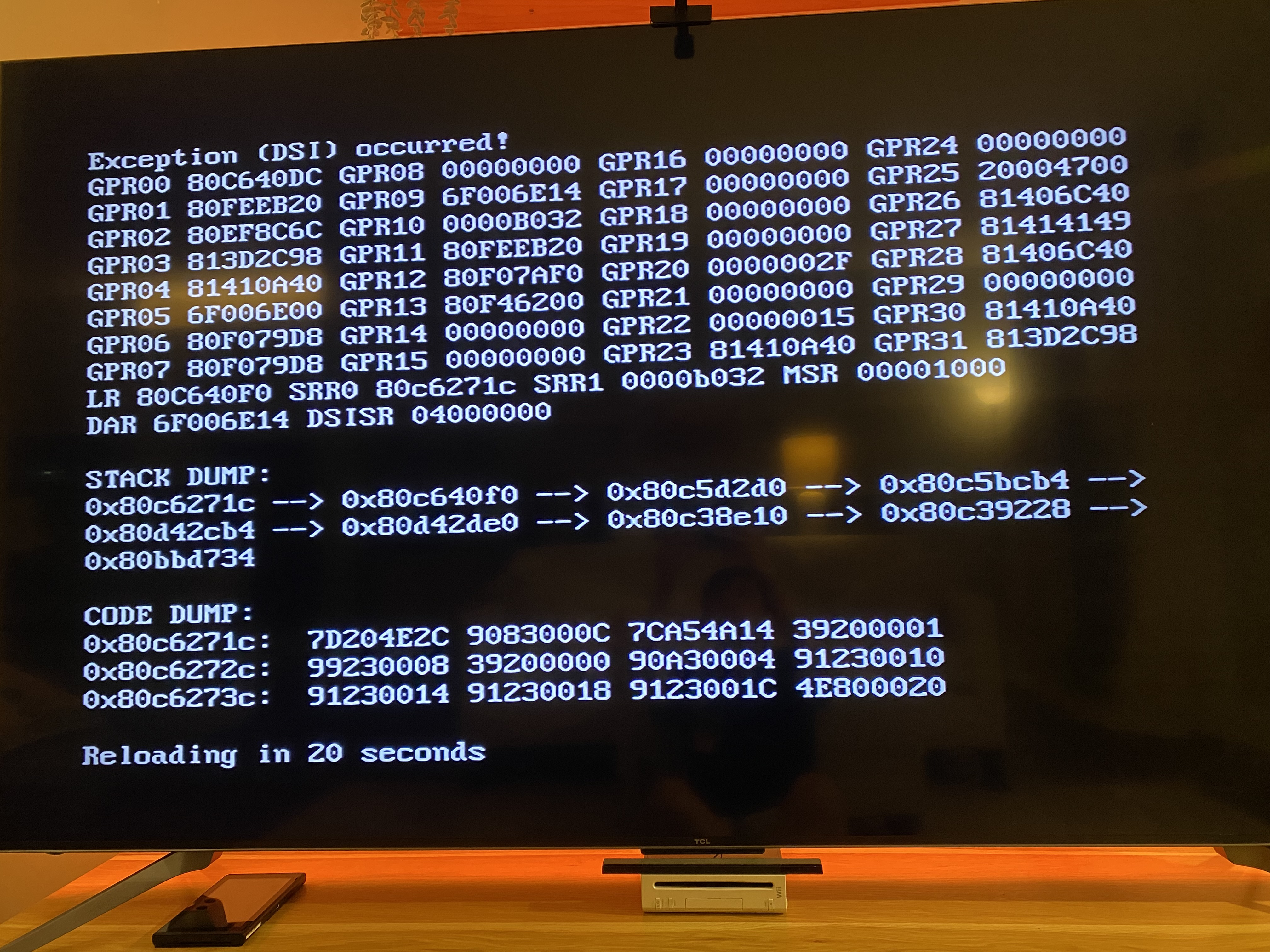

I ran into this problem just now as well 😭. I downloaded the stable version that was just uploaded today on the github. What I did was delete the usbloadergx folder in the app directory and replaced it with the new one from this github. Now when I load usbloadergx, I get an exception. Are there additional steps to doing the install?
Edit: Also tried updating it from the homebrew browser and it still crashes
The crash info seems to hint that it's got something to do a file or folder in your wbfs directory.
Is your drive using MBR with a single FAT32 partition? And if you temporarily rename your wbfs folder to something else does the loader boot correctly?
Thanks for the reply! My wbfs folder is actually in my hdd. When I remove the hdd from the wii, it boots up correctly, so I think you’re onto something. My hdd is NTFS instead of FAT32 because I don’t have Gamecube games and I don’t want to deal with partitioning for Wii games over 4 gb. Could it be that? All I have in the hdd is my wbfs folder.
Renaming the wbfs folder to something else still crashes
Are your file and folder names under 260 characters, like they would be with FAT32?
Ideally you should have a file layout like this...
/wbfs/Mario Kart Wii [RMCP01]/RMCP01.wbfs
You could try to copy a few files with short titles to a new wbfs folder, try the loader, and then repeat that until you weed out the problematic ones.
I plan to drop NTFS support when I release the next big update. And in it's place will be exFAT support.

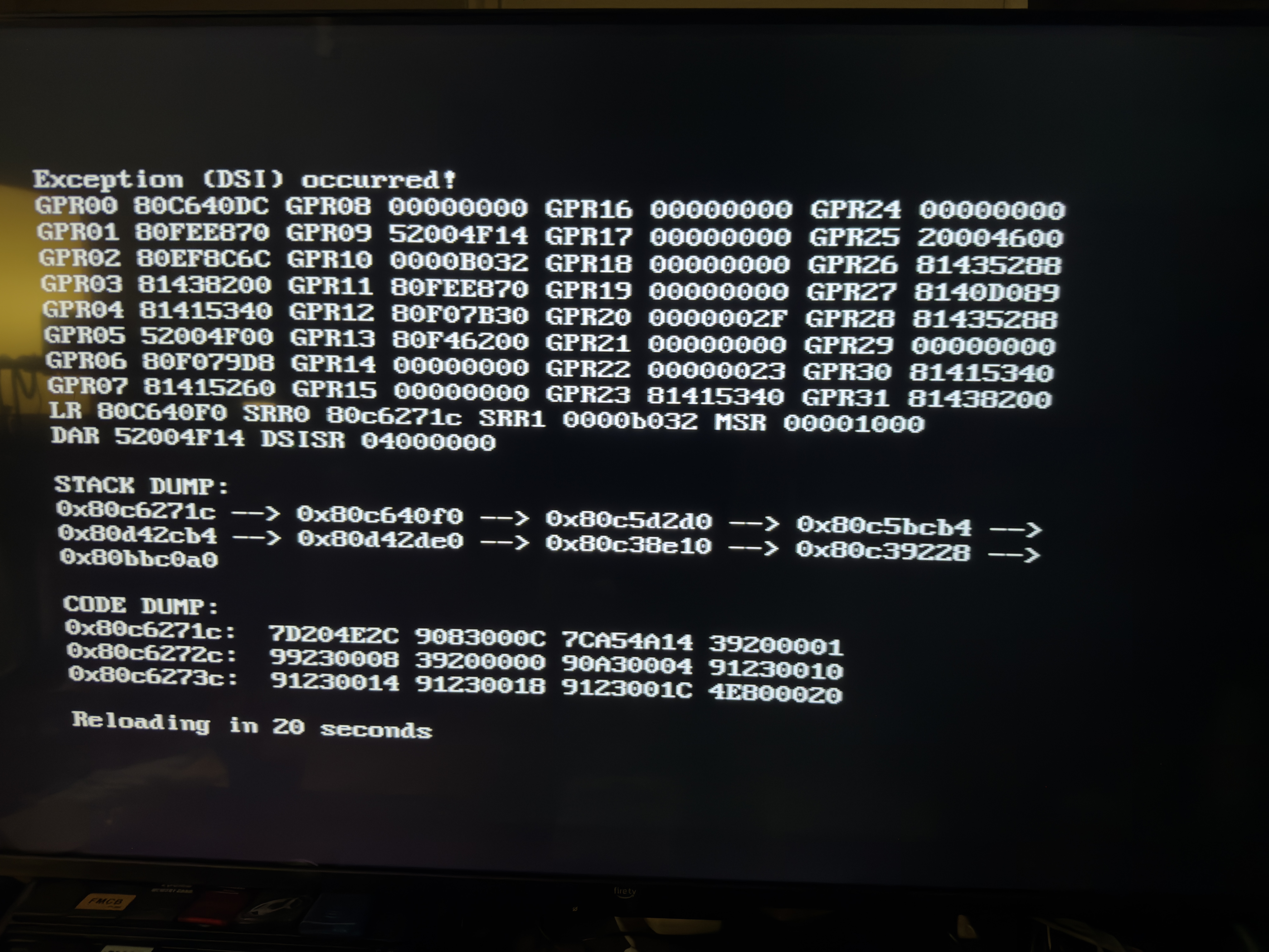

I also have the same issue. I get a crash within like 3 seconds of the actual user interface coming on . If my hdd isn’t plugged in the program will start. I have two partitions (, NTFS for Wii, Fat32 for GameCube) and it works on pervious versions decent. I’ve gone through removed usb loader and reinstalled it and reset defaults and same problem.
I plan to drop NTFS support when I release the next big update. And in its place will be exFAT support.
Okay cool! It loads up normally when I add a few games with short names. I don’t see any folders/files with paths that are over 260 though. The longest would probably be maybe 60 characters. I’ll probably have to weed it out like you mentioned. Big thanks for the help!
If either of you are able to pin point the issue then I'll try to replicate it and release a hotfix.
If longer than normal paths don't seem to be the issue then what about empty folders or files with the wrong file extensions assigned?
I've got to get some more sleep, but I'll check for replies later.
