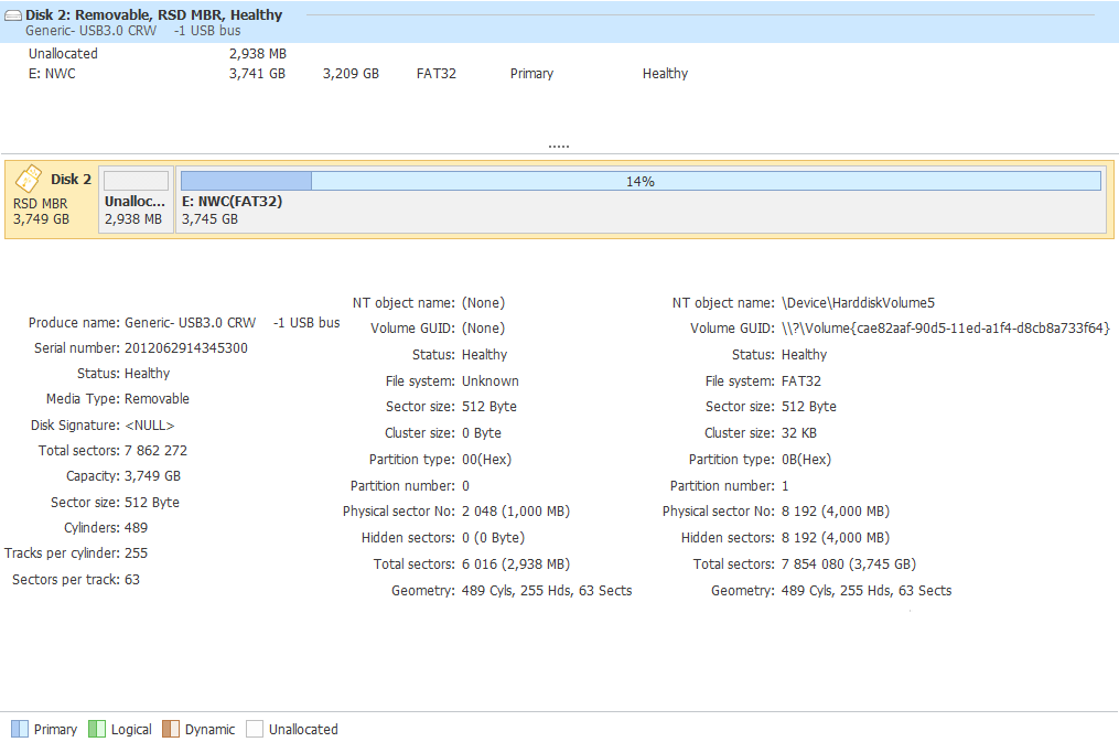

Somehow I also just caught the "could not create path usb8:/apps/usbloader_gx/..." error when working with single alone SD card. :O
But in my case my 4GB SDHC card have exactly only one partition (without any hidden ones), MBR, FAT32, 32k and all that (rechecked).
It's Wii, cIOS d2x-v11-beta1 and USB Loader GX v3.0-r1281.
Some sort of mystic.
Update: Tho nevermind. in the same mystical way it began to work.

But being a larger sd, the Panasonic software do the format in ExFat, so I decided, just for curiosity, to go with the EaseUS software.
And... surprise
32MB on one first partition were giving me quite a huge headache :rofl2: So I deleted all, formated again, minimum SD files with two games and...
I assume you've already deleted the usbloader_gx directory and started over. So are you launching the loader from the HBC or a forwarder other than UNEO?

I tried both from HBC and through a forwarder (I don’t know which one, ModMii installed it for me once).
The problems disappeared completely when I formatted the card using SD Card Formatter 5.0.2 (from sdcard.org).
Prior to this (when there were problems) the card was formatted with GUIFormat.
Basically, I'm not going to use the Wii without a USB-HDD, it was just a trial run for a quick check. So it doesn't really bother me.
btw, that's what SD Card Formatter 5.0.2 did that GUIFormat didn't:
(i.e. completely opposite to this)

Holy crap! I've been peeking my head into the Wii/Wii U scenes updating my setups that I haven't really touched in 5 years and running some pretty ancient stuff. It's really nice to see the scene still active and doing awesome work adding cool features, fixing longstanding bugs and improving QoL. Thanks for this.
@zigoraty I'll see if I can replicate the issues later on my Wii, but it does seem odd that you're the only person reporting these issues.
What seems wrong with the SD storage info? Since both myself and my testers have never seen it display incorrect information.
But everything is working very well, I just decided to report these details. I took a picture from SD storage, maybe I didn't explain well.
