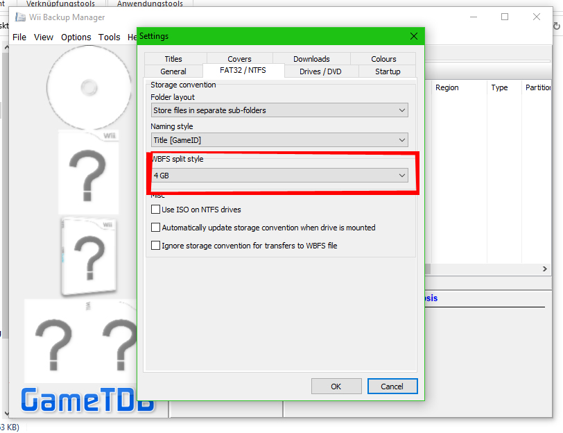

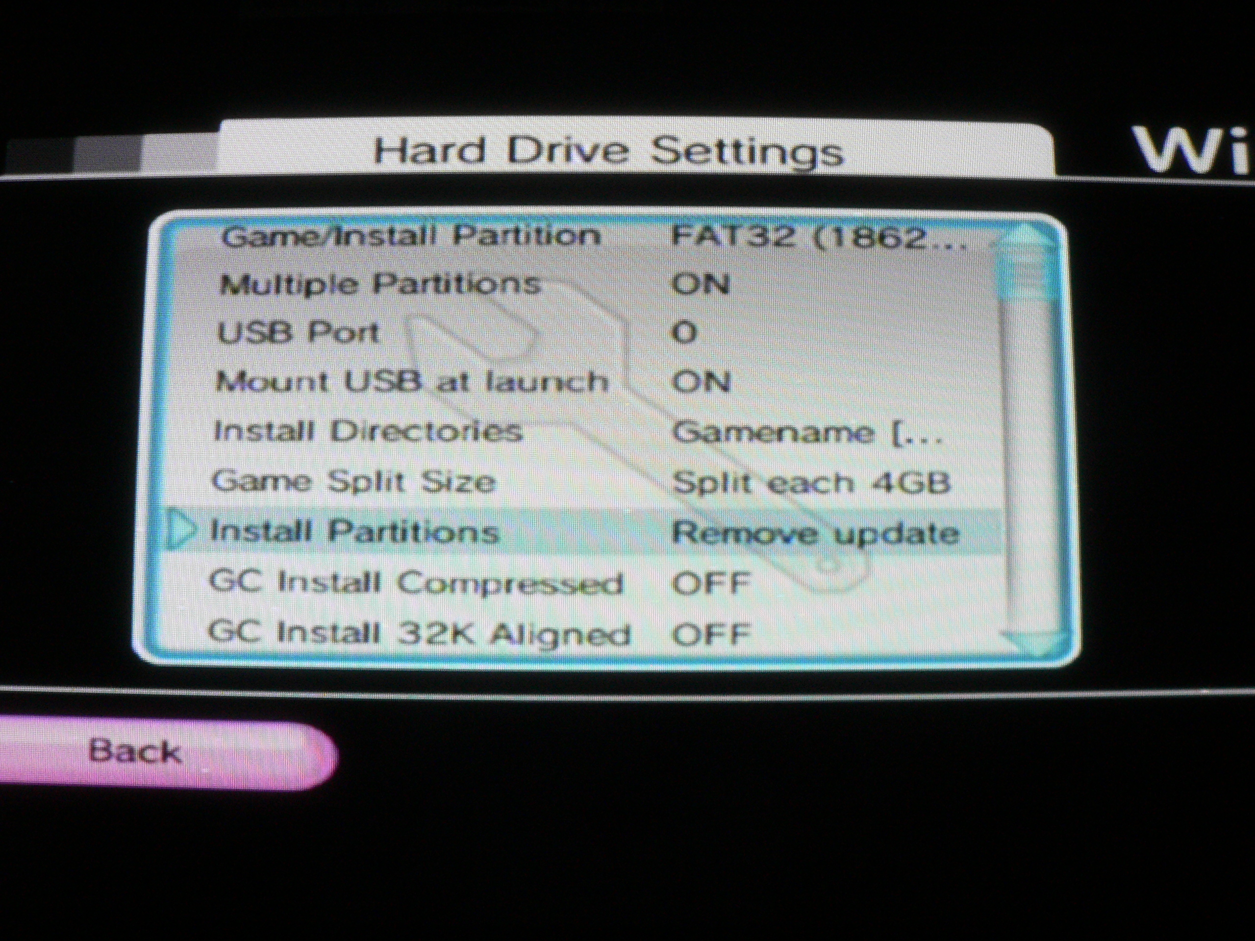

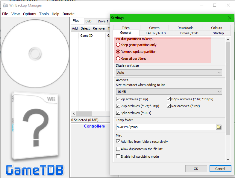

@The_Wacho - As suggested by jeannotte the drive needs to be FAT32 with 32k clusters and I use FAT32GUI Formatter to do this (see Step 4)
There are a couple important steps that should not be over looked:
-Step 1: See the last notation about there being unused space or an ASTRIX on the drive. This is sometimes in the front position and even though it is unused/unallocated it can cause an issue with intermittent loading. Make sure there is nothing else at all showing on the drive, just the one partition. If there is merge everything so there is only ONE partition and nothing else.
-Step 2: Make sure the drive is converted from GPT to MBR, if not you'll have issues.
-Step 3: While there is some debate whether this is needed or not, it doesn't hurt anything, so if you're having problem with the drive make sure to set it to PRIMARY & ACTIVE .
-Another Item: Are you using a single cable to power the drive or a Y-Cable? It's possible you Wii's USB ports are weak and a Y-Cable could fix the issue.

I think you use the WiiBackup Manager for the Game Transfer to your USB HDD.
Did you checked in the Options this Setting please ?
Also please be sure you only remove the Update Partition:
If you use the Install Option from the USBLoader GX can you check this Settings too please ?
Settings/Global Settings -> Hard Drive Settings - Game Split Size -> Split each 4GB
Settings/Global Settings -> Hard Drive Settings - Remove Update
Thank you.:)

Hello.:)
I think yu use the WiiBackup Manager for the Game Transfer to your USB HDD.
Thank you.:)
