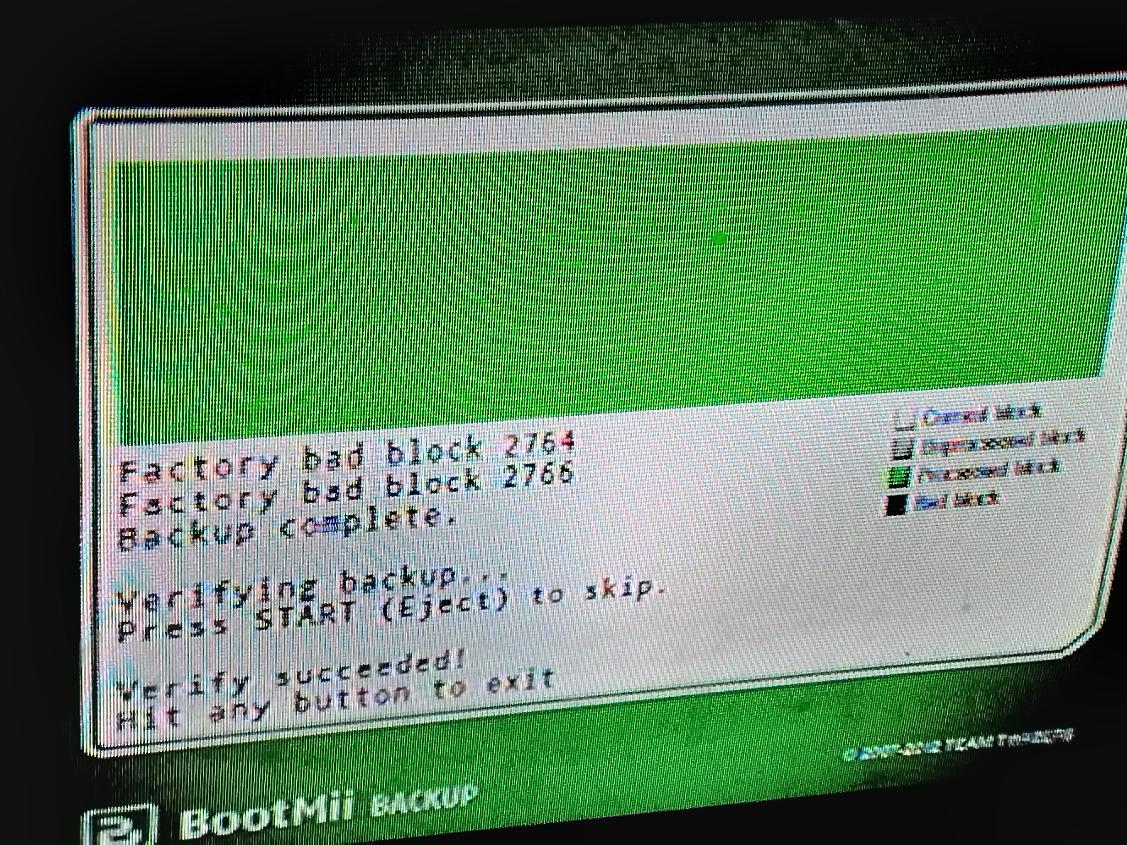

It said 4 blocks were bad when it was dumping
If they were all FACTORY BAD BLOCK MARKERs all is fine, if some weren't your NAND is corrupted for some reason (actual bad sector that developed later, plain corruption due to data retention or interrupted write, etc) and depending on what was there (if anything) may or may not be the root cause of the problem, that's statistically implausible though
they turned green during the check so not sure what to read into this
It only means the backup is accurate, it doesn't indicate the condition of the NAND....
There are factory bad blocks, correct.
Yep it was the "Factory Bad Block (####)" for all 4
...Lol remember that part where I said I'm good with hardware but when it comes to software...
