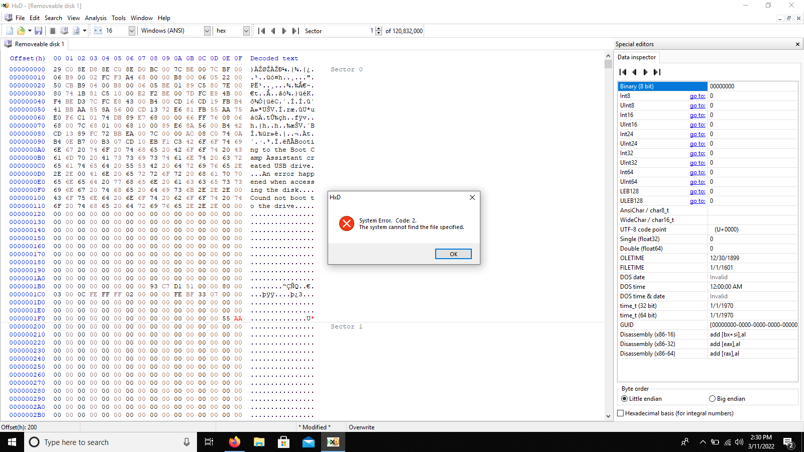

Okay I spotted it, it was AB so I wanted it to be unhidden so I changed it to AA but trying to save it gave me a System Error Code:2. It said the system couldn’t find the file specified. I’m not really sure how to resolve that issue since that’s generally what happens when I try to just format it too. I’m using HxD.
if it's the computer, something in sector 0 could've been corrupted (might be why it won't unhide the drive). do you have a backup of the content? the only way to fix this that I know of is to use disk part to wipe the drive clean, then it should format it. something similar happened to me to where I couldn't hide my flash drive during testing. I think I hid the drive, then formatted it, then tried to hide it again, and it wouldn't work. this was before I tried hex editing. disk part corrected it. there was nothing on the drive though. anyway, I hex edited the drive from AB to AA to see if it would work, and it did. not sure what's causing your error.

I have an idea, what may be the problem. did you enable write privileges to the drive? it's a check box when you load the drive in HxD. it won't let you change anything otherwise.
I did but I may ought to send a screenshot of how my USB sector 0 looks?
yes, and of the error.
Okay I got both in this picture, I noticed decoded text even mentions still when I used it for bootcamp to install Windows on my Mac. I'm currently using my laptop that natively uses Windows though.

btw, that shouldn't format the drive. just make sure you repair only the boot sector.
