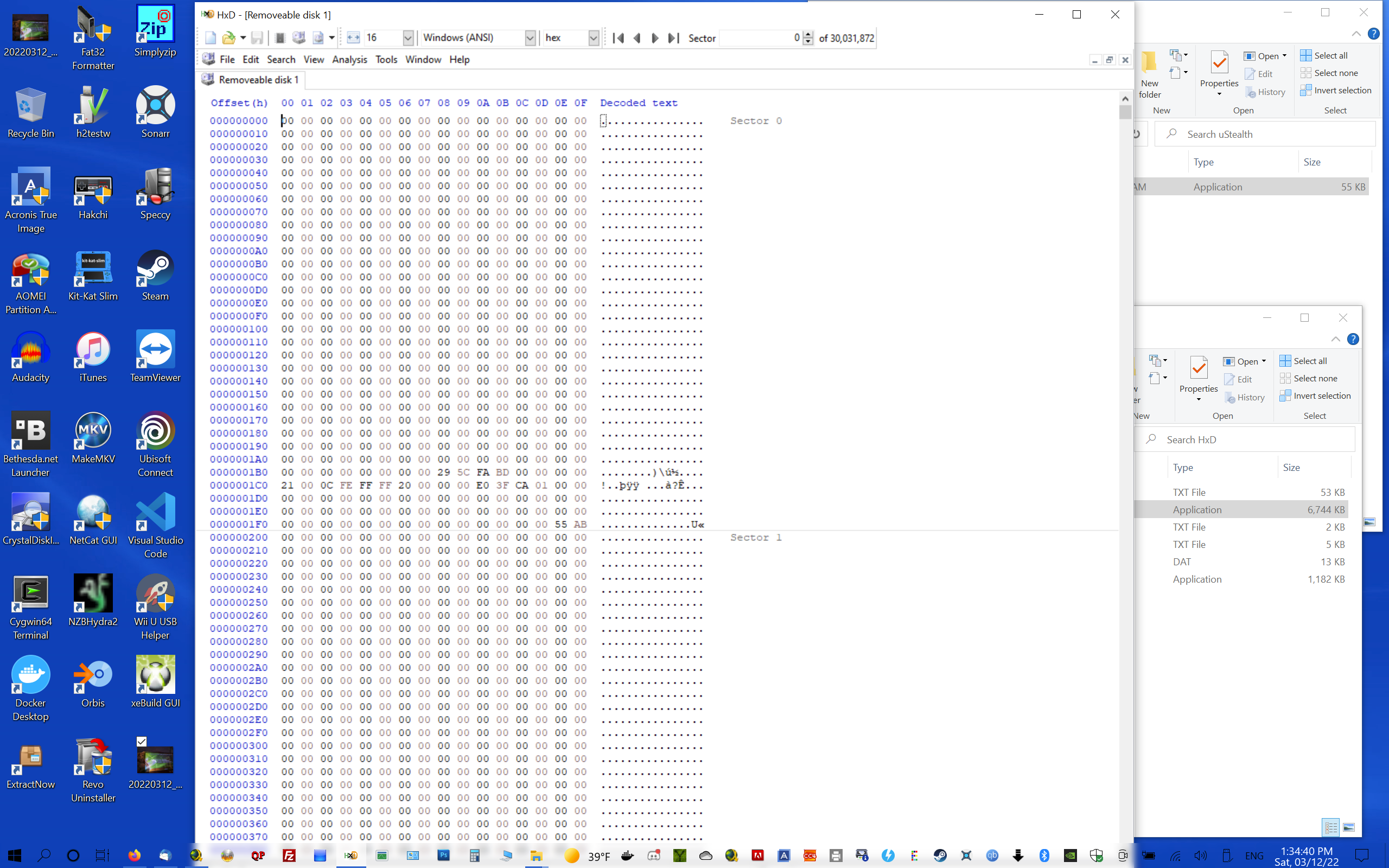

the only option I know of to correct this, possibly, is to use disk part to format it. I don't think disk management works to fix that one byte that makes it hidden/unhidden AB/AA. I have no idea why you're getting an error unless the disk is disconnecting itself for some reason.

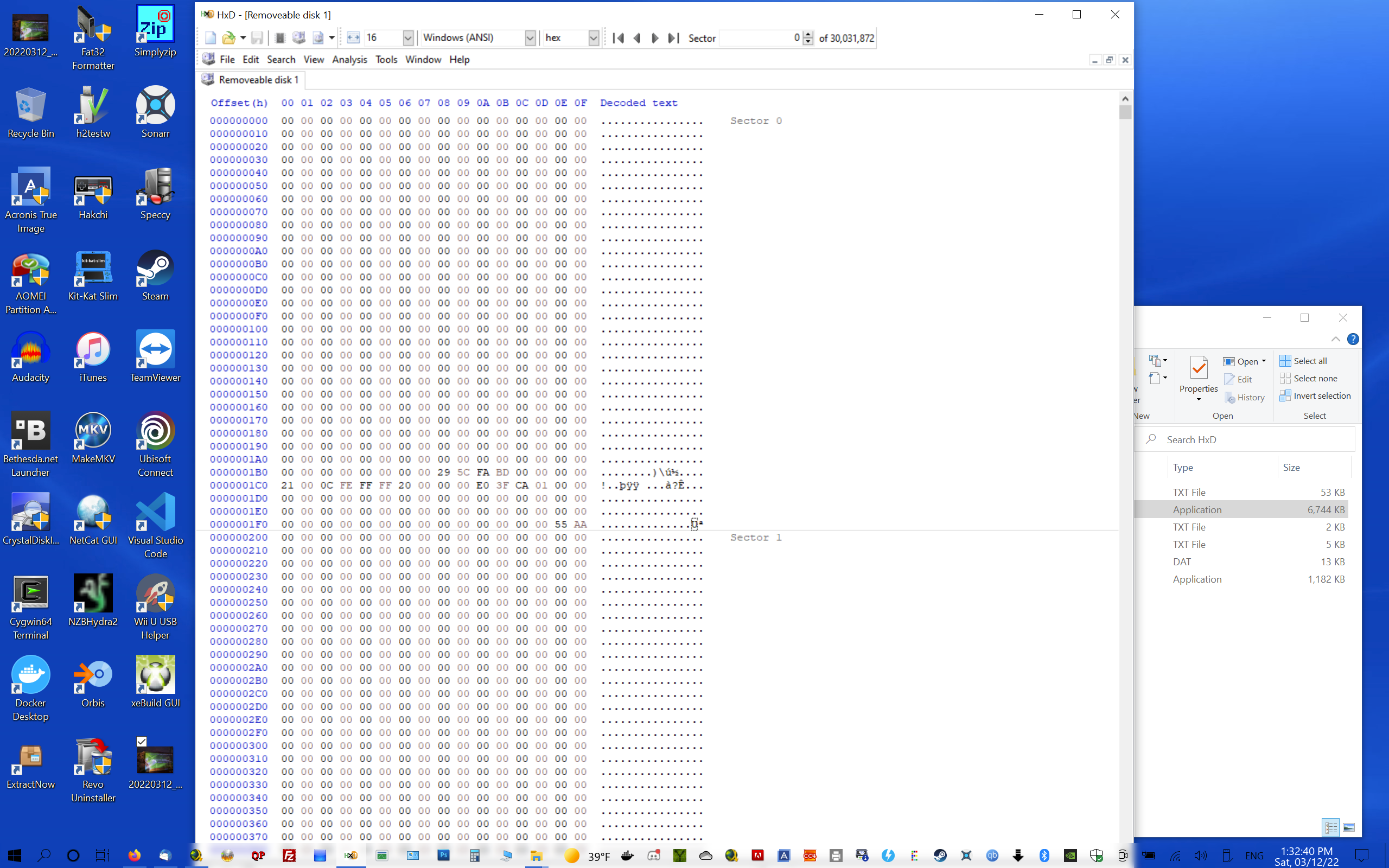

I just checked to make sure I was remembering right, yep, it's right. I changed it manually, then used ustealth to change to normal, and it's back to 55 AA again:
disk unchanged:
