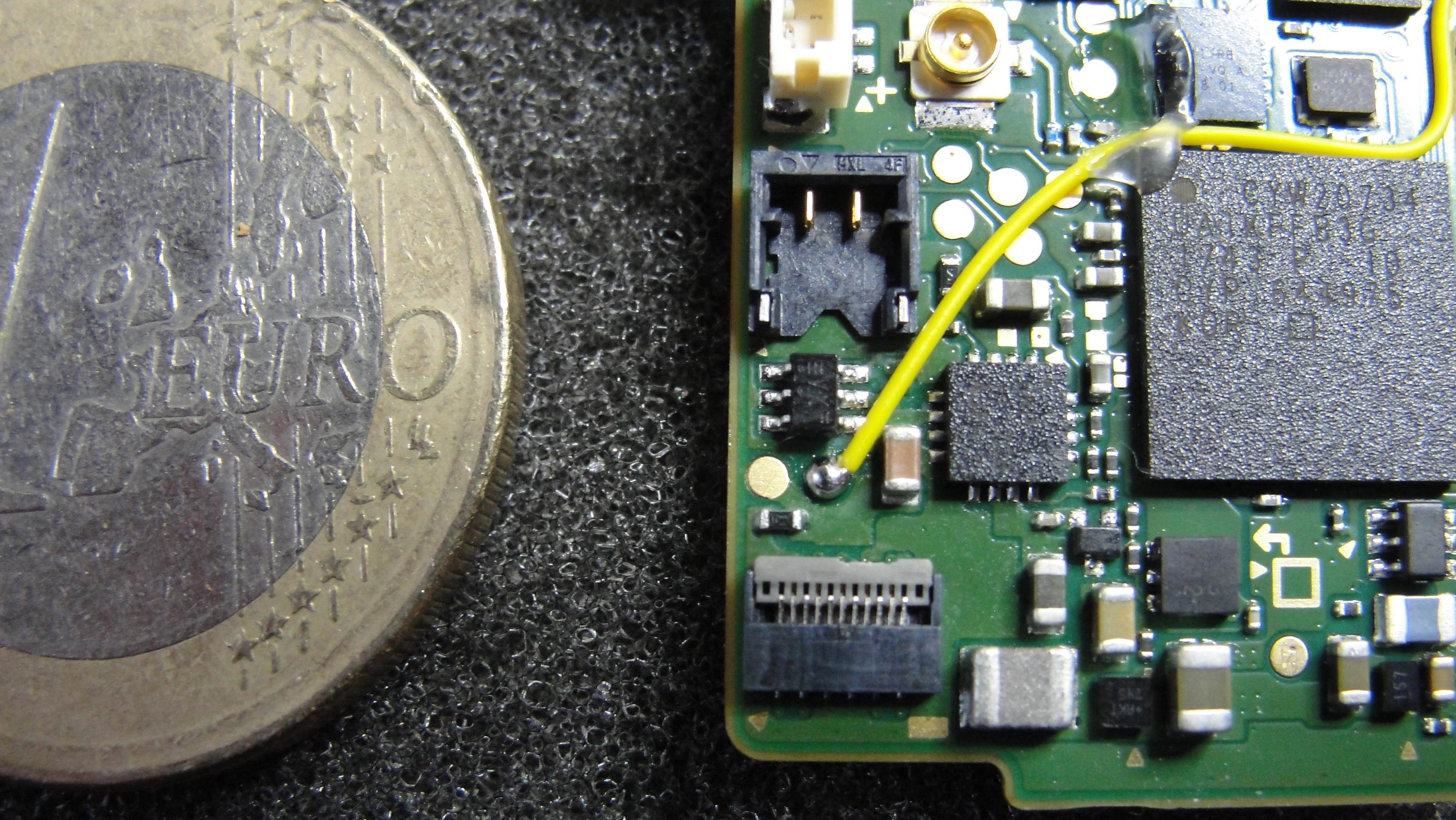

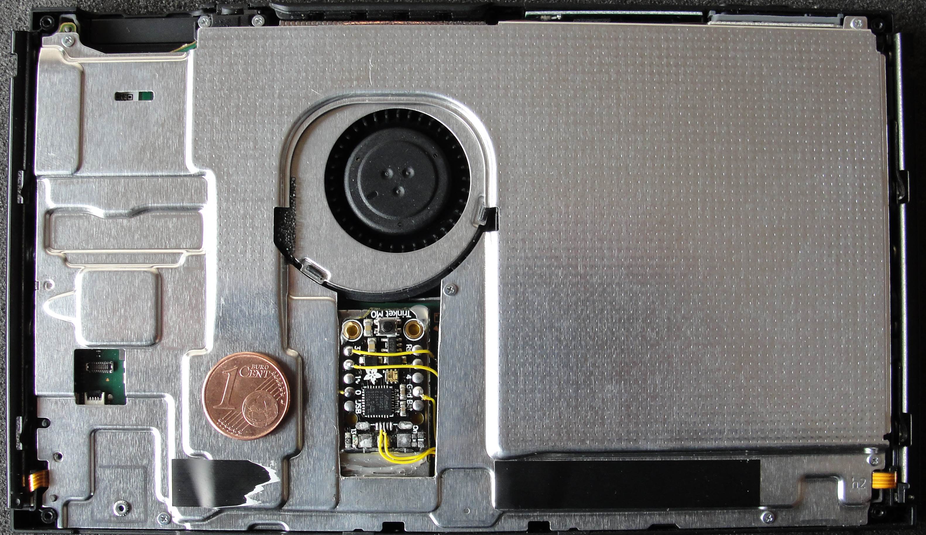

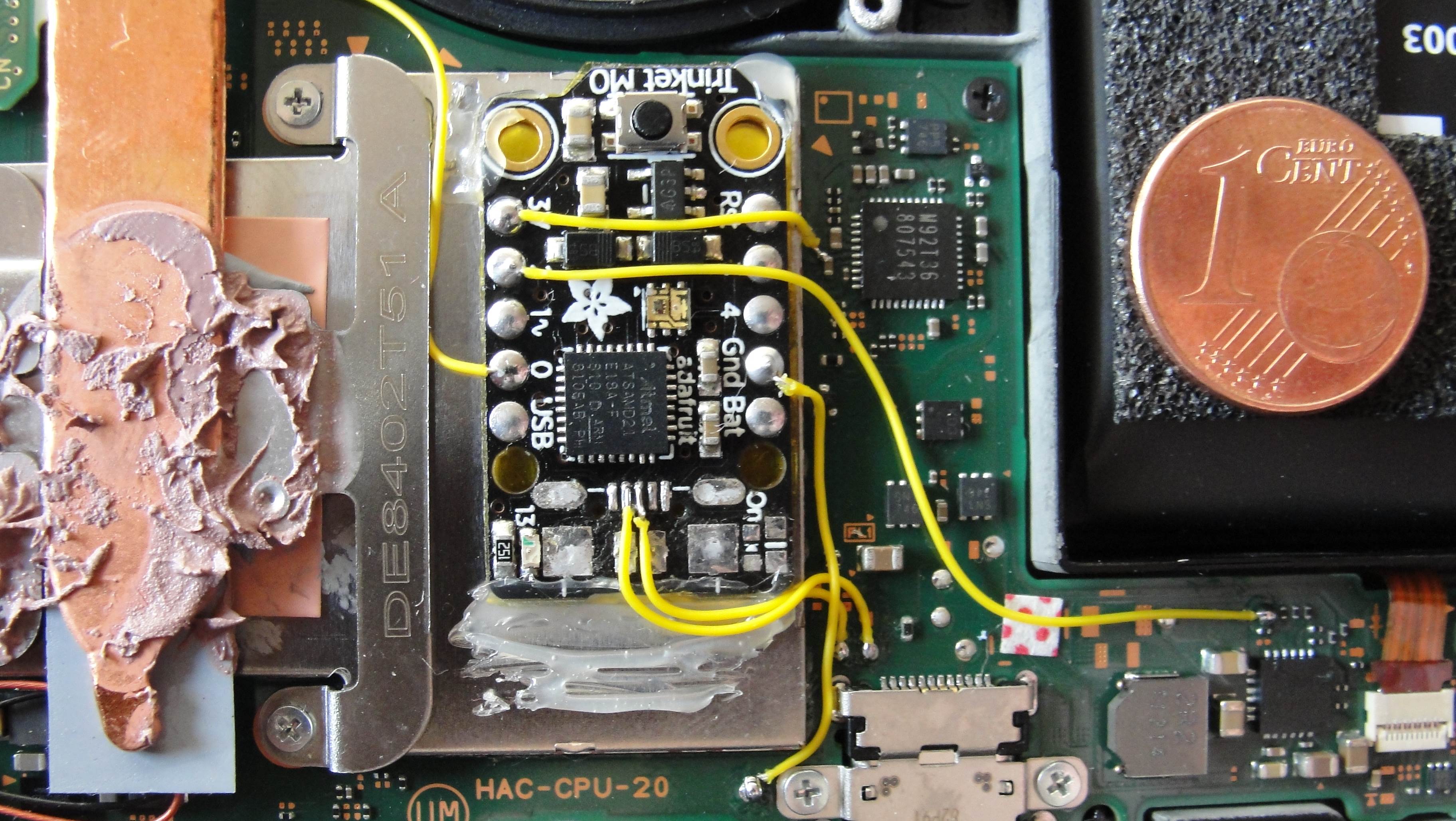

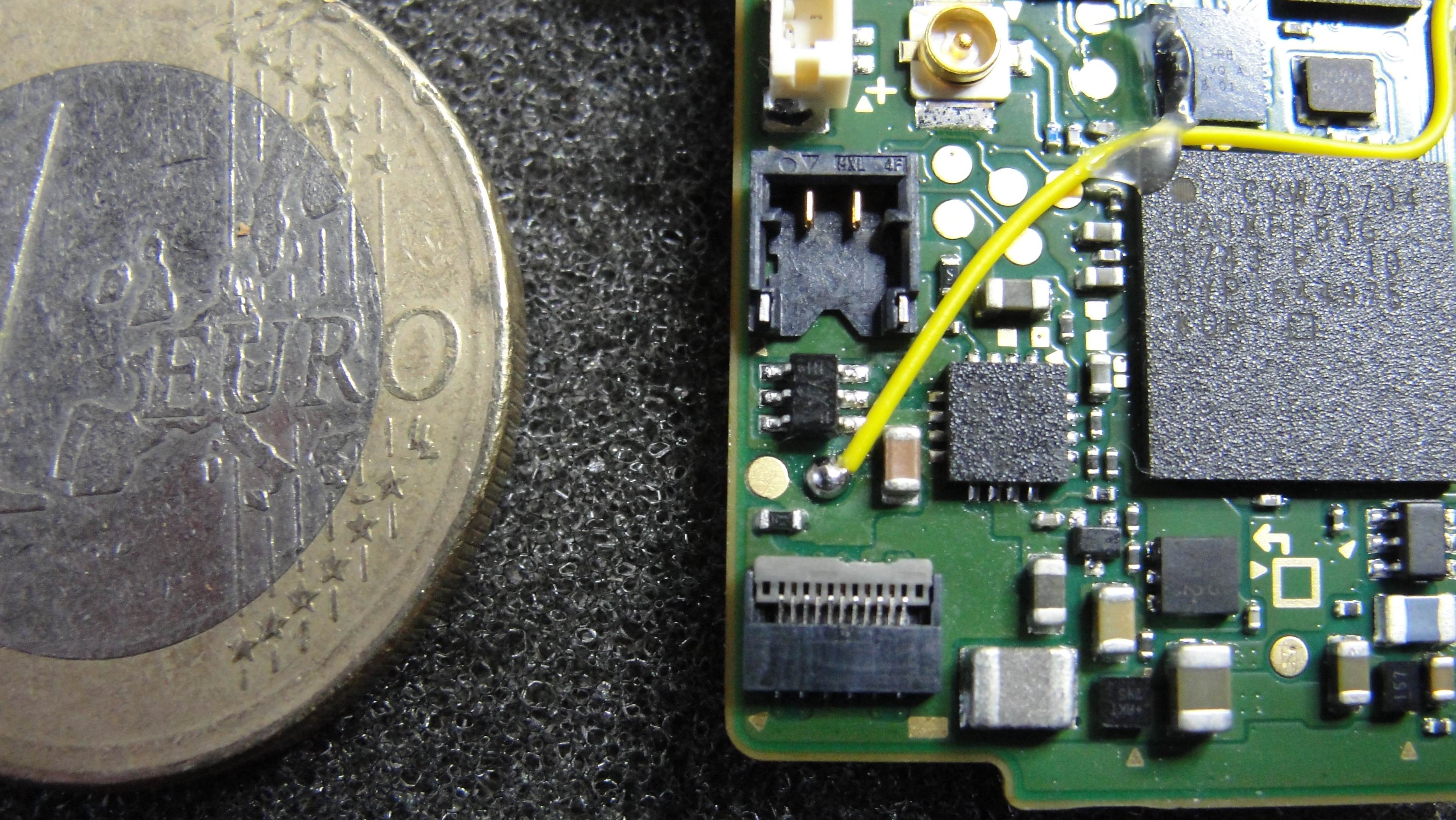

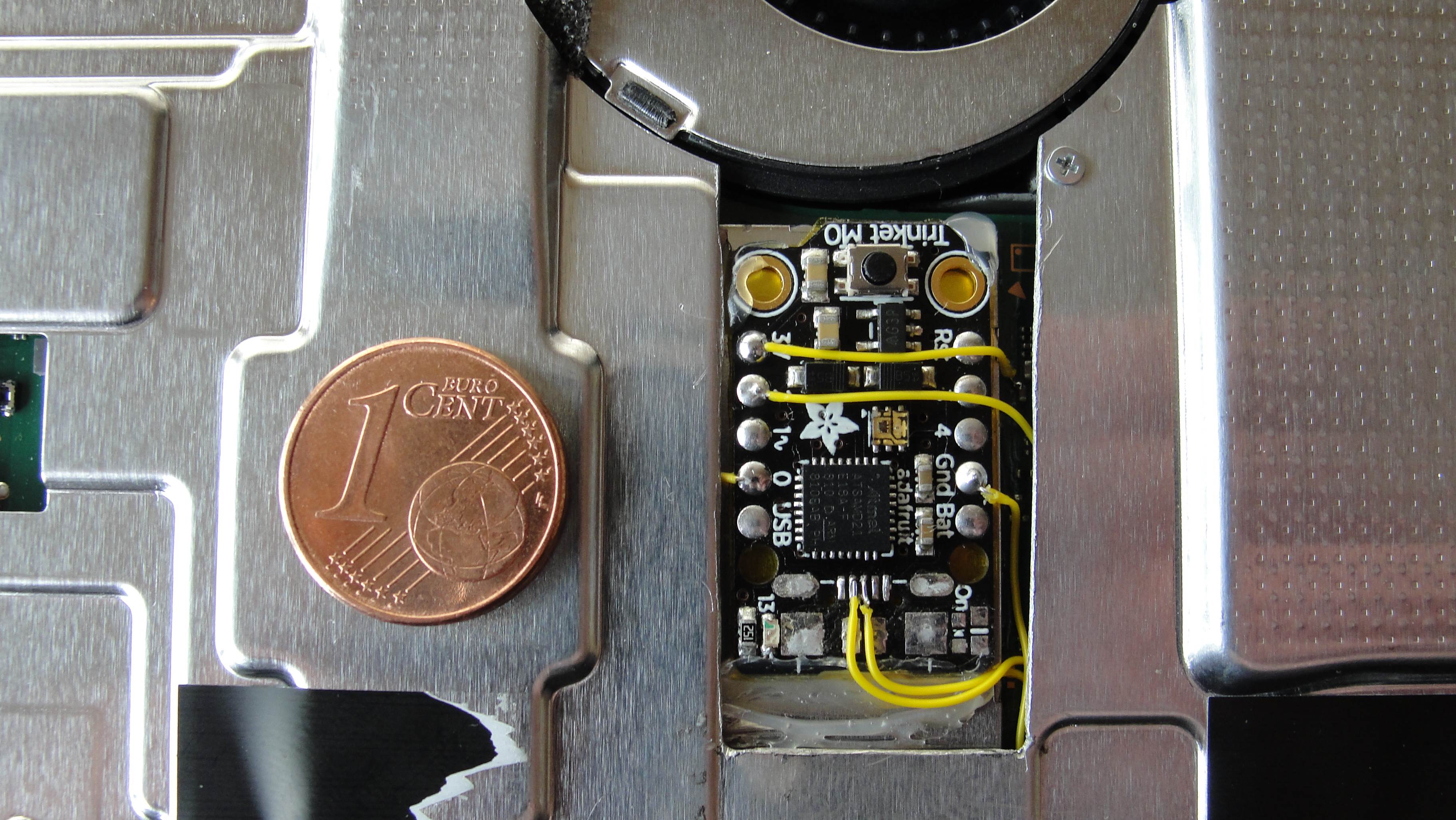

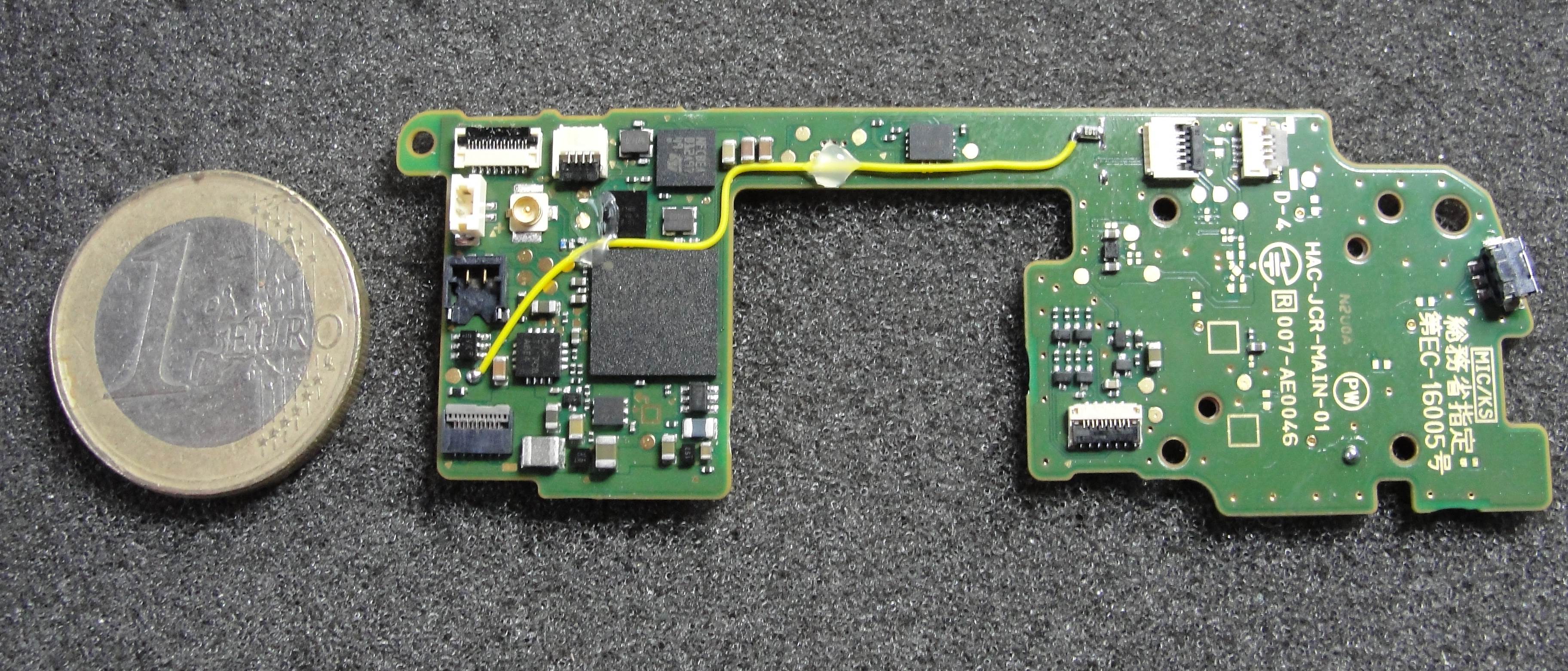

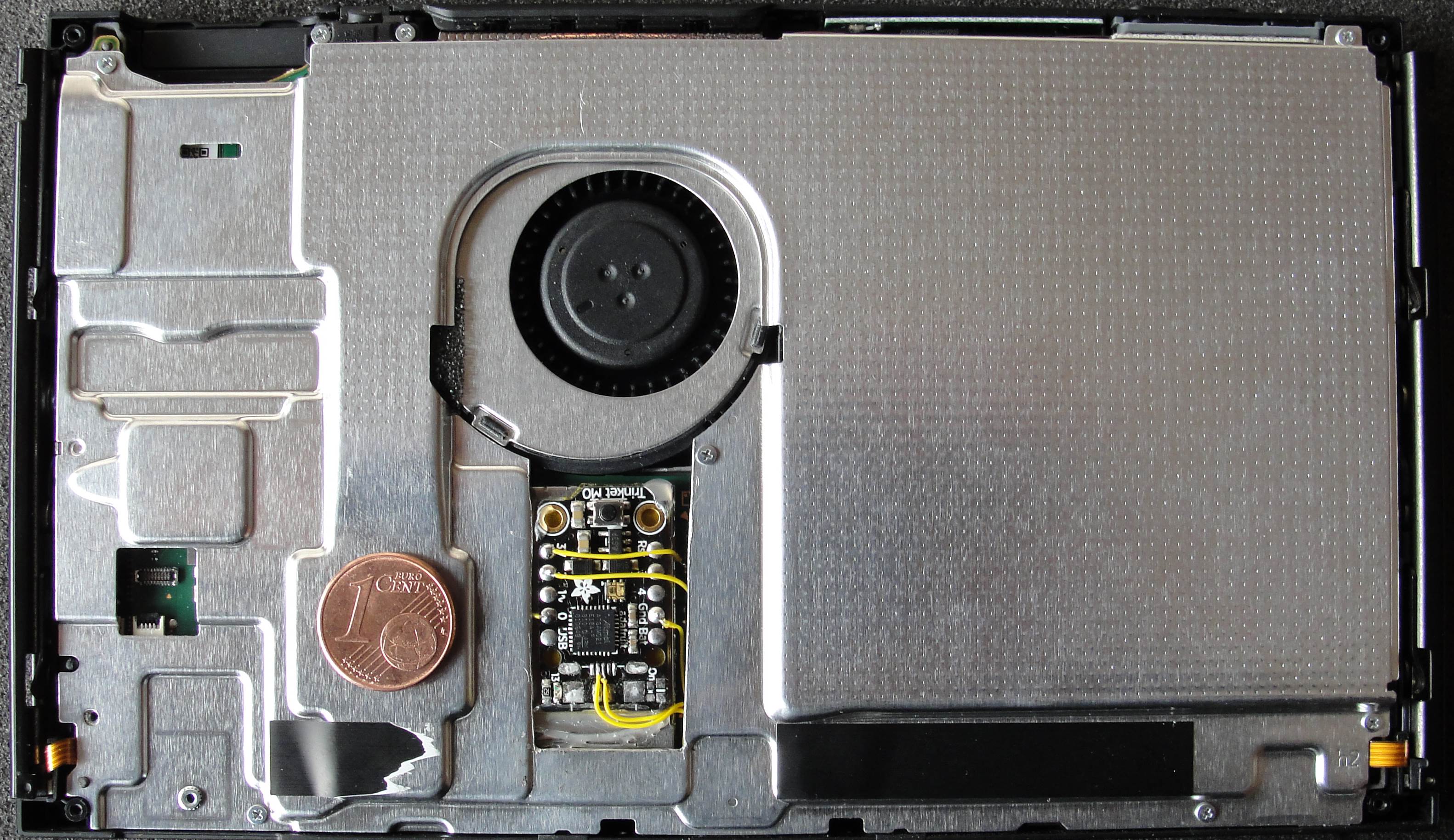

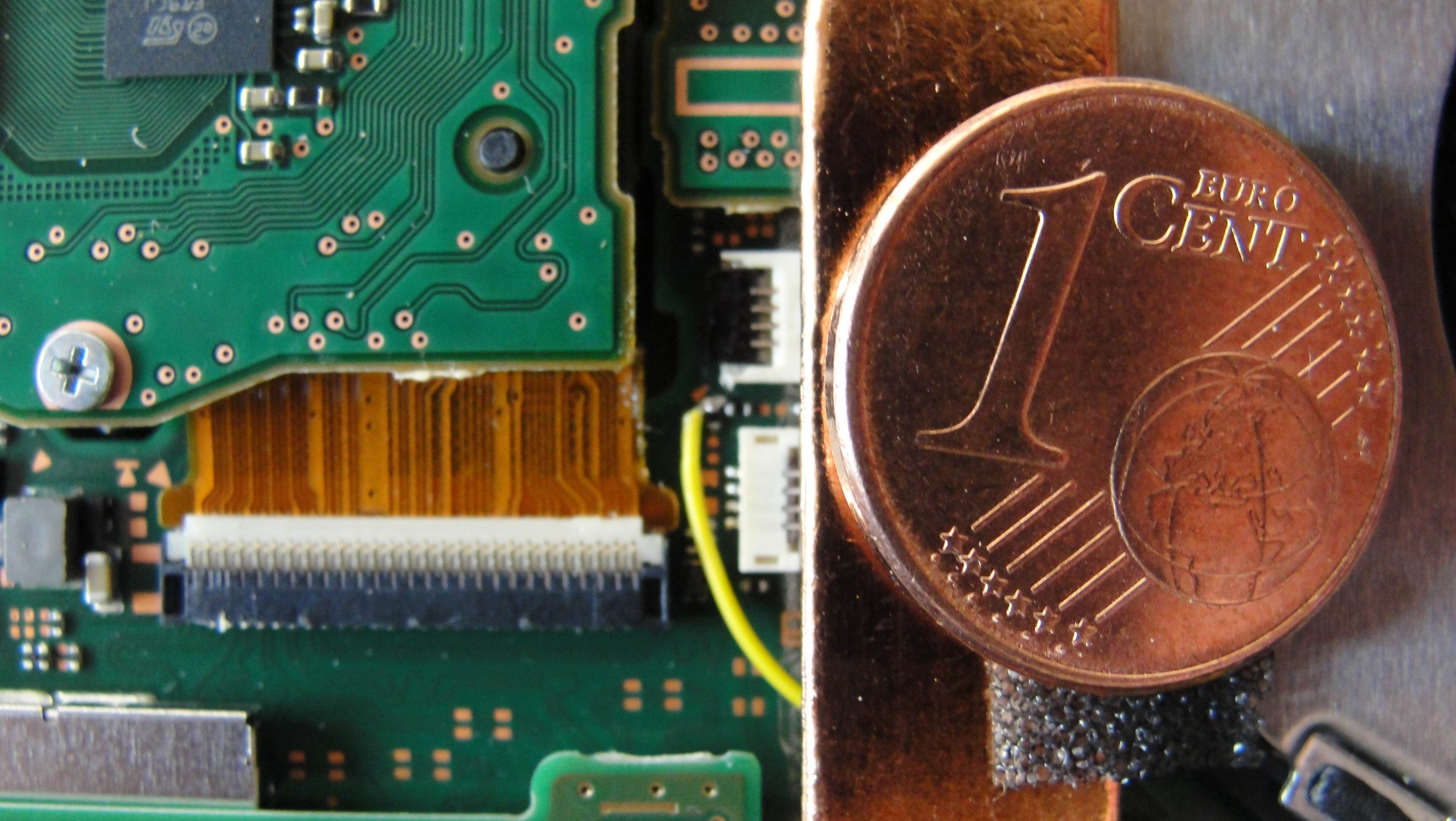

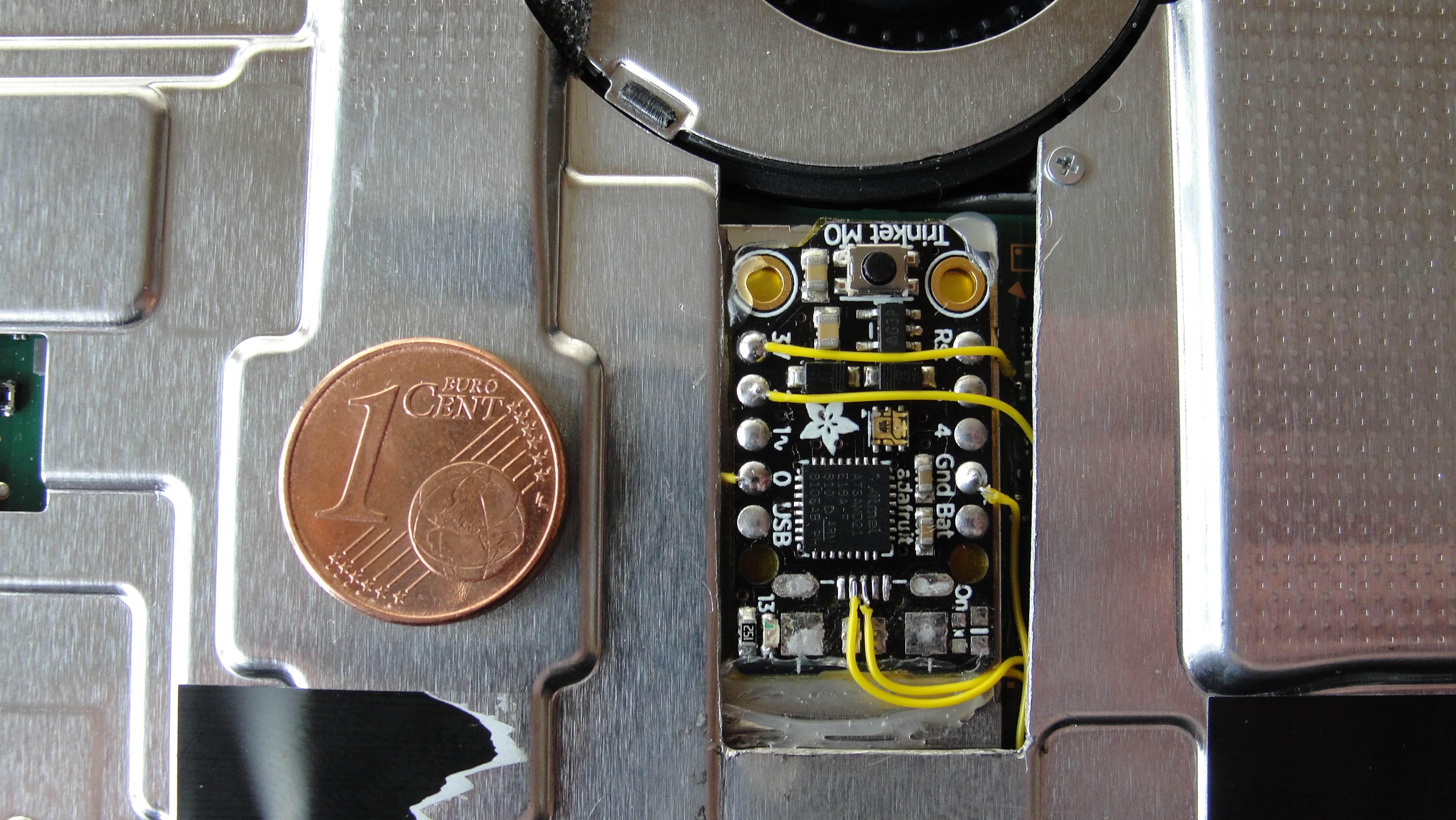

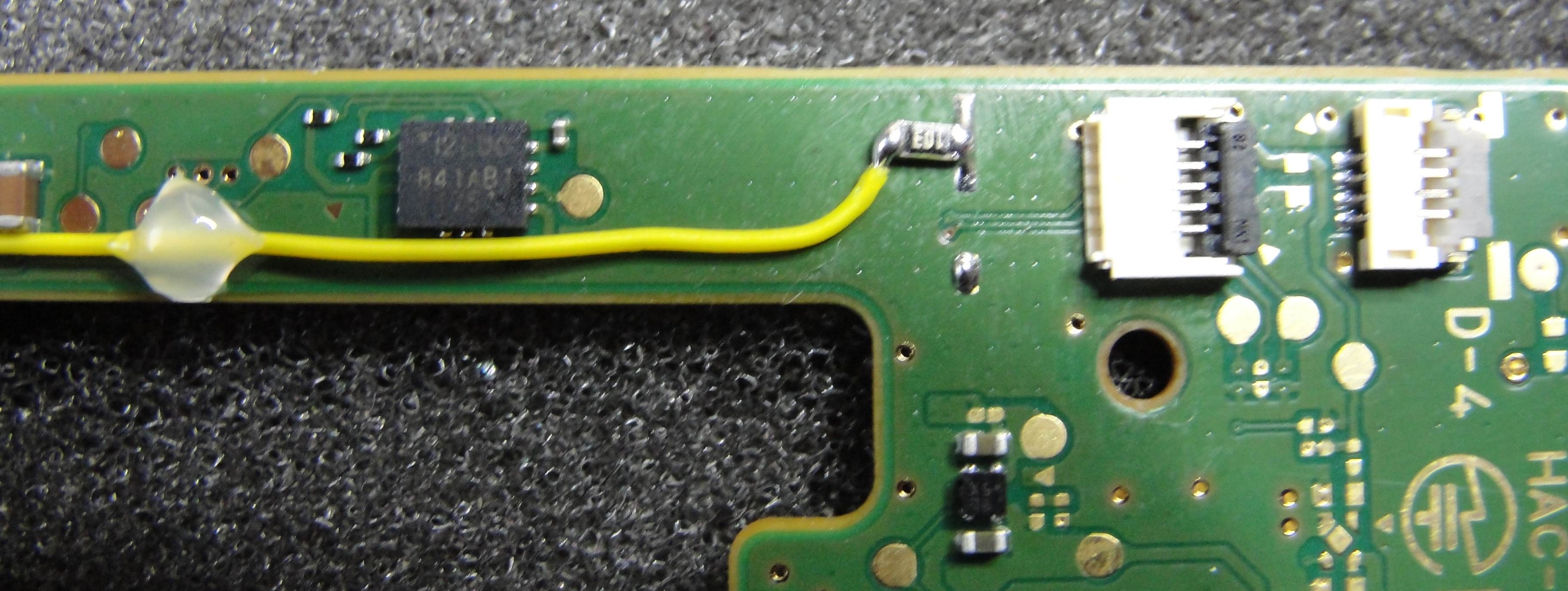

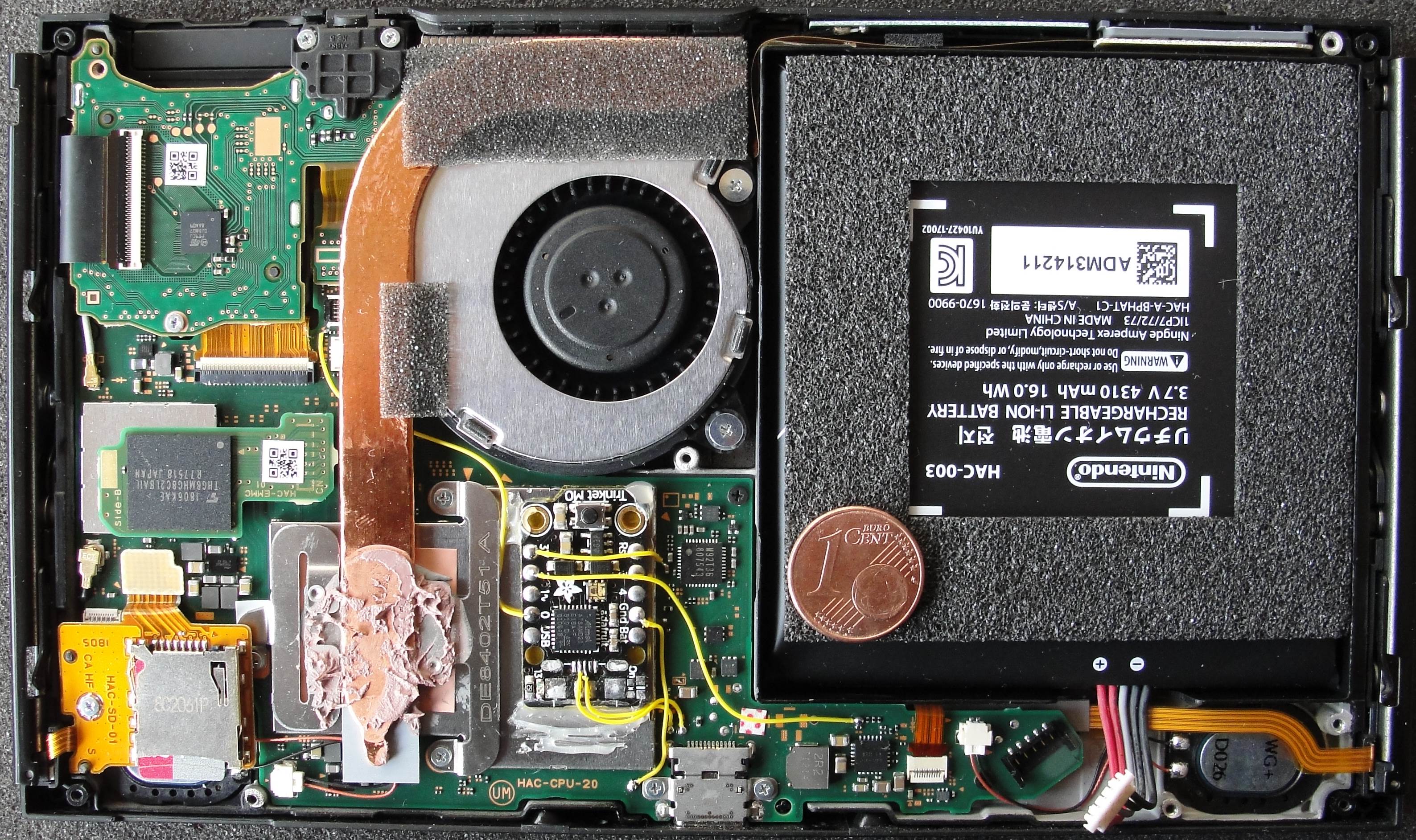

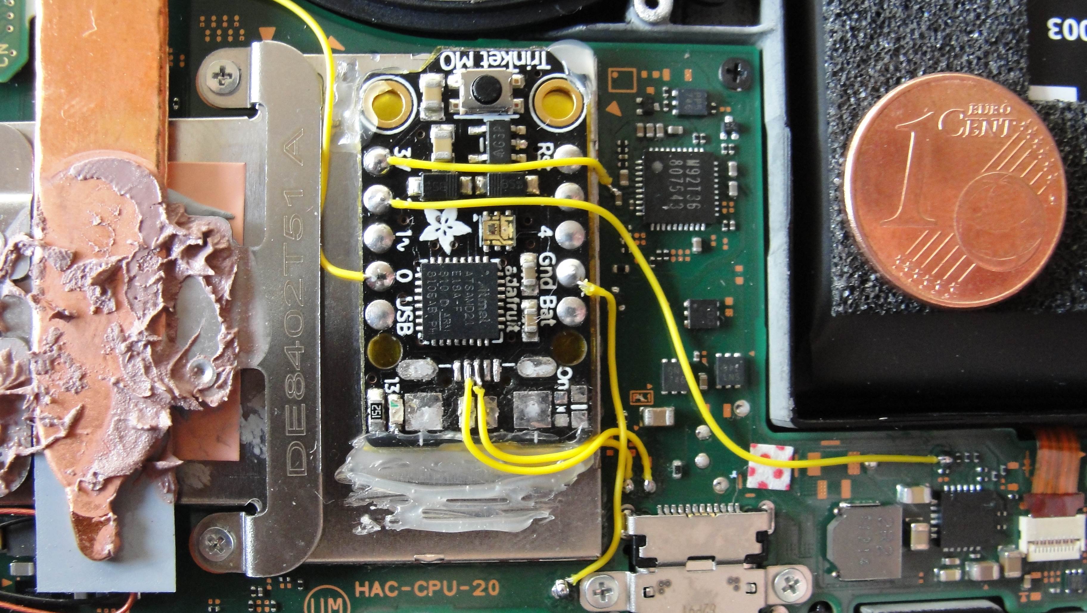

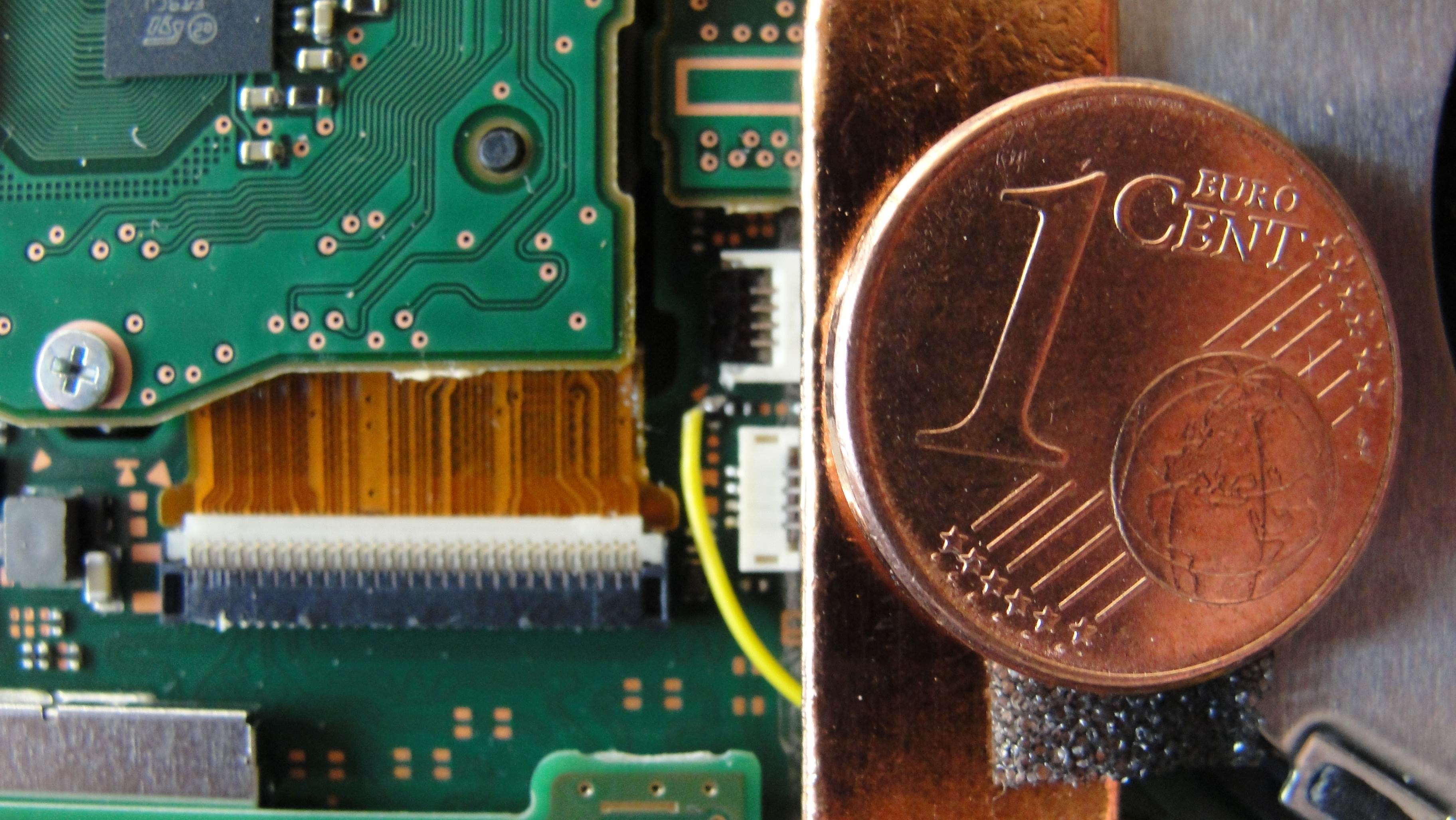

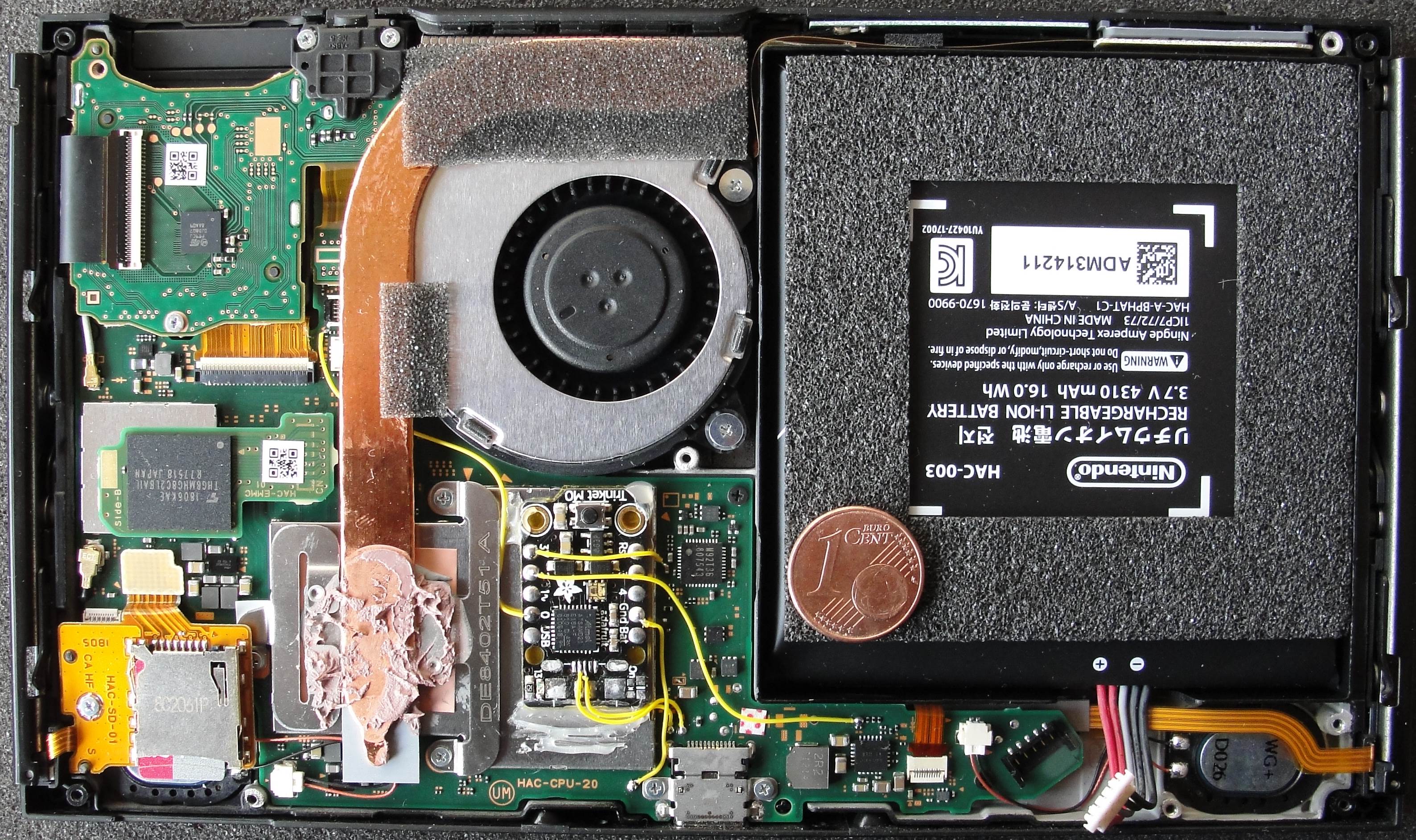

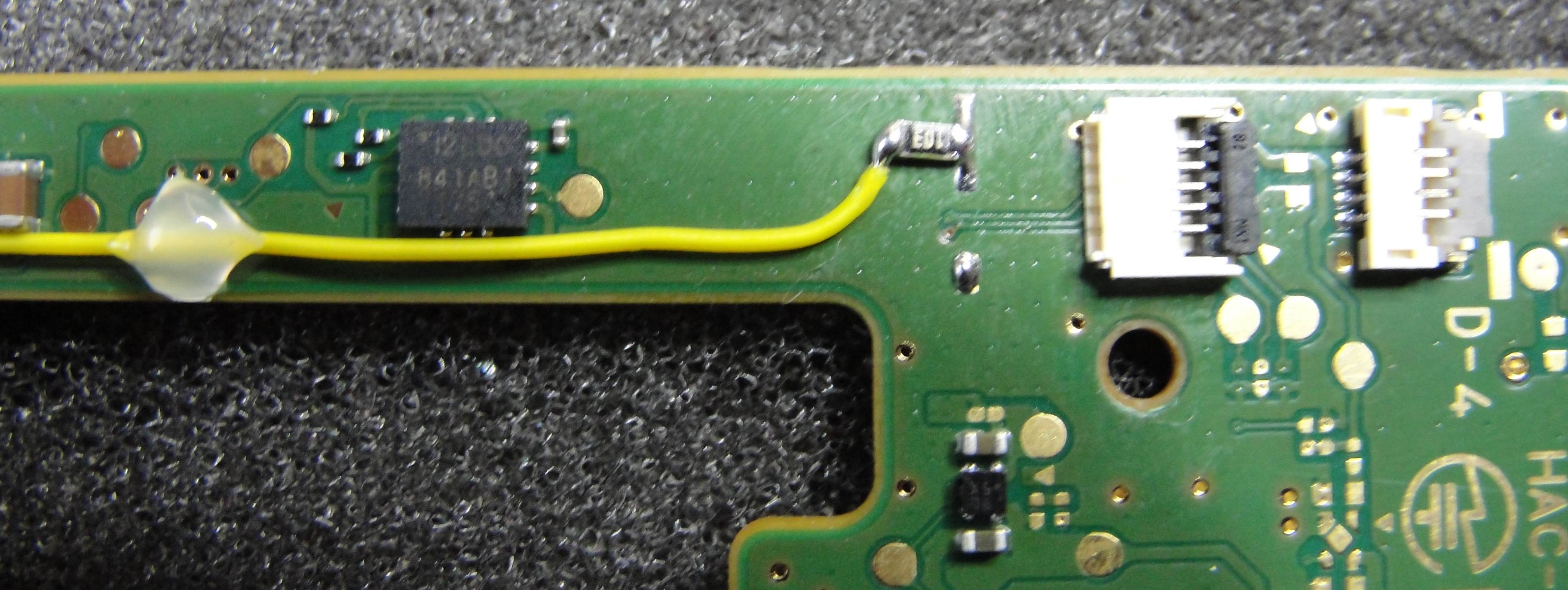

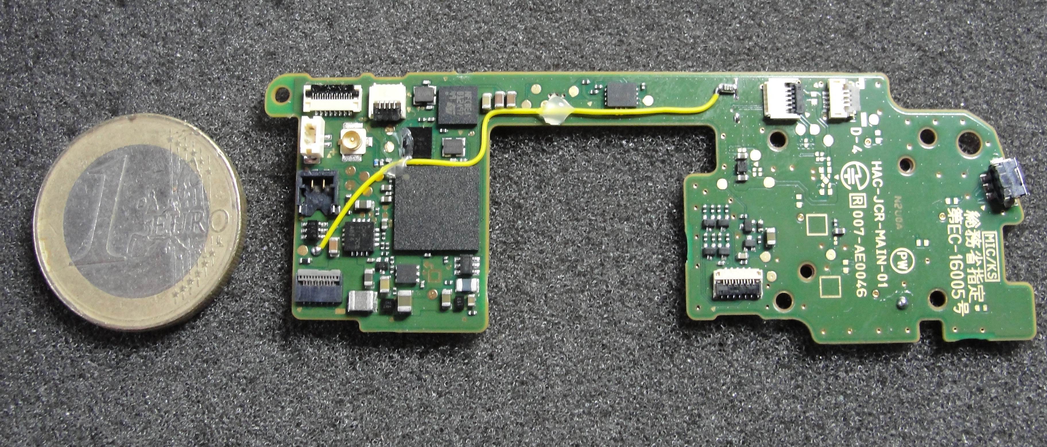

Switch_Right_Joycon_Hardmod_1.JPG Switch_Right_Joycon_Hardmod_2.JPGSwitch_Right_Joycon_Hardmod_3.JPG back_console_shielded.JPG back_console_shielded_ZOOMED.JPG back_console_unshielded.JPG back_console_unshielded_ZOOMED.JPG VOL+_Strap.JPG

Nice job that Dougie looking on a phone screen.
You need some kapton tape covering your solder points up to finish it.
Thank you mate. For once Dougie's not looking on a coffee lol
If you look closer you will see that the Trinket M0 based on Kapton tape to prevent heat and impedance on the long term ;)
Yep. Nice job what I can see. Should serve you for many years :)
THX again but you made the thing and if it could serve for others. I hope it will last for a while but this freaking tact switch nerves me a lot...I have to do something. Either to put some glue tape over it to make it upper or replace it with a taller one.

When you press reset its normal that the volume goes up one step in horizon. Thats because switchboot is holiding the volume strap down for a short period of time.
Does you also see tge right joycon icon when pressing reset? (right joycon must be connected).
If not, your joycon/rcm strap is not correct.
Ill think that's the issue because thats why you didnt get into rcm mode.

Had a chance to test this. I am not getting the Joycon disconnect when hitting the reset. Looks like I have a problem with that strap. I’ll open it back up and see what happened. Thanks for the tip.
OK... Let us take a look at your install.
You have a point incorrect or poorly soldered.
As @popy says, reset button making the volume go up is absolutely normal. It has to be. That is how the chip works. When your joycon is plugged in, it should show you a disconnected graphic too at the same time.
If you don`t see these things, you have a soldering problem.
The battery sems to be draining faster? Shouldn`t be. Quiesient current draw is absolutely tiny.
Please post a photo of your install ideally in the modchip thread.
Really this is the wrong thread. I`d encourage you to post a pic in that one because this is just software and not a hardware problem.
