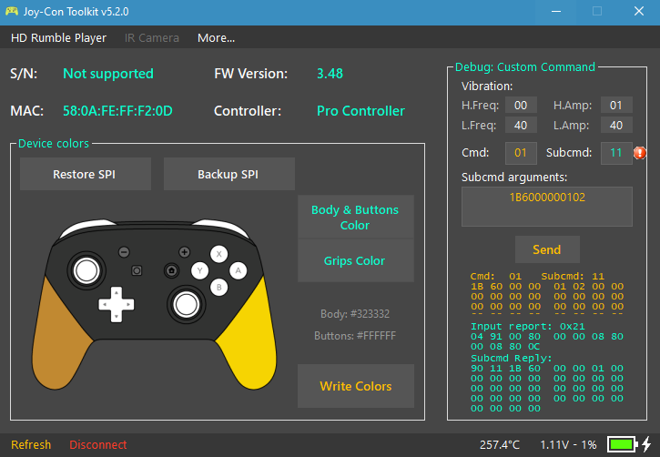

It does not work for me.....
I am using the clone procontroller. I managed to change the button colors.... but now I cant change anything
