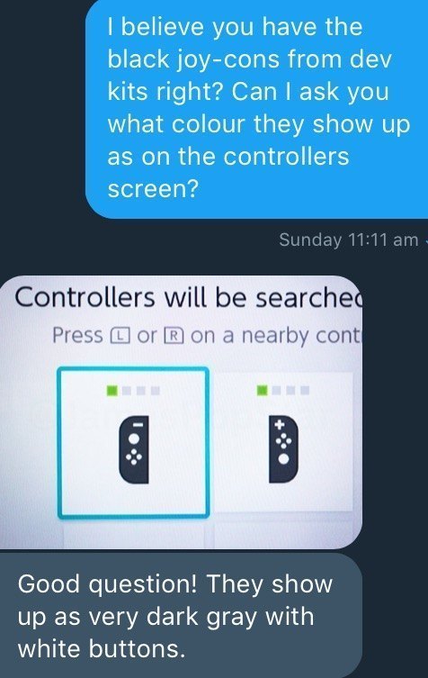

View attachment 108694 I asked a game dev on twitter what the colours are for the dev-kit exclusive black joy cons, they're just the pro controller colours.
I don't know if you wanna add these to custom colours or not but it is technically a stock colour.
Hmm, I expected them to not have color info and look like a grey #555555, but these look darker indeed.
I will consider it. I'll need to create a new color dialog first. The windows default is crap..
