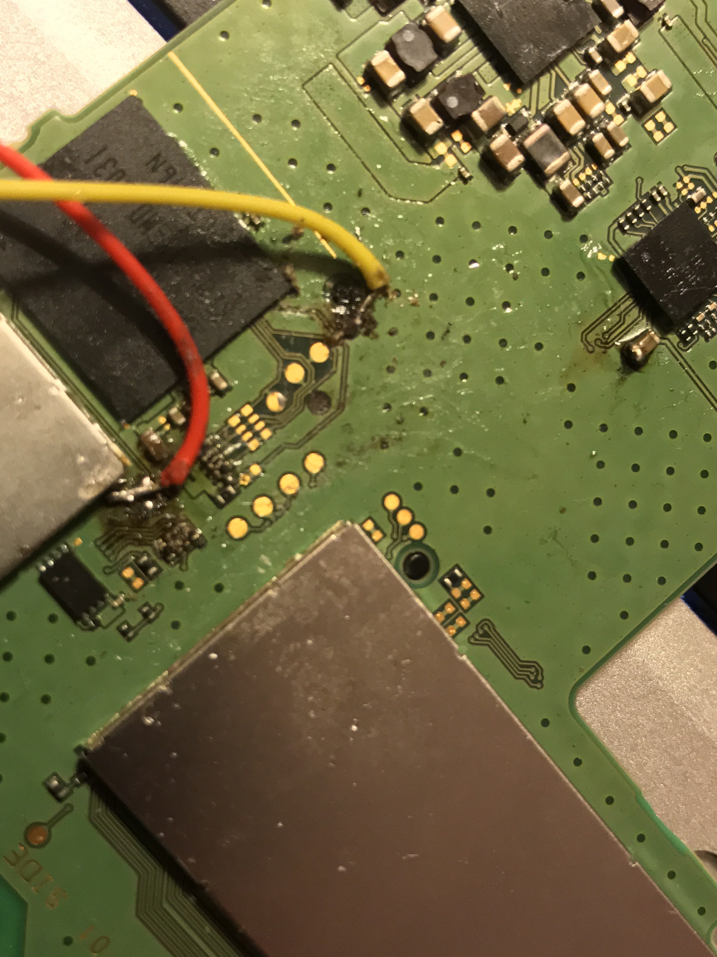

Hey guys, lately I've seen a lot of mishaps with people trying to hardmod their consoles and having issues that end up completely destroying their console. So, as someone who has had a lot of experience soldering and has done a few successful hardmods on the hardest console to do it on, I figured I'd pass some info on in hopes that we can reduce the number of fried motherboards

First and foremost, wire size. I can't tell you how many people I've had to help because they used giant wire and broke pads off. Why does it break pads off? Well the thicker wire has a lot more leverage on the small pads, so any flexing can cause pads to break off, this is why the materials list specifies the smaller wire, it's more likely to give and has a lot less leverage
Soldering techniques, too often I see and hear people who have splashed solder everywhere. I have a hard time understanding how in the world they do that, I mean you'd have to melt the solder over the board with a torch or something to do that usually... anyways, before I go off on a rant.... I bring this up because it can destroy components and can also be hard to remove later, and usually the way it happens has to do with the modder adding way too much solder onto the iron and not cleaning it off, most soldering stations come with a sponge or a brass wool cleaner, use it for christ's sake! Along with that, I see many people having a hard time soldering to the surface mount pads on the 3DS motherboard. If you do it right it's fairly easy to do, simply heat the pad with your soldering iron and put solder on the pad, without touching the solder to the iron, strip the wire you're using back and do the same thing to add solder to that too, then simply heat the solder on the pad until it melts and add the wire to it, the solder should melt together and you now have a properly soldered wire
