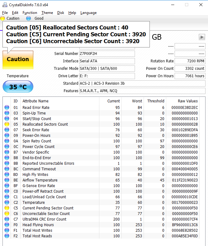

Error code 160-471 seems to indicate data corruption within your Wii U storage device. Simply sayed it seems to die, try a another drive. And the WiiU uses its own Filesystem so there is no recovery option available, only checking the s.m.a.r.t value by "chrystal disk info" if possible.
I think the drive may be the problem since a couple hours after using the front ports it gave the same error message. Does that mean that all the ports are dead or is it just the drive.

The only way is to take HDD out the case or not and run manufacturer's software to check for errors. This is the only way, windows scandisk will not tell anything about hardware failure in some cases. After this anyway your drive might take too much current, use Y cable or change the drive for something compatible. SSD might work well, should take less power in general.
Windows checkdisk is for correcting filesystem errors and sector condition check.
The inbuild s.m.a.r.t technolgy in drives, which gives a overview by a lot of sensors gives good condition overview including hardware defects. A study in 2006 by google says, 64% of all failures with S.M.A.R.T. are predictable.
I had a case that SMART didn't show anything on MAxtor HDD, scandisk neither, but producer's diagnostics did. Usually SMART should show, usually
