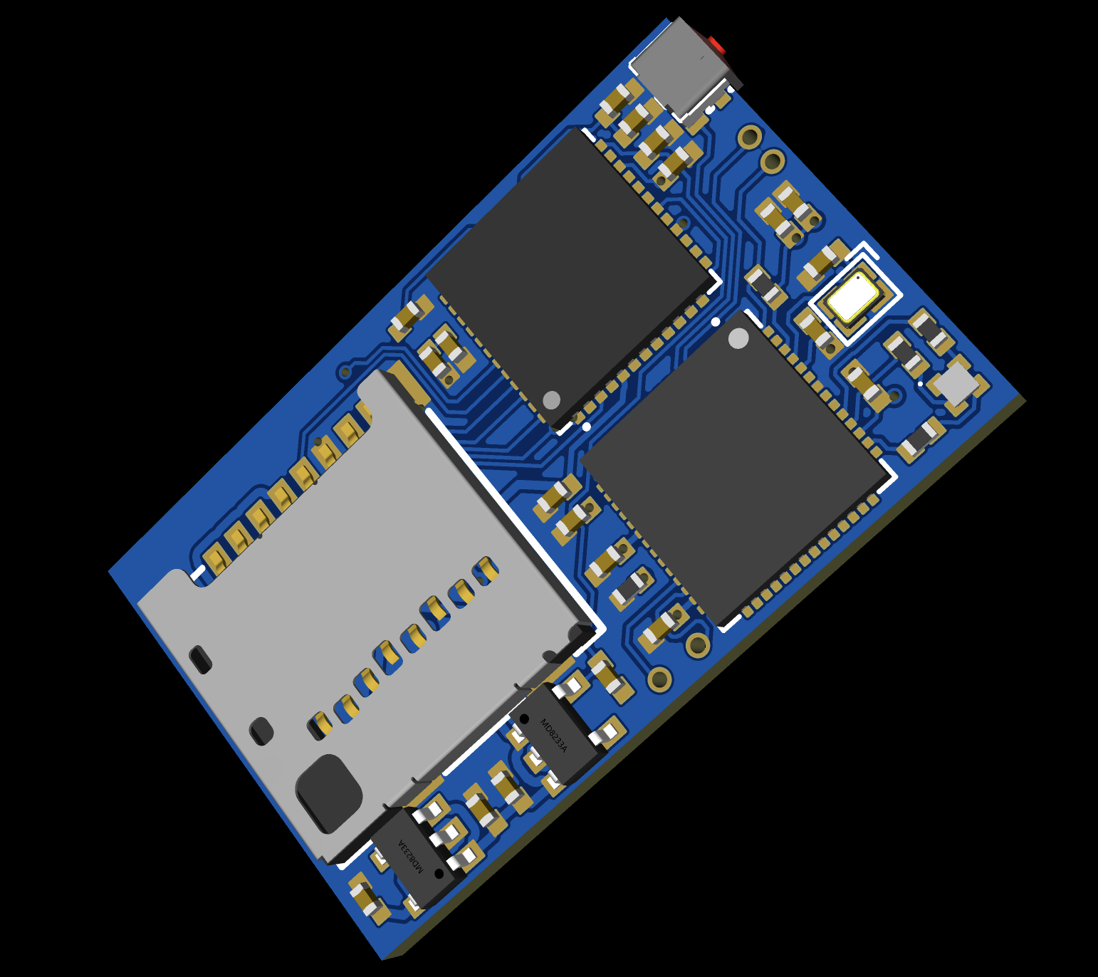

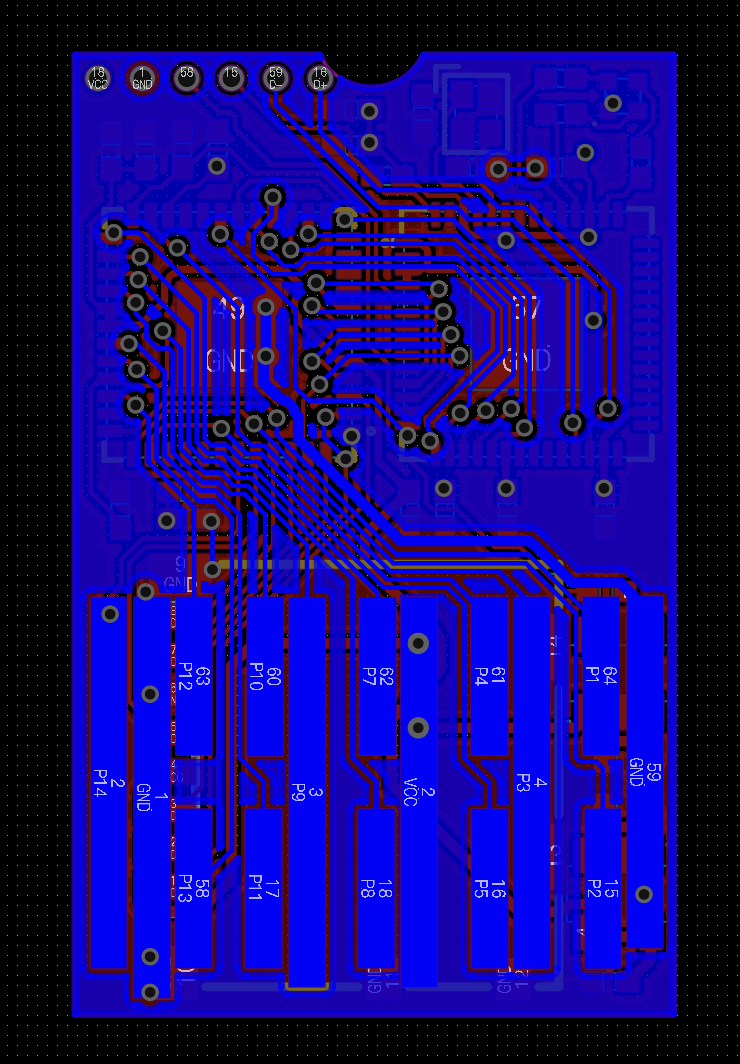

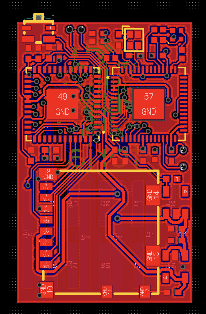

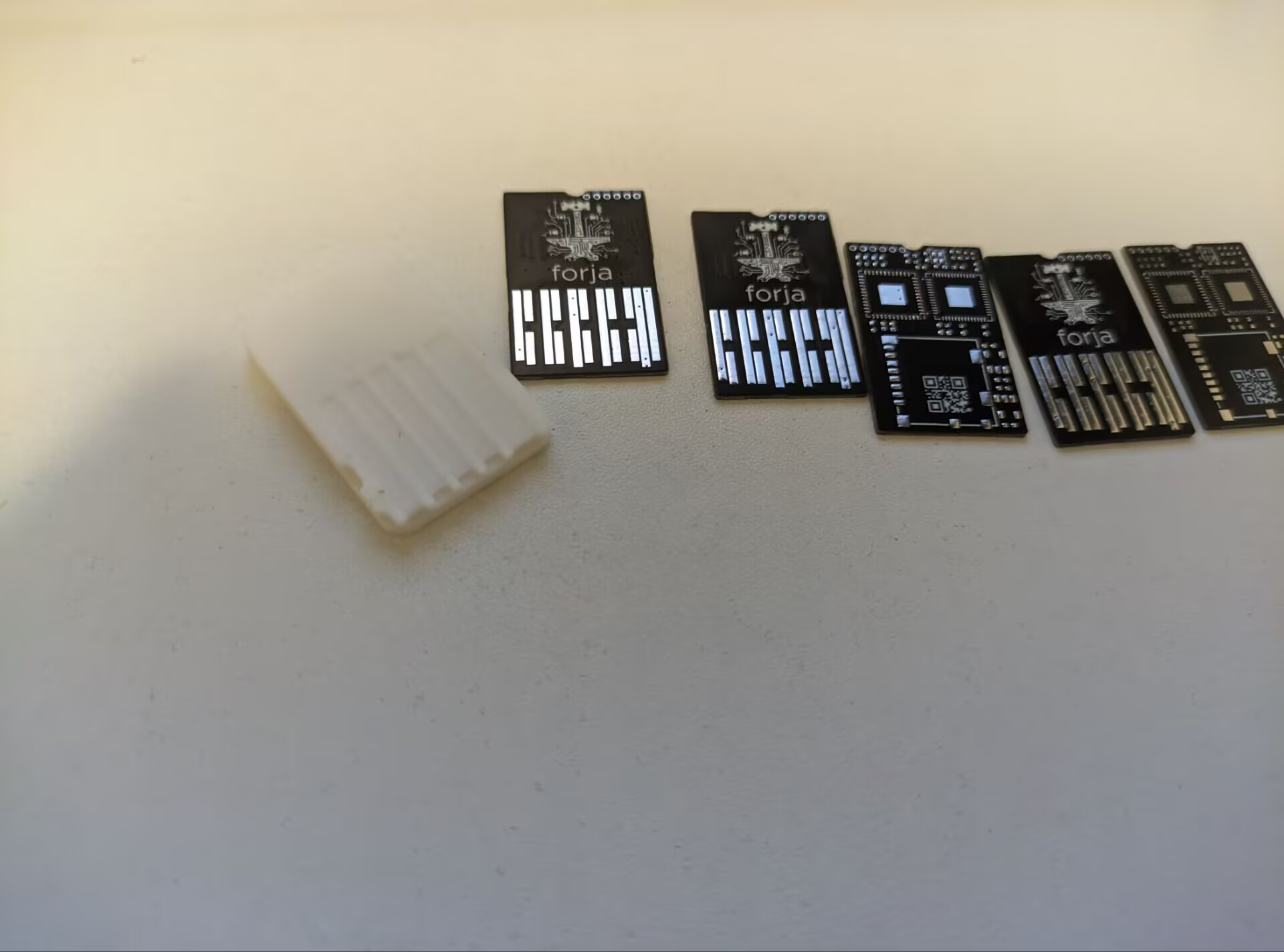

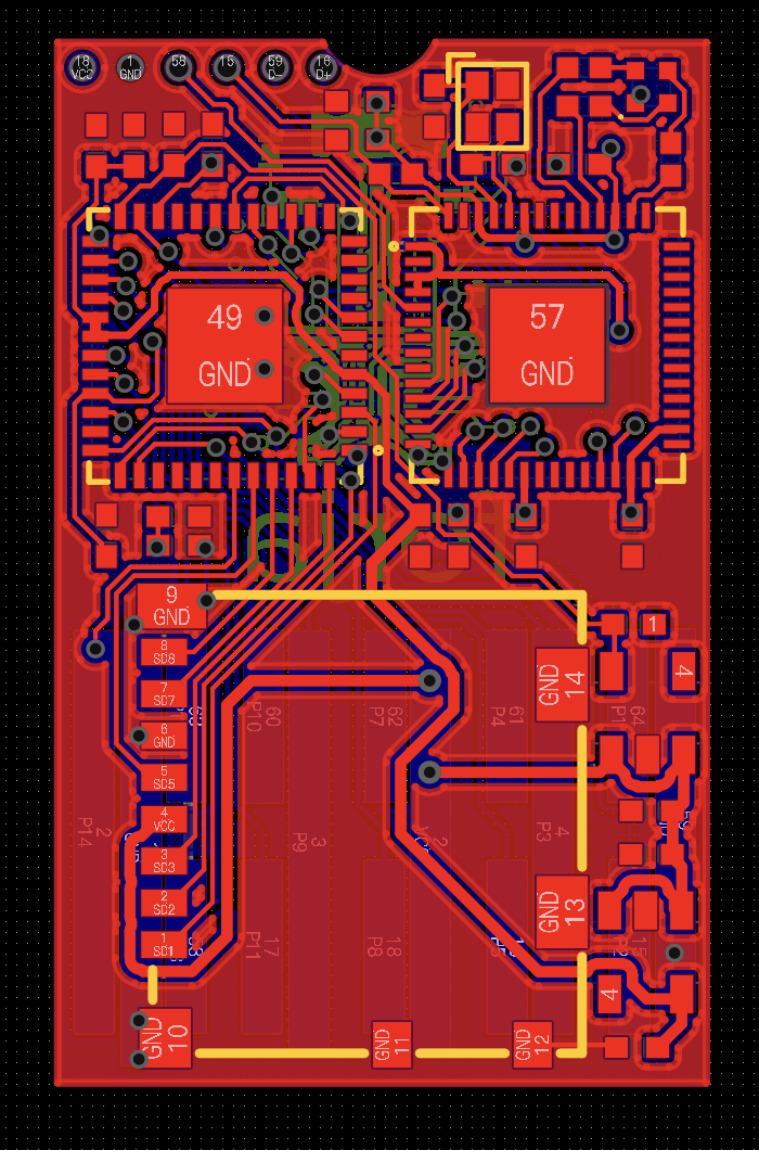

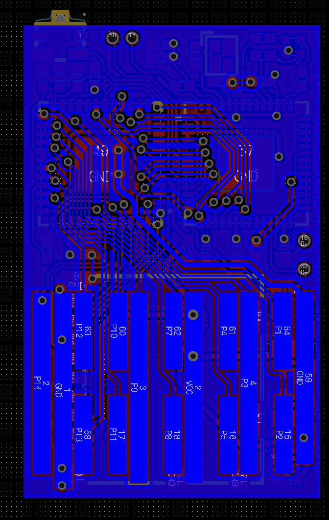

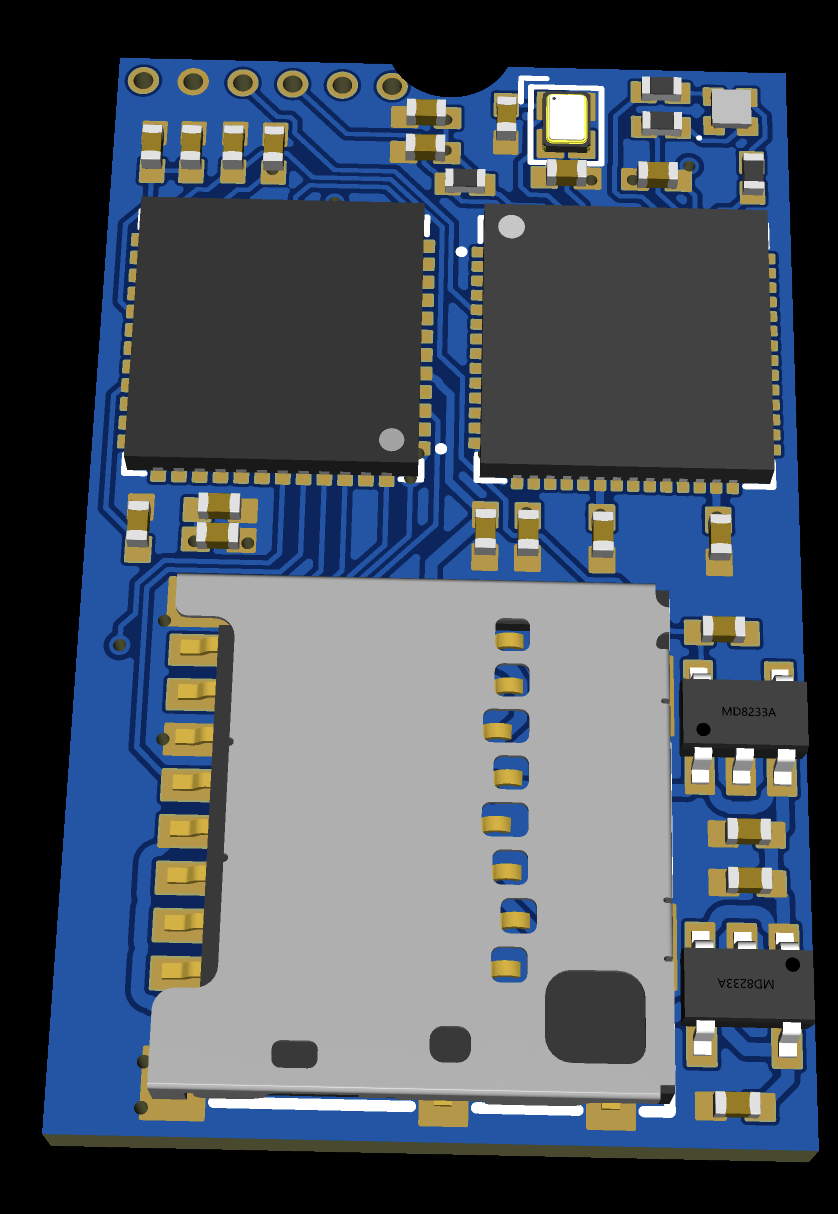

Hello everyone,
I've been spending some time recently doing a deep dive into the M1gSwitch hardware, and I took a few hours to measure and completely redraw the PCB. After I finished, I discovered that another member of the community had already done the same work, haha.
But since the project is complete, I wanted to share my version and my thoughts on what could be done next.
1. My Replicated PCB Design
My goal was to create a low-cost version, so the design is based on JLC's free prototyping service, using 0402 components to match the original's form factor.
  • I've created two versions of the board: one minimalist version without a physical button, and a second version that includes one for switching games.
  • I also designed a 3D-printable shell to house the board and protect it.
2. Theory on the FPGA Firmware
I haven't been able to find any public firmware dumps for the FPGA. However, after analyzing the connections between the ESP32 and the FPGA, I saw that the layout perfectly matches the standard for an FPGA's slave configuration mode.
Combined with the fact that the MigSwitch team has released firmware updates, this leads me to a theory: The FPGA chip likely arrives blank from the factory. On each power-up, the ESP32 is responsible for loading the firmware directly onto the FPGA.
To test this theory, I've ordered new, blank FPGA chips of the same model. There's a slight shipping delay, but I will post an update here as soon as they arrive and I've had a chance to test them.

Hello everyone,
View attachment 525921View attachment 525922View attachment 525924View attachment 525926View attachment 525927View attachment 525928

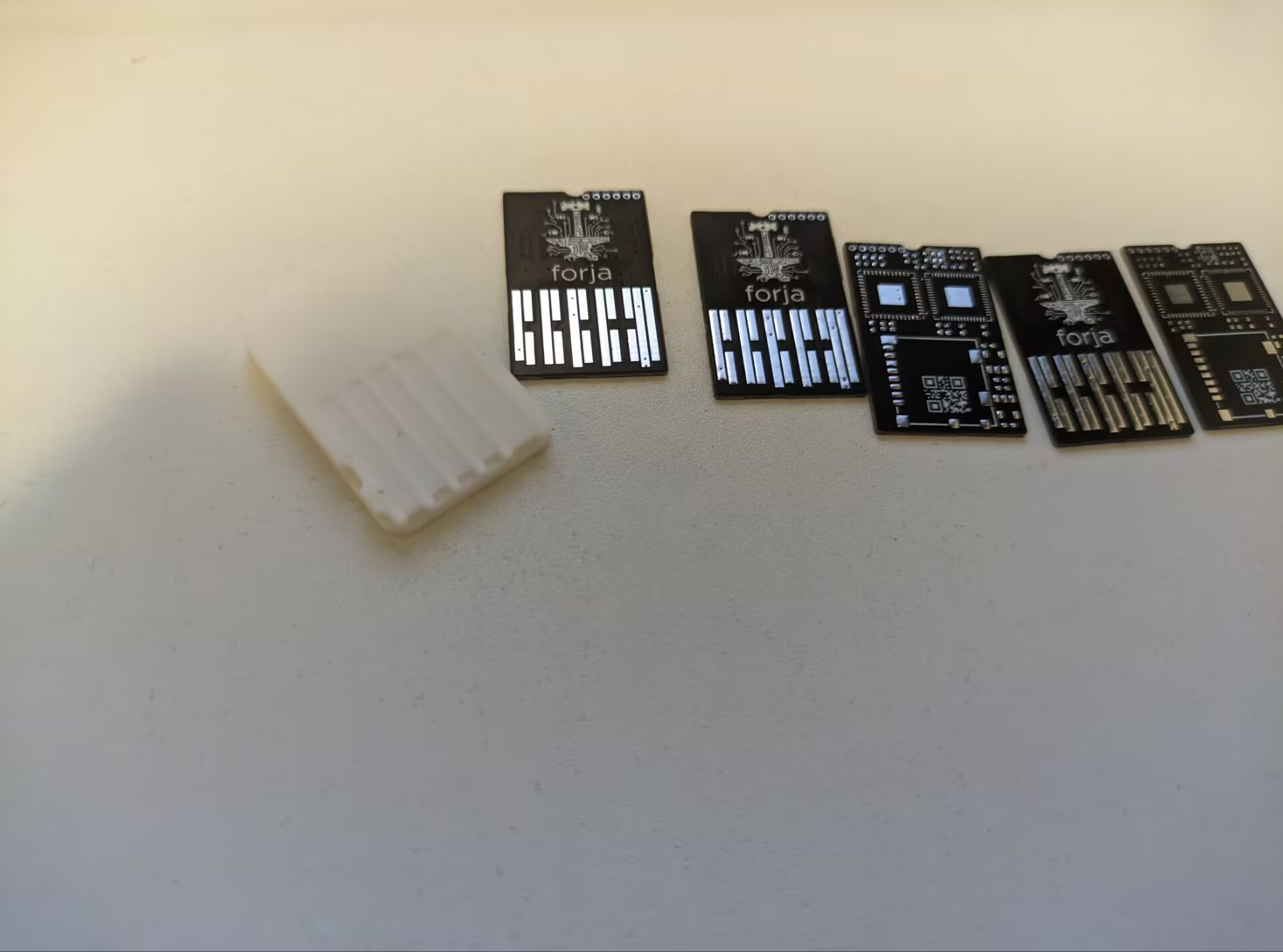

are you willing to share the current files you have with the community?
Of course!
Good timing, actually. The first batch of PCBs just arrived today. My plan is to assemble one and test it thoroughly over the next few days to make sure there are no issues with the design.
Once I can confirm that everything is working as expected, I'll upload all the files (Gerbers, PCB project files, 3D shell model, etc.) for everyone. If I run into any problems during testing, I'll make the necessary revisions before releasing them.
On a side note, the turnaround time for the PCBs was impressive. I finished the design on the evening of the 2nd, and they were delivered by noon today (the 4th). It was incredibly fast, and best of all, the boards and the shipping were completely free.

I’m curious to see how you designed the shell to actually attach together and still be easily printable
See if you took a different approach. I took all of my replacement files down after people where selling them on Etsy
  • Wow
Reactions: impeeza
thats a shame :( i m sure it would be useful to others.
Hello everyone,

Amazing work! I'm sorry you had to redesign the board from scratch though, haha.
You mentioned using JLC's assembly service, is that just for the passives like the capacitors and resistors, or does it also include parts like the RGB LED and microSD slot? I made my BOMs for DigiKey and Mouser, but if LCSC has all of the parts too that would help with distribution choices. Also, do you intend on working on the Dumper board in any capacity?
As far as the blank FPGA, I tried a few boards with MIG ESP32 and blank FPGA and they did not work, I needed to transplant both chips.
Great work on your project and I'm excited to see your updates!
Thanks for the info. The service I'm using only covers PCB manufacturing, so the component soldering has to be done manually. Discounts for SMT assembly services are rare. For batch production, it's possible to mail the chips to the factory.
My next plan is still to try replacing the FPGA and to analyze the firmware update process and the data exchange between the two chips.
