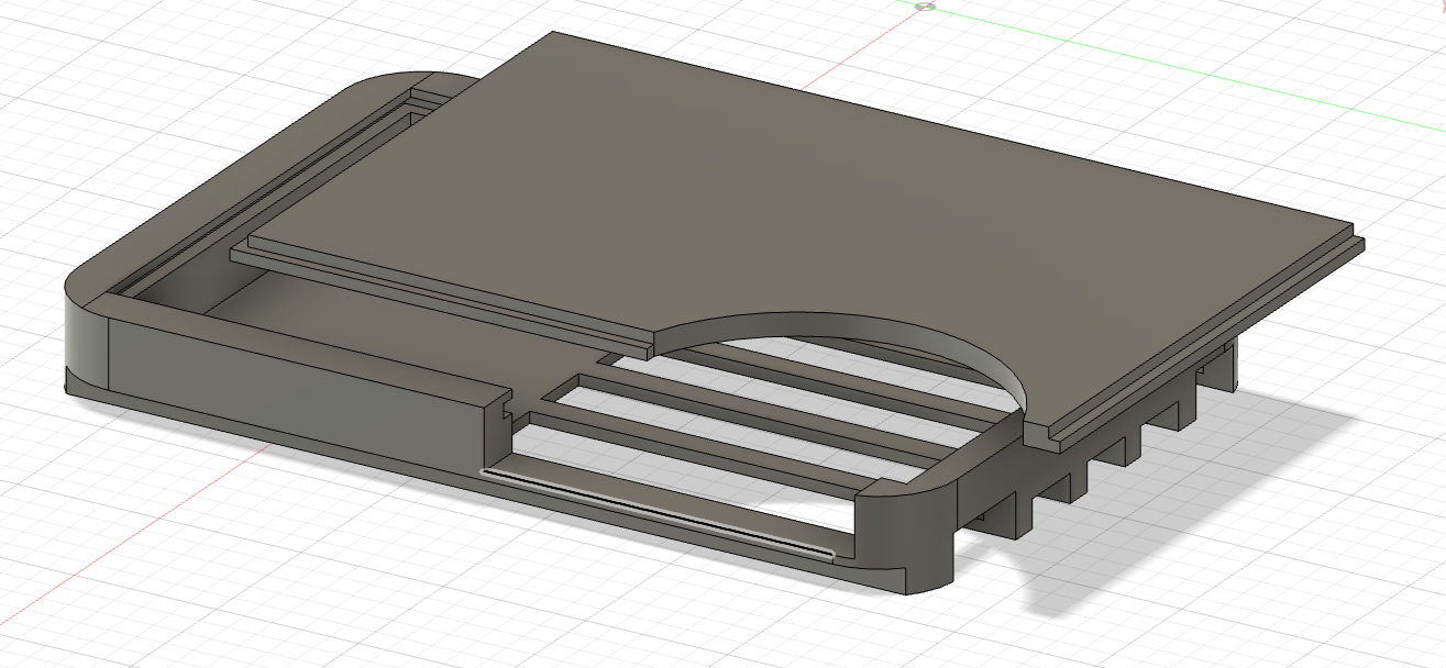

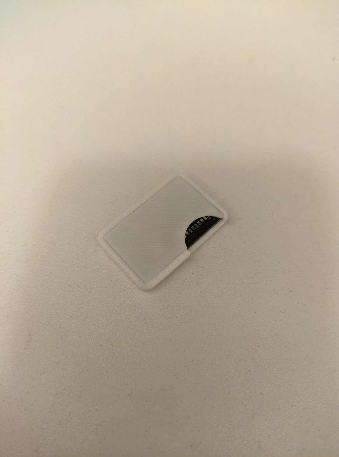

I’m curious to see how you designed the shell to actually attach together and still be easily printable
See if you took a different approach. I took all of my replacement files down after people where selling them on Etsy
thats a shame :( i m sure it would be useful to others.

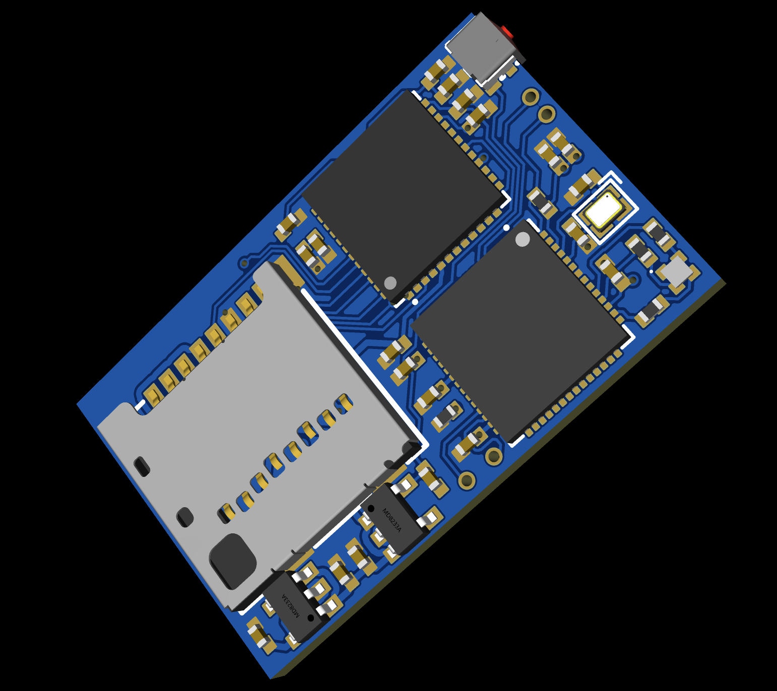

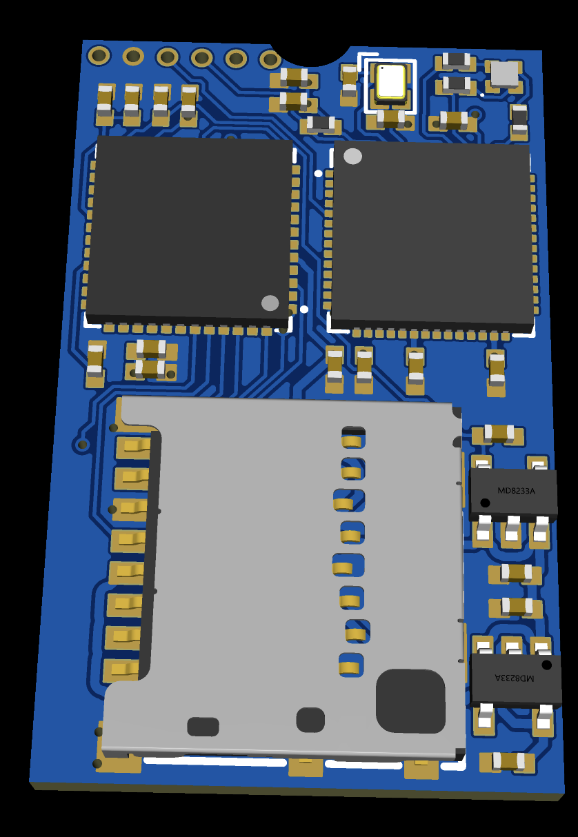

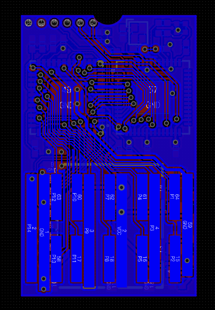

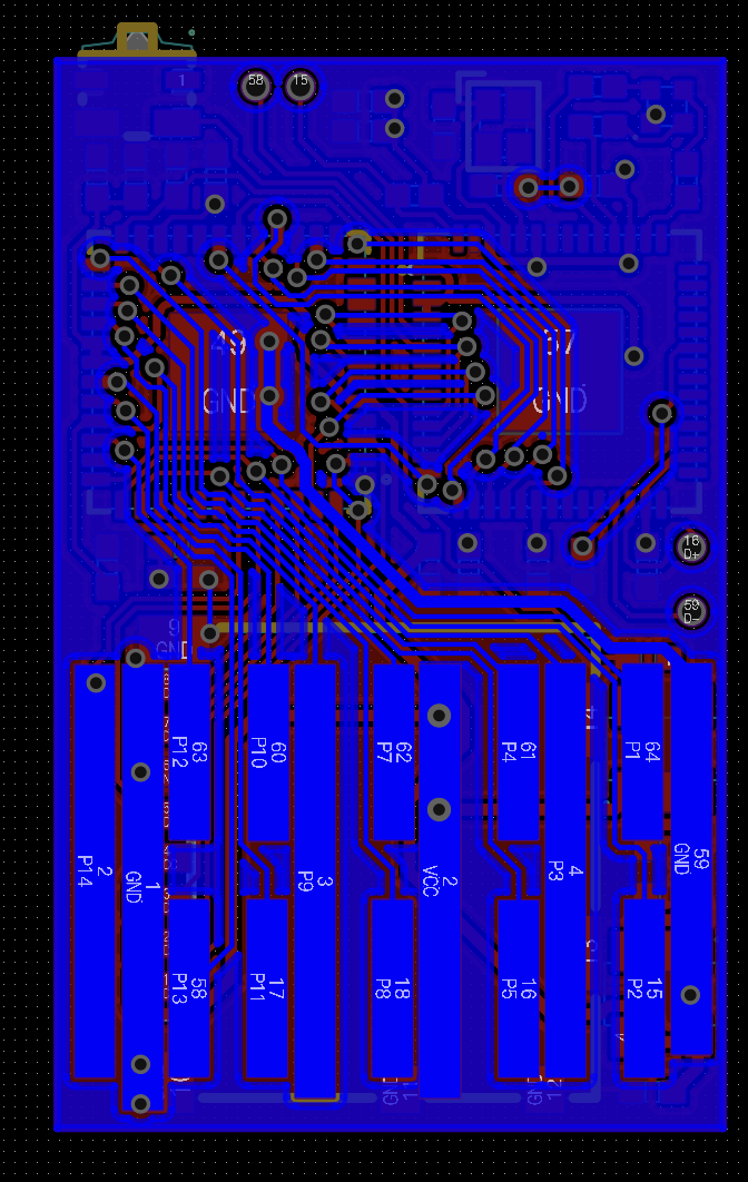

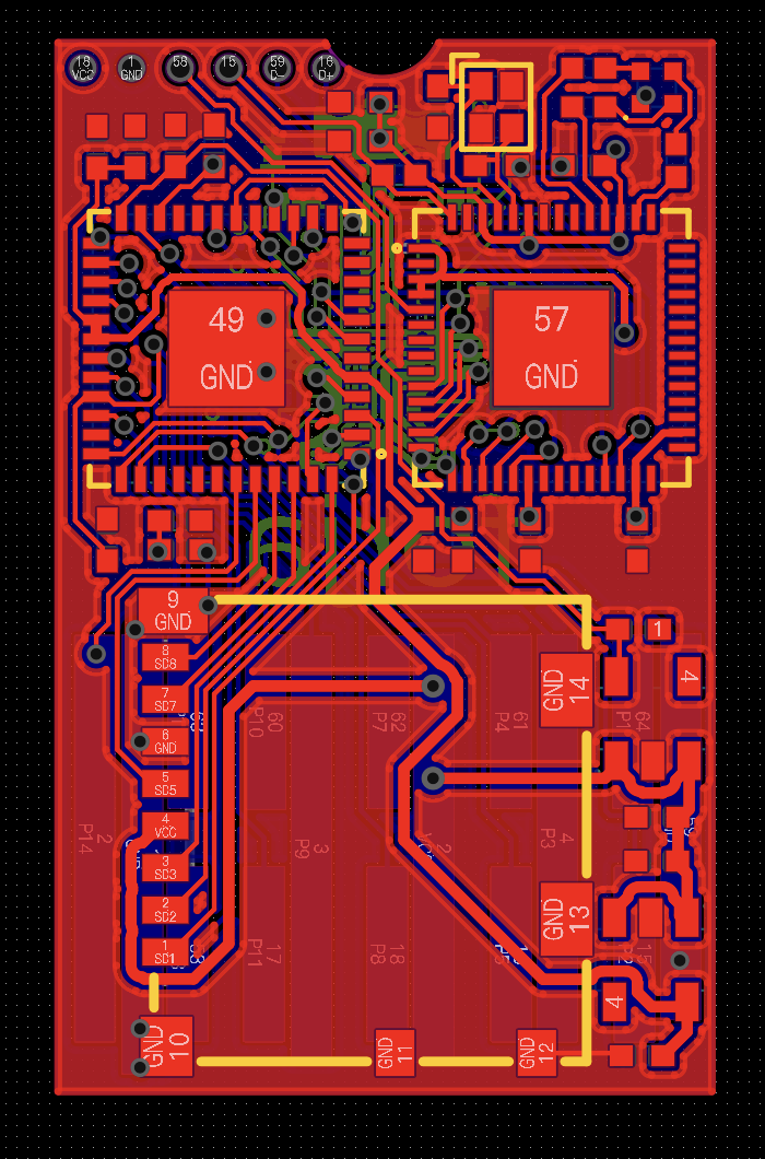

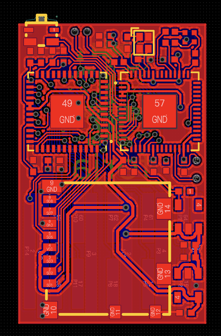

Hello everyone,
I've been spending some time recently doing a deep dive into the M1gSwitch hardware, and I took a few hours to measure and completely redraw the PCB. After I finished, I discovered that another member of the community had already done the same work, haha.
But since the project is complete, I wanted to share my version and my thoughts on what could be done next.
1. My Replicated PCB Design
My goal was to create a low-cost version, so the design is based on JLC's free prototyping service, using 0402 components to match the original's form factor.
  • I've created two versions of the board: one minimalist version without a physical button, and a second version that includes one for switching games.
  • I also designed a 3D-printable shell to house the board and protect it.
View attachment 525921View attachment 525922View attachment 525924View attachment 525926View attachment 525927View attachment 525928

Amazing work! I'm sorry you had to redesign the board from scratch though, haha.
You mentioned using JLC's assembly service, is that just for the passives like the capacitors and resistors, or does it also include parts like the RGB LED and microSD slot? I made my BOMs for DigiKey and Mouser, but if LCSC has all of the parts too that would help with distribution choices. Also, do you intend on working on the Dumper board in any capacity?
As far as the blank FPGA, I tried a few boards with MIG ESP32 and blank FPGA and they did not work, I needed to transplant both chips.
Great work on your project and I'm excited to see your updates!
Reactions: Blythe93

Thanks for the info. The service I'm using only covers PCB manufacturing, so the component soldering has to be done manually. Discounts for SMT assembly services are rare. For batch production, it's possible to mail the chips to the factory.
My next plan is still to try replacing the FPGA and to analyze the firmware update process and the data exchange between the two chips.

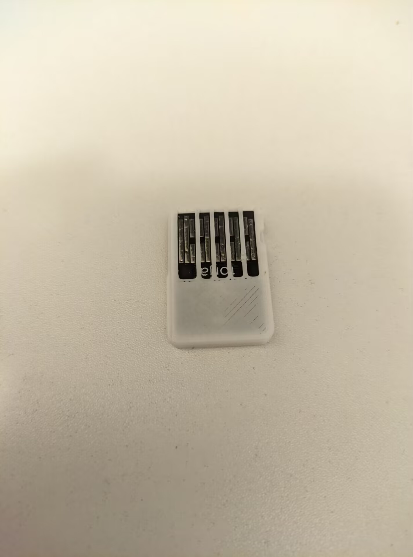

This is a really cool model. Do you have one for the button model too?
Reactions: Blythe93
