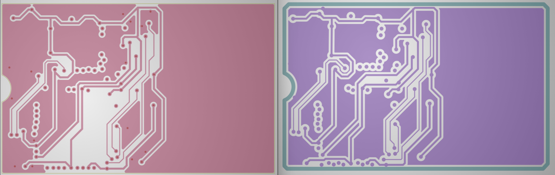

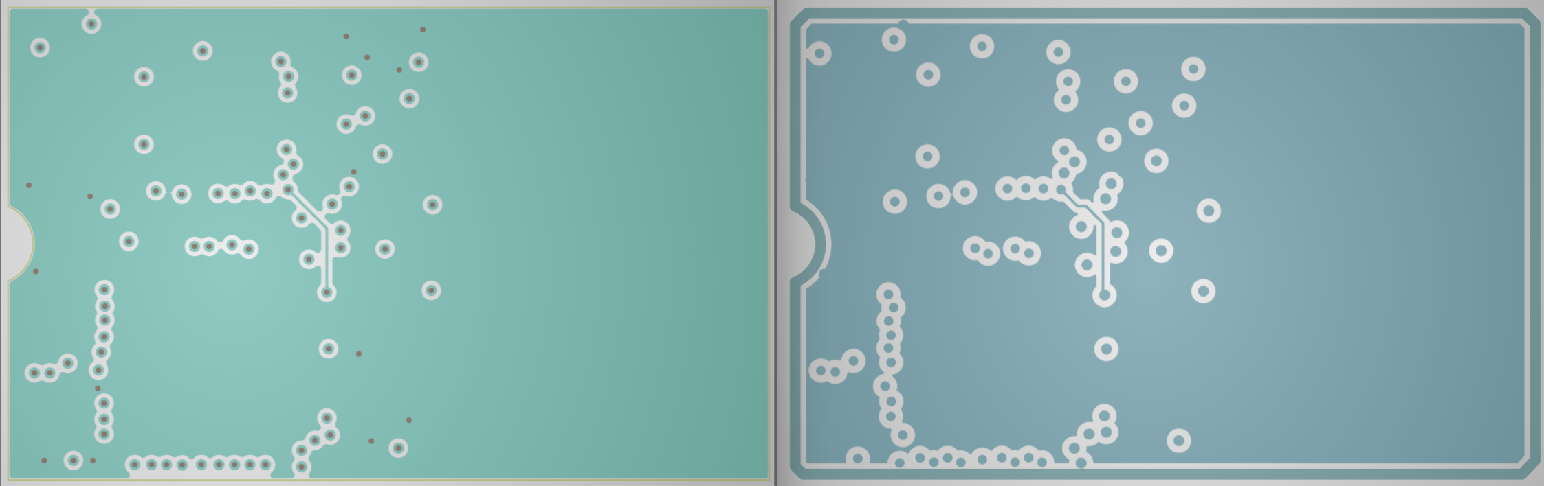

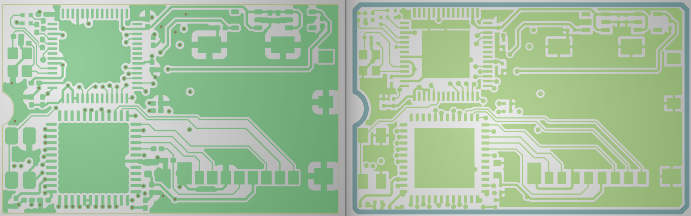

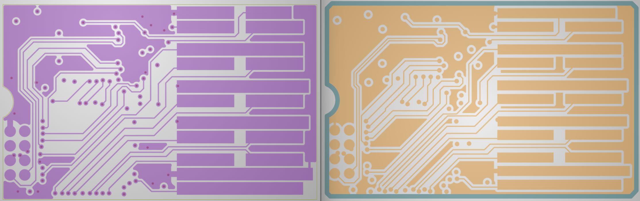

Objectively speaking, the gerbers from OpenMig are actually pretty good. Below is a side-by-side comparison of all 4 layers of the PCB I reverse-engineered on the left and OpenMig's PCB on the right.
The two are very similar, and this was definitely created as a board that they intended on being a proper clone. However, the bottom layer doesn't have pins 1 and 2 separated, so this design will not work with the button as I previously pointed out in post #1698.
Apart from that though, I don't see anything wrong, and I think their board would work either as a V1 clone or a V2 clone if someone cut the two pins like in the V1 to V2 conversion guide that MIG linked to.

This is 100% it. RE'ing the hardware is challenging, but doable. The software, however, likely requires low-level exploits or physically decapping the chip to extract the binaries on it, all of which is much more involved. They cloned the hardware and transplanted the chips, thought that they only had a few weeks/months of work left to clone the software, and then the project ended there.

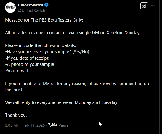

Today they published on X:
https://x.com/UnlockSwitch/status/1892122828381569420
I am really pissed off estoy hasta las pelotas with this guys.

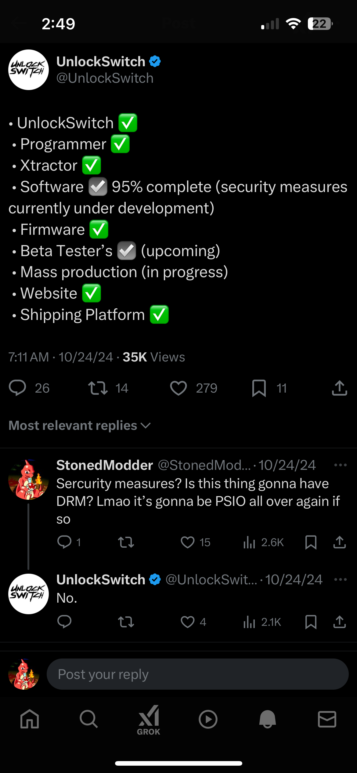

A lot of promises about releasing the software.. but if he release it.. every firmware package have his own unique id for each card. They build in a uid checker..
They need to match (serials on Ic with their software).. otherwise its not working.. (thats what they said).
So its not completely "open" source.. 🦗😂
So I wasn’t completly wrong about “sercurity features”meaning DRM it sounds like
"Open" for their own devices. Every card have his own unique firmware.
So if there came up a clone.. they cannot use their firmware for it🤣
