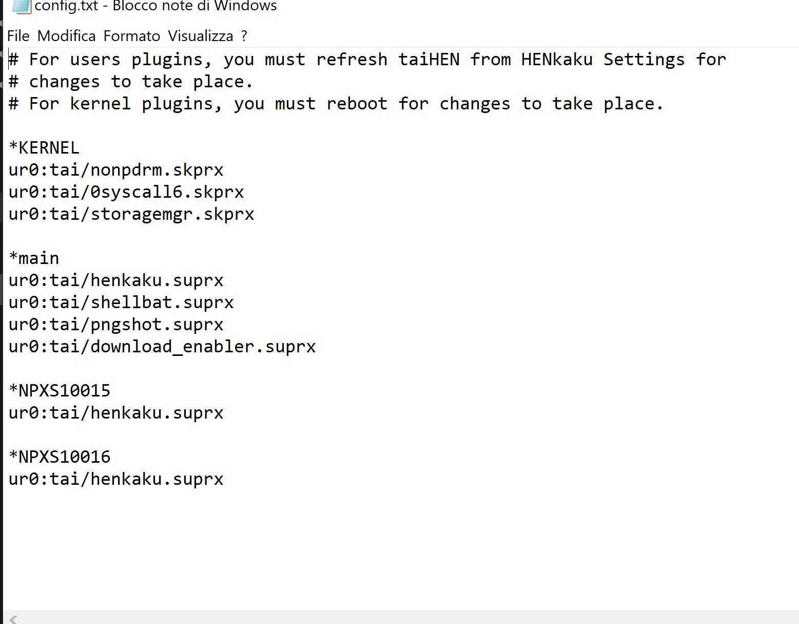

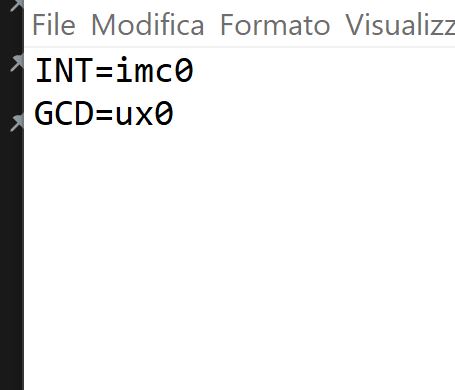

Morning everyone!!!!
First of all thanks for this tutorial:):):):)
I'm a newbie about Vita hack and I've just mod it mine (2000 model) installing Henkaku-enso and works fine.
I've just followed this tutorial and set up like in the image attached:
I'm not using a Sony Memory Card and even UMA.
Now my Vita is pointing Microsd on the ux:o
Is this correct?
May I continue to install homebrew, etc without any issue?
